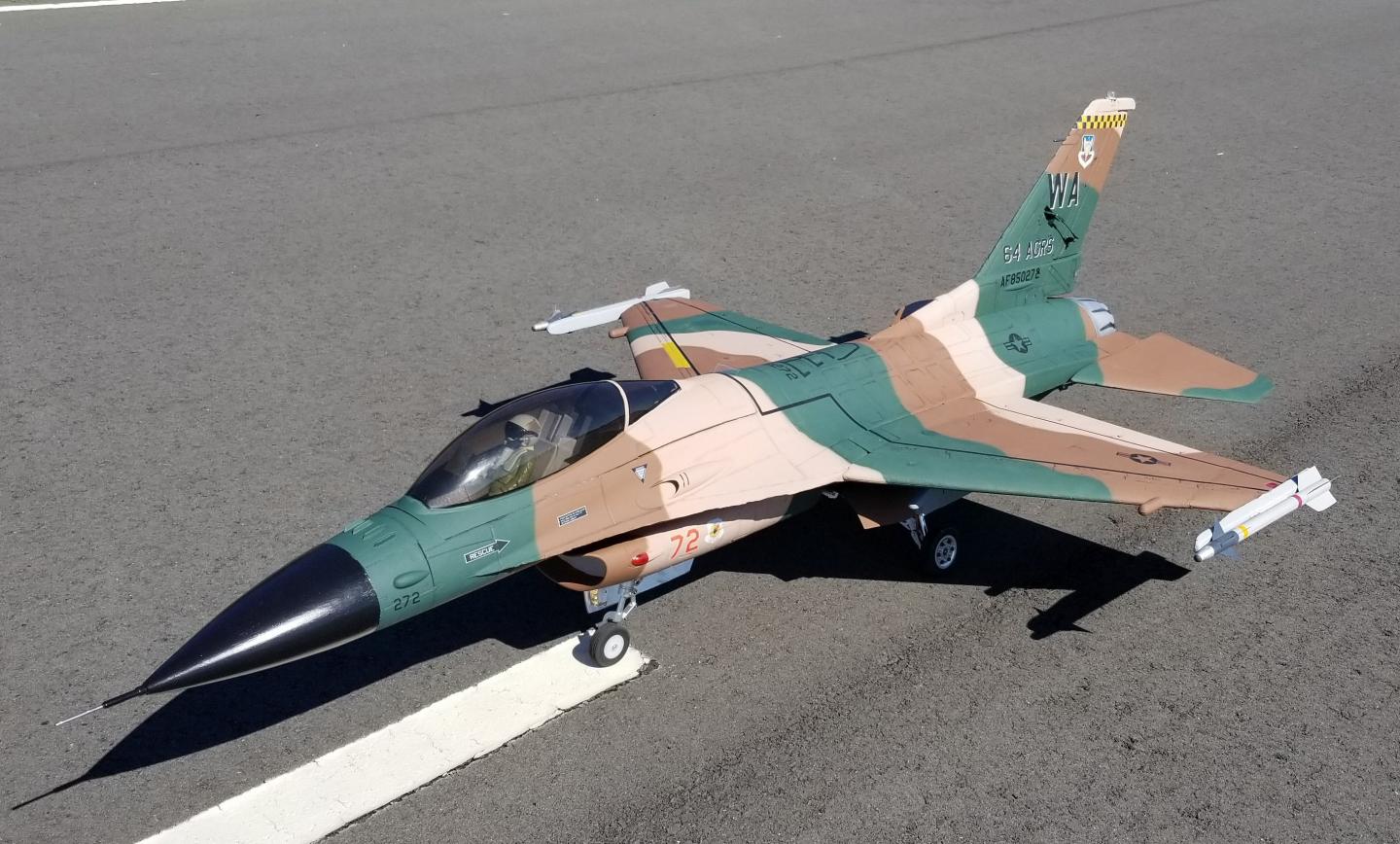

                                    Here is my repaint of my F-16. Decals are from Callie Graphics. This version represents one of the Aggressors based at Nellis AFB, NV. This was originally a 6S setup but it wasn't as peppy as I had hoped. I purchased the 8S version of the F-4 and swapped the power plants. This thing is a blast to fly now as an 8S! I'm happy with the F-4 as a 6S too, so it was a good move in my mind.

                                      That looks top notch! You know how I feel about all your repaints, Vduniec. This is another homerun in my book.
                                      It sounds like you executed the perfect lateral move, too, in swapping the F-16 to 8s and the F-4 to 6s. Those are my optimal setups for these two aircraft given their differences.
