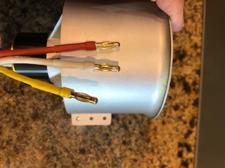

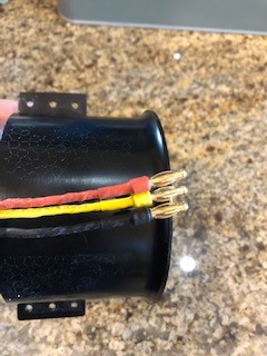

                  Thanks DCORSAIR, I'm pretty much going about it as you describe, I have the fan facing backwards to I can plug the leads in. However when I start to rotate the fan to the correct position is where the problem comes up. It doesn't seem the wires are long enough with the ESC staying within the wooden tray. While the leads to each motor measure the same length, the leads on the original motor (the black housing) seem to wrap around easier than the upgrade motor (the silver housing). Right now, the only way I can get the connectors to stay plugged in is to move the ESC back almost a full inch, but then I can't fasten it down in the tray. It's starting to look like my only option is to cut the back of the wooden tray and remove some foam so the ESC fits flush again. That would allow me to swing the wooden cross piece back in place to hold the ESC. It won't be in the middle any longer, but only on the front 1/3. It should be enough to hold though.
                  I'm attaching pics so you can see the difference between the wiring of the 2 motors as they're folded back and the position of the ESC when the motor is aligned with the mounting holes.

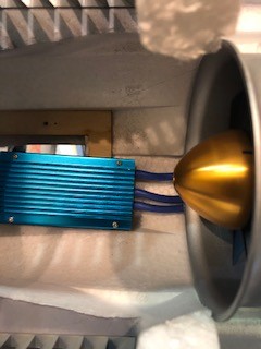

                      The joy continues. I decided to cut the wood tray at the back end and remove a little foam so the ESC would fit flush. Have everything hooked up and the new EDF temporarly in. Bound my receiver to make sure the EDF was blowing in the right direction before I buttoned everything up. Didn't want to have to pull eveyrthing apart to swap a couple of the leads from the EDF. After binding, I'm getting a rapid beeping from the ESC. Now to see if I can find what that error code is. sigh. :weary:

                        That is strange that yours did no fit right, I just went out and looked at mine to make sure I didn't modify my ESC tray, I didn't have to do any cutting on it, but I do remember I did have to bend my wires coming out from the motor a little more to get a little more length out of them, and removing some of the foam where the wires come out of the motor and into the foam channel under the fan, it relaxed the wires when I opened that up, glad you checked your fan before you put it all back together, did that a couple of times and you learn real quick to check it the next time.............

                          Now I know why the leads didn't reach the ESC. The original came off to the side while the new EDF has the wiring coming out the back. That places the wires further back on the new EDF and also has them turning back 180* where the original is only a 90* turn. The pic will give you a better idea. I've lined them up where the fan shroud begins and both shrouds are the same length. It's how the wires exit the motor that's causing the issue of it not being a straight drop in replacement.
                          Now if I could figure out the ESC, I'd rather not buy one and considering this is a "new" one I'm hoping I can trouble shoot it. I did find what I think is the correct manual online and it says: Trouble - "After power on, motor does not work, such an alert tone is emitted: “beep-, beep-, beep-” (Every “beep-” has a time interval of about 0.25 second)". Possible Reason - "The throttle stick is not in the bottom (lowest) position". I've tried it several times with the throttle at the bottom but I still get the beeps. I even put the original EDF back in just to see. The biggest difference was the beeps were louder and the "stutters" with the fan were more pronounced.
                          If I do have to buy a new EDF, do you have a recommendation? It doesn't look like the original EDF is sold by Motion any longer, the closest Freewing EDF is the 150A for 8S power systems. Have you heard anything about the Geico EDFs? There's about. a $40 difference between the Freewing and Geico ESCs.
