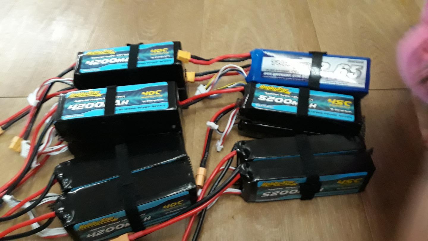

                  I have a good deal of 6s batteries as well, but while using two 4s in series to get 8s for my YAK-130, I decided to try the same technique for 6s packs. I use both lower mah 6s packs in parallel to increase mah capacity, and large mah capacity 3s in series to create 6s packs. See the photo below, what is I've found is I can put more mah on board each jet, cheaper and lighter than buying 6s packs. The 4200 mah packs are 6s in parallel, allows me to put 8400mah on board for the weight of a 6000mah 6s. The pack on the upper right side are also 6s in parallel, not quite as light as the Hobbystars it still gives me 5300mah for the weight of your average 5000mah 6s pack, and the two packs together are also shorter. Below that pack on the right hand side is two 3s pack 5000mah in a series, about the weight of a standard 4000mah 6s pack but not as wide.

                    Yeah, I did that with my HSD J-10, two 4S 5000 pks to make 8S, it worked out good but I like the single battery idea, just works better for me.

                      You're claim appears to be very misleading. You cannot bypass the laws of physics regarding the composition weights of LiPo cell structures.
                      In the above claim that is in bold print the actual weights are known to be..............
                      HobbyStar 4200 40C 6S........515g x 2 > 1030g versus the HobbyStar 6200 50C 6S(closest I could find to compare) at 850g
                      Your 8400mAh of capacity is adding almost another 200g(.44 lbs) over the single pack.
                      I use 2 x Admiral 5000 50C 3S packs in series instead of one Admiral 5000 50C 6S as a better method of controlling internal cell IR's due to heat.
                      I pay for this in additional weight.
                      A 5000 3S weighs 372g x 2 for a total of 744(26.2oz) + 28g/1oz for the series connector whereas the one 5000 6S weighs 732(25.8oz)

                        OV-10, I humbly apologize if you felt my preference for using dual packs to get more capacity for less weight and less money was very misleading. I certainly wouldn't dream of bypassing the laws of physics lol
                        A better comparison per your example would be comparing the Hobbystar 8000mah 6s 100c of which I own two verses the "HobbyStar 4200 40C 6S........515g x 2 > 1030g". So the 8000mah 6s weighs 920g, pretty close to the two 4200 packs, yet I get 400mah more capacity. But in all fairness to the laws physics, there is a 110g difference for the additional 400mah. I also acknowledge your valid argument for the additional albeit small increase in additional grams for the extra connector. Now that the physics are squared away, on to the reason as to why despite physics I still prefer using two packs....economics and versatility. 1 8000mah 6s pack costs 159.99, while 1 4200mah 6s pack costs 69.99, so for the versatility of being able to put a double pack in my larger edfs I also get to use the single 4200mah 6s packs in my smaller edfs, all while saving 20 bucks, or to be exact, $20.01.
                        Disclaimer, all information provided in my posts are for entertainment purposes only. Please note, do not operate any aircraft based on my opinions. I am not responsible for any damage or loss of aircraft due to my gross misrepresentation of the laws of physics.

                          NICE congenial rebuttal...............................I totally do get your versatility/economics practice. Same principle reason I have for using 2S and 3S packs in series to make 6-10S power systems along with the remediation of heat dynamics for larger celled packs. Bottom line to remember though about cell power, every mAh costs in weight.
