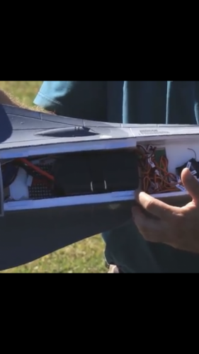

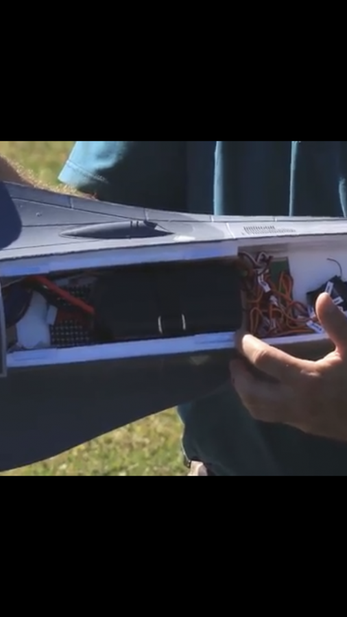

                      Honestly, I can’t remember. I drew a line where the battery should be placed for my preferred CG. I have over 20 planes that are flight ready, so I had to start marking them to save myself from having to break out the CG stand all the time. I put my 5000mah lipo in the same spot as this image and it worked perfectly. The manual had the lipo about an in inch aft and it was a handful. When I moved the CG forward landing became a breeze. I use a gyro on landings and takeoffs and I use flaperons and tailerons. The tailerons are set to activate when the flap switch is set for half or full flaps.
                      Also, I’m using a Spektrum IX 12, so if anyone wants the file I can send it to them.

                        Any idea what your batt weighs? I have different brands and weights of 5000mah. thanks
                        • C17loadmaster
                          Retired USAF Aircrew
                          • May 2018
                          • 371
                          • Auburn, CA
                          #332
                          I have flown it with 4, 5, and 6000mah packs. The picture is with a 5000mah pack weighing 725g/ 25.57oz/1.6lb. The CG envelope is pretty forgiving on this plane. The lighter the lipo, the better it will fly... the 6000mah made it fly like a rock with no additional flight time.
                          Here is a video with the FMS fan and YeP 150. I’m using a Admiral Pro 60c 4000mah. It’s my only “crash” on this plane. It’s definitely one of the stronger Freewing jets. There are no structural weak spots prone to damage that I can find. The aluminum NLG has bent a few times. Especially after this great landing.
