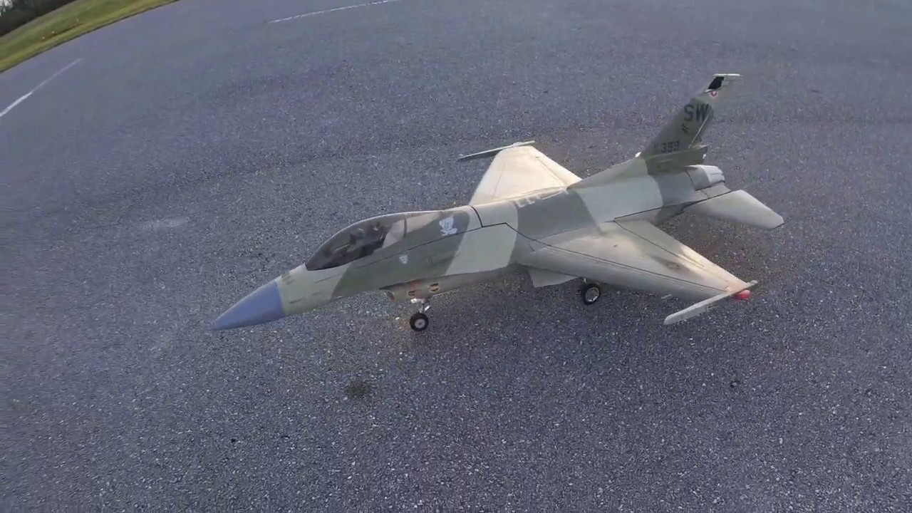

                          Hey all! I'm new to hobbysquawk and thought Id say hi and share my appreciation and video of the freewing 16!

                            Welcome! Great video and flying! Yea...nice runway, but those trees look too close for comfort, or at least for low fast passes.:Whew:
                            I've got over 150 flights on my FW F-16 flying from grass, so the gear has taken a beating. However, it's still my favorite EDF jet and still going strong.
                            I'm guessing you fly Herks from Dobbins? I'm retired USAF myself, Airfield Ops Officer. I was a 2-time air boss and Air Show Director during my career, worked with the T-Birds for 3 of the 4 air shows I worked. Now just about every weekend is an air show with my T-Bird F-16...without all the crowds.:Cool:

                              Thank you very much sir! and thank you for the compliments! Yes CCRC is very tight for these beloved EDFs but I like the challenge!
                              Yes sir I do! I'm a pilot with the 700 Airlift there! Glad to see other military guys on here! That airshow business can be tough. We are in the process of putting together the 2018 one at dobbins now :Whew: I think I prefer the "personal" air shows my self ;)Nice to meet you and glad to be here!

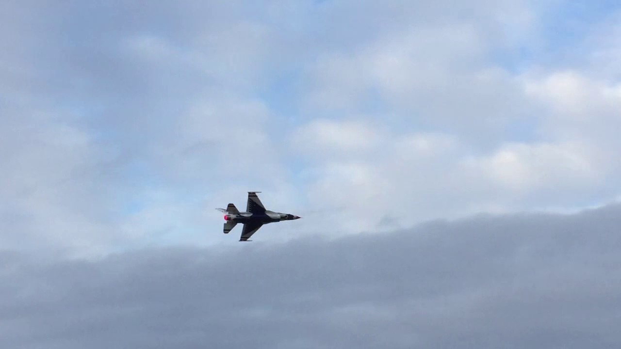

                                      Morning flights

                                        Urrl, looks like you have the F-16 dialed in great, what kinda of setup are you using? Flapperons with elevator mix or something different?

                                          Great flight urrl, always enjoy your videos. Donu, no special mixes to fly this bird, I have flown almost all the 90mm FW jets and this one by far is my favorite, it will fly slow high alpha no problem, it flies so good fast or slow and in stock form, the whole set up is CG and a good battery. The landings take time to learn but after say 25 flights or so you figure it out, yeah it's heavy but once you learn how to use the energy to fly it scale, it is so fun to watch.
                                          I need to get a video one of the these days, what camera do you guys use for this type of filming????
