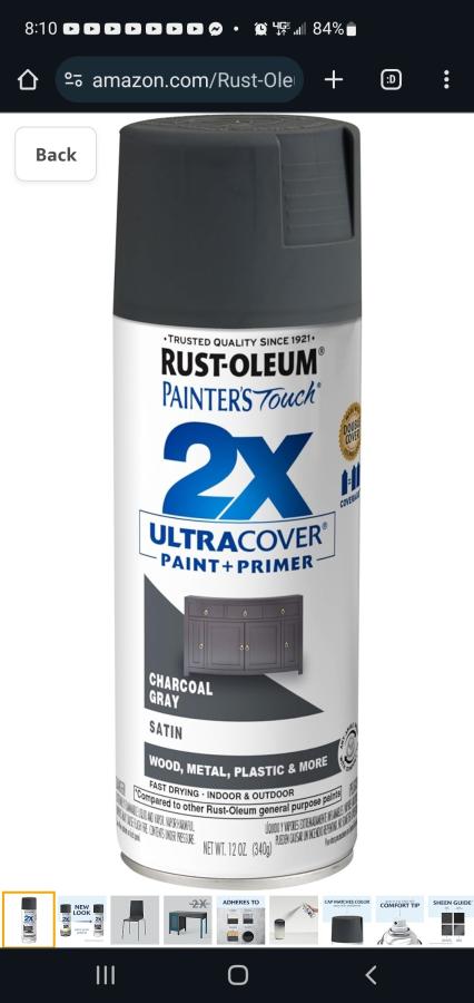

                                  Dear all
                                  which paint shall i use for epo? Where can I buy the paint? Thanks

                                    #1197
                                    For spray paint the Rustoleum 2X is good. Shake well, don't spray close, and light coats. Click image for larger version

                                      CC, are you doing a complete repaint or touch-ups?
                                      There are several types of paint that are compatible with EPO Foam.
                                      I have used exterior/interior latex from the 'big box' stores, I have used enamel rattle-can primer and paint, also airbrushed water-based acrylics are great as most manufacturers have accurate colors, though these can be pricey when doing a larger model, ask me how I know .
                                      I would shy away from lacquer based primers, but you can shoot lacquer paint over other primers.
                                      I am certain there are other paints that are compatible, but these are the ones of which I have first hand knowledge.
                                      Best, LB
