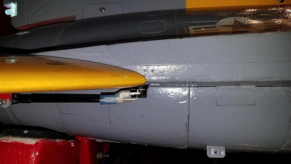

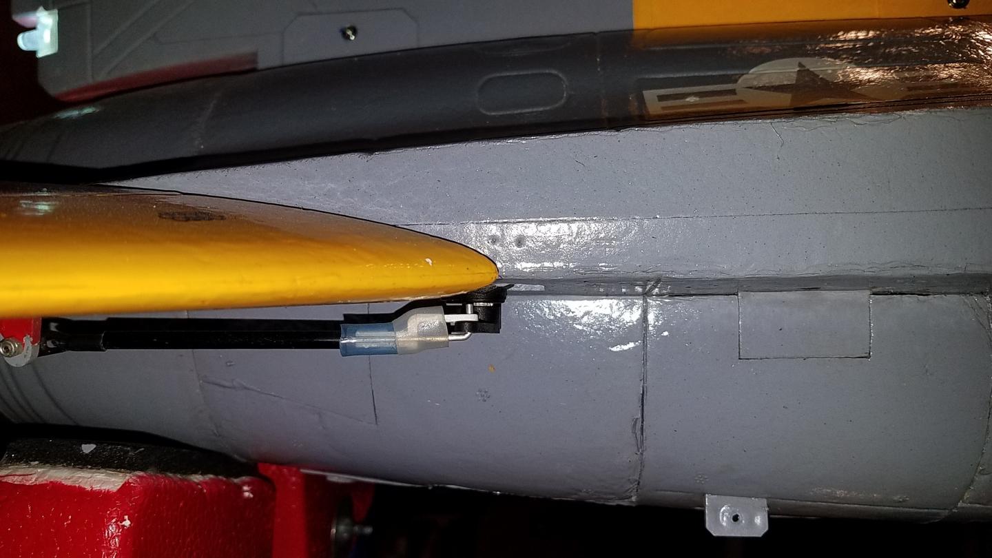

            Also mate, did you find the need to change your elevator servos? What about the power system; do you feel like it has enough power? Also anything I should be aware of with the plane. I have also been curious of where to have the elevator set at. Any reference for its location will be much appreciated.

              I did not change my servos (probably just lazy) and have yet to have a problem after about 120 flights. I did, however, put a carbon tube around the elevator control rods to stiffen them up, not that there was a problem, just to be safe.
