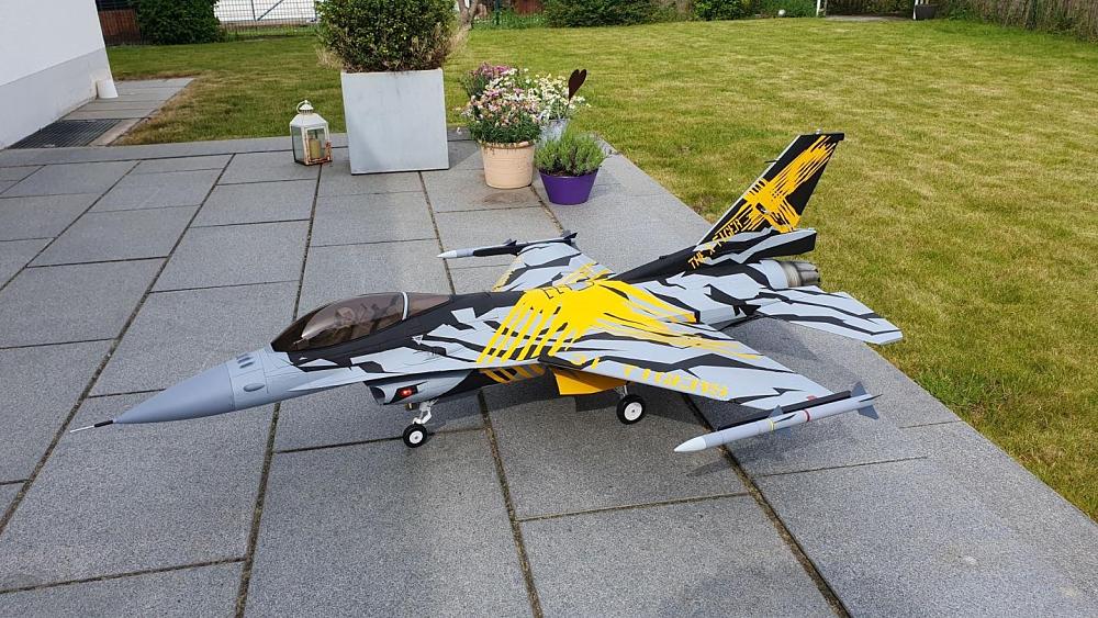

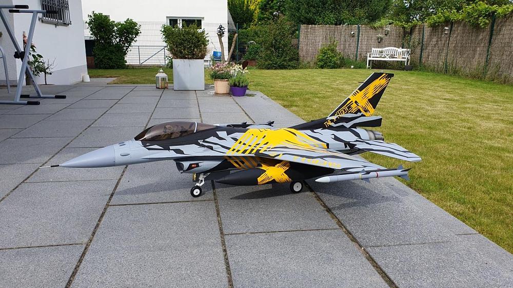

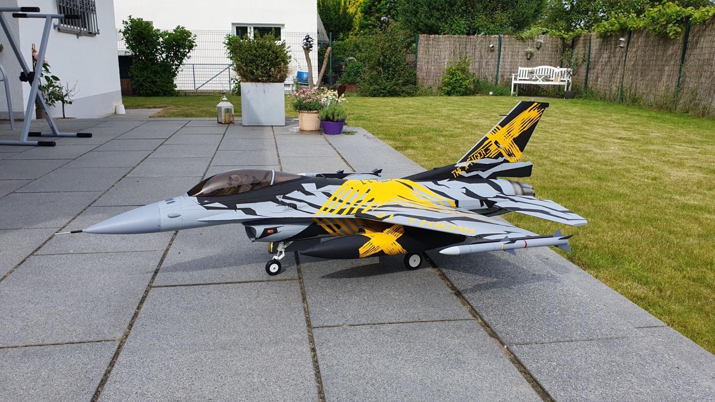

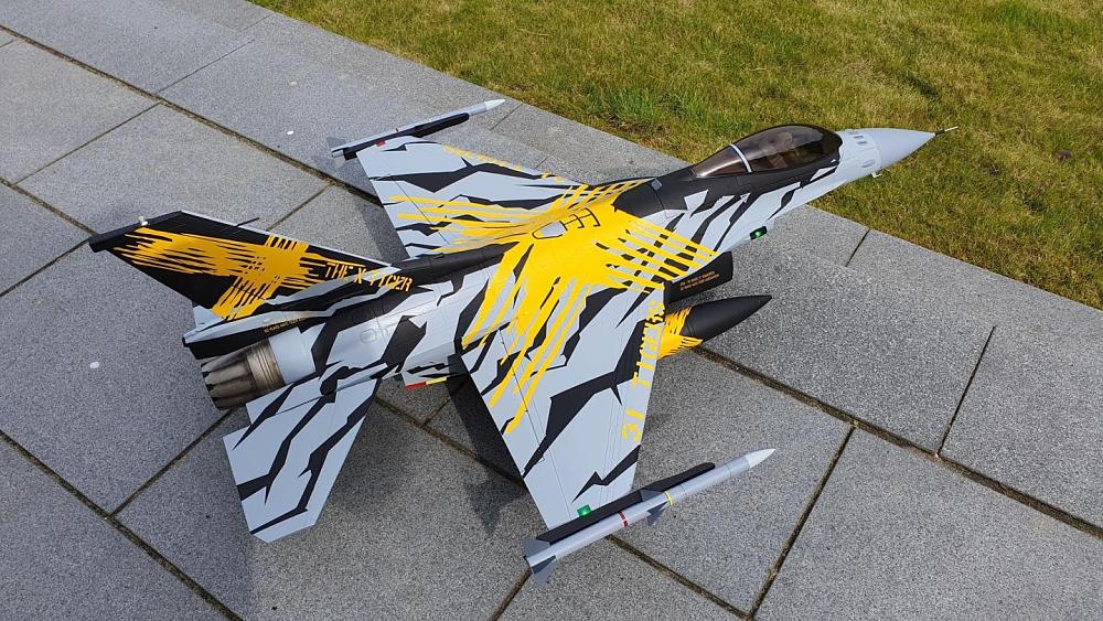

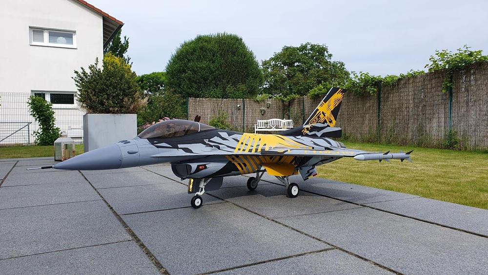

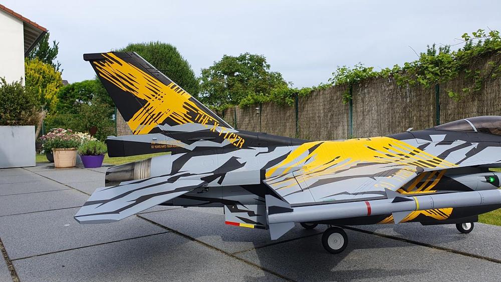

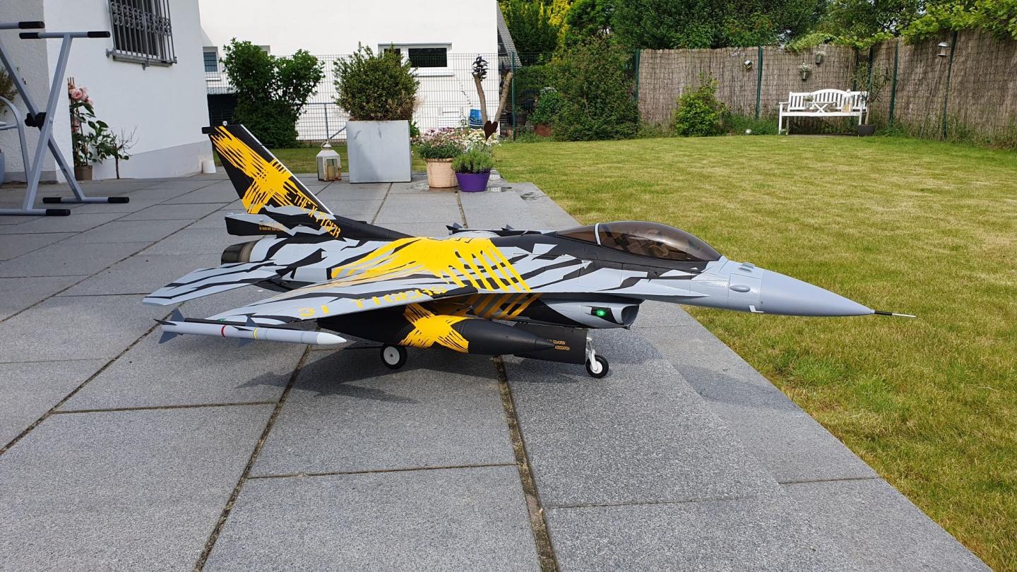

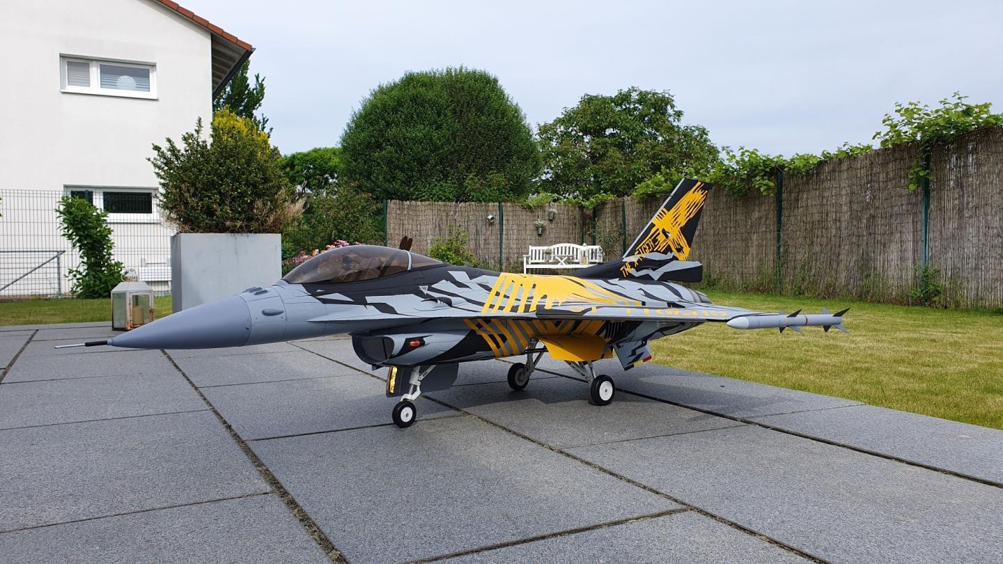

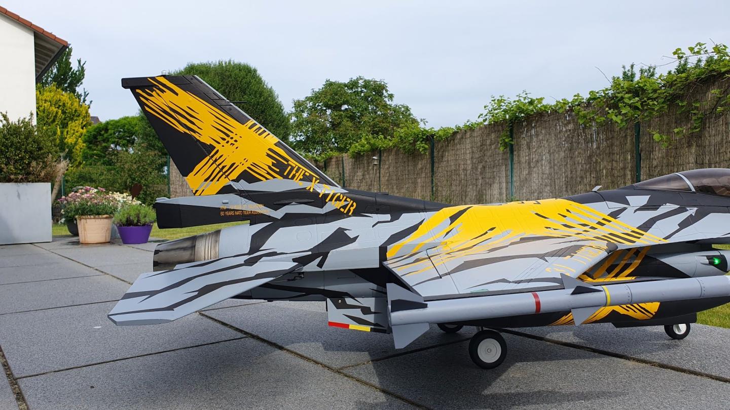

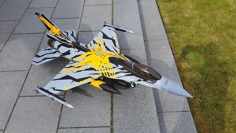

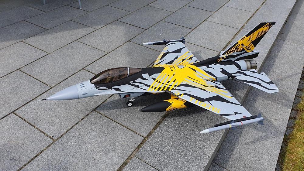

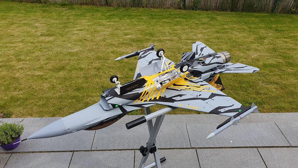

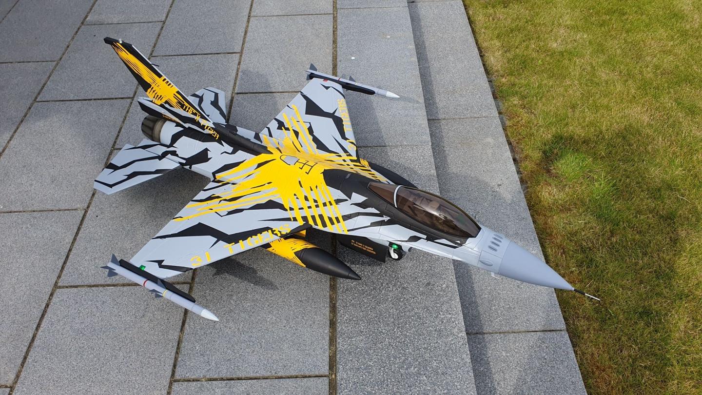

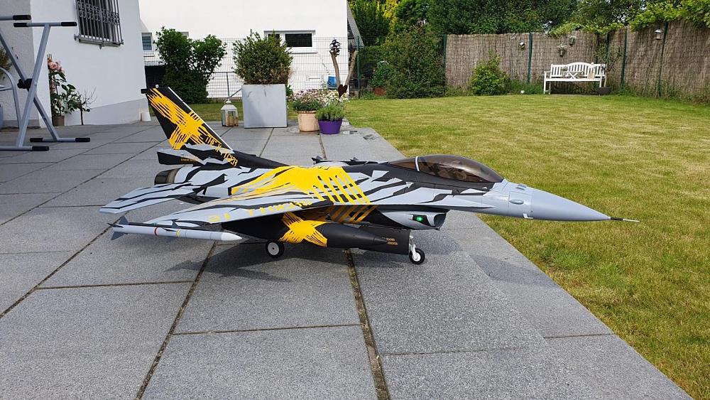

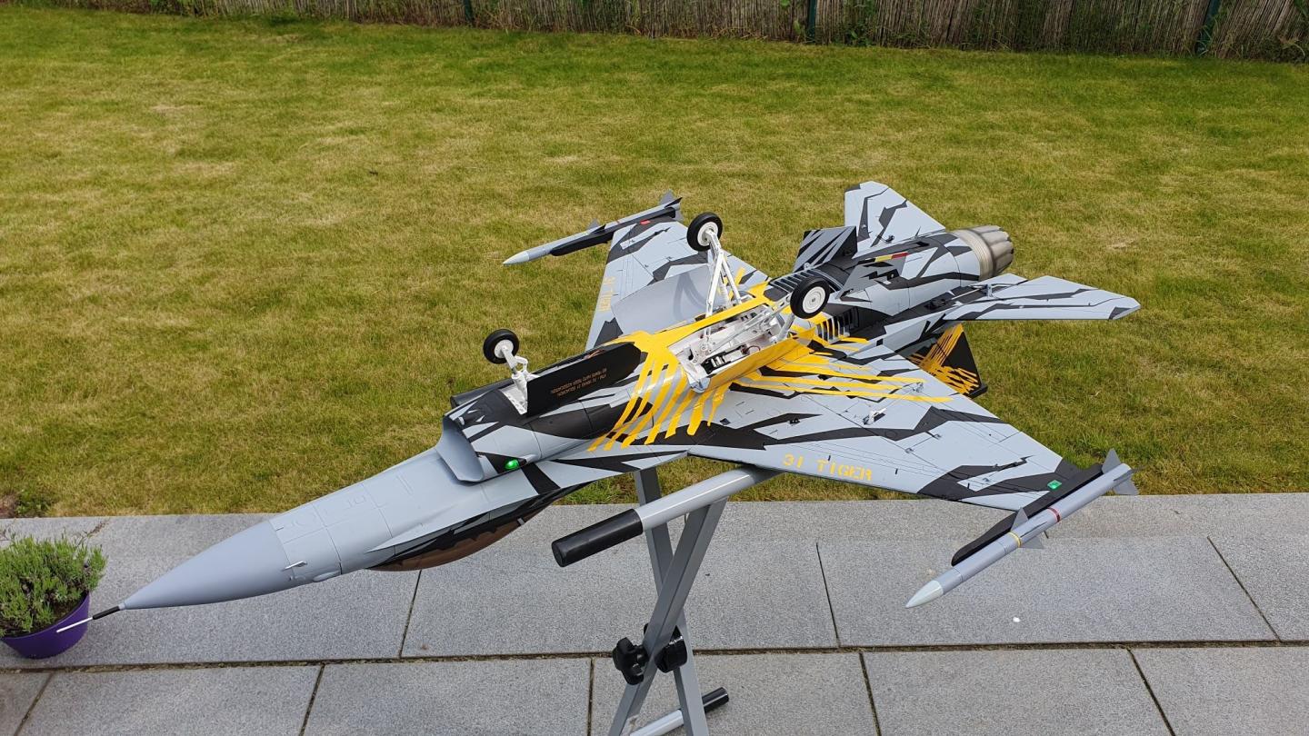

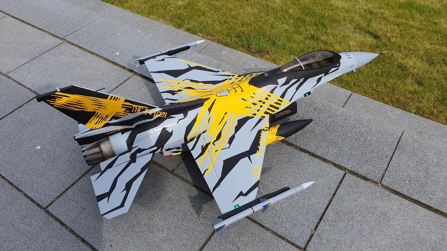

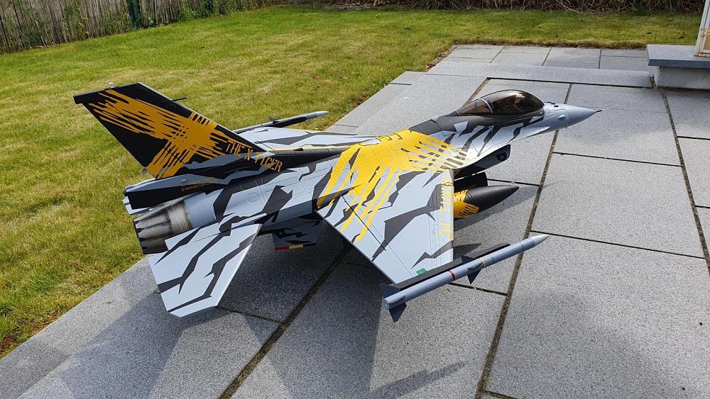

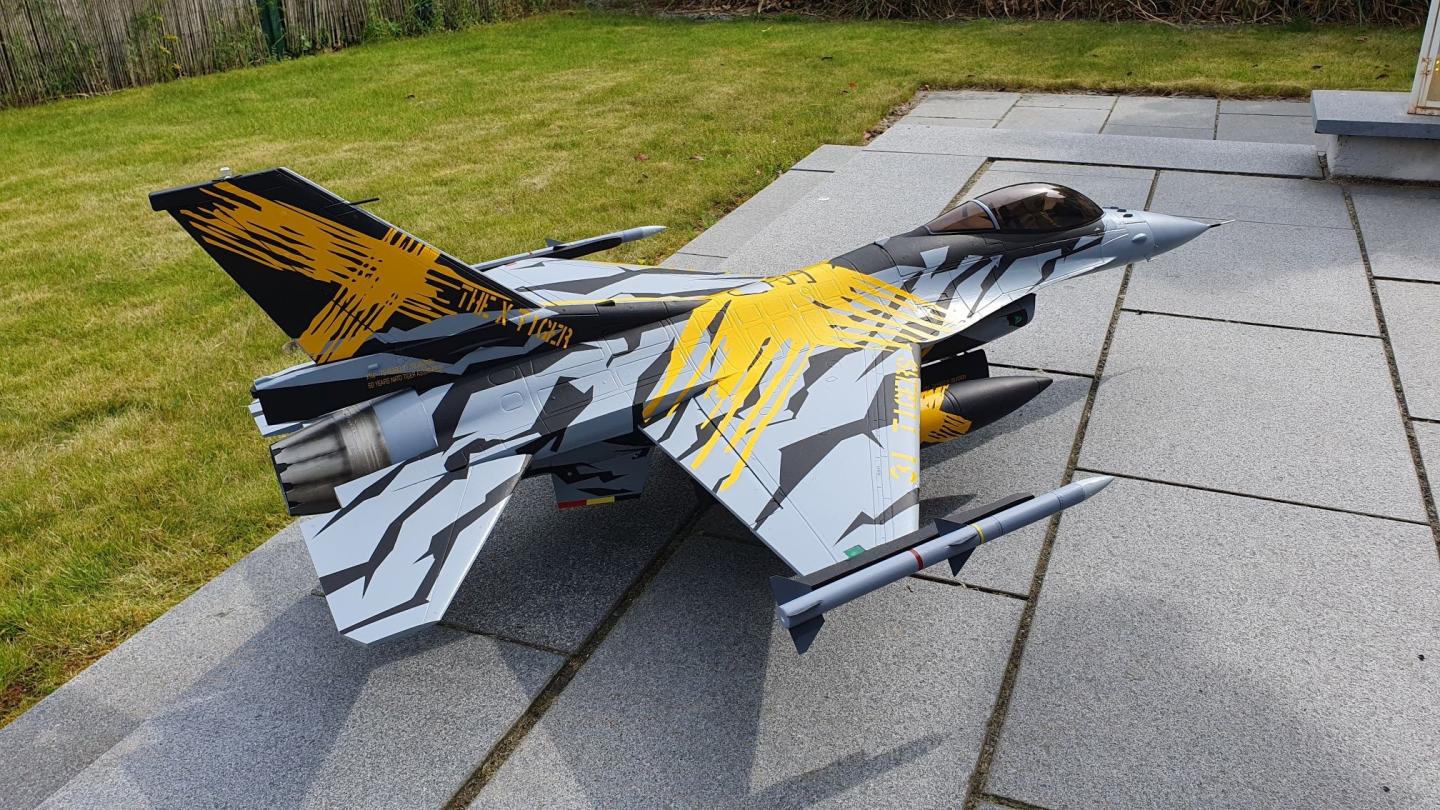

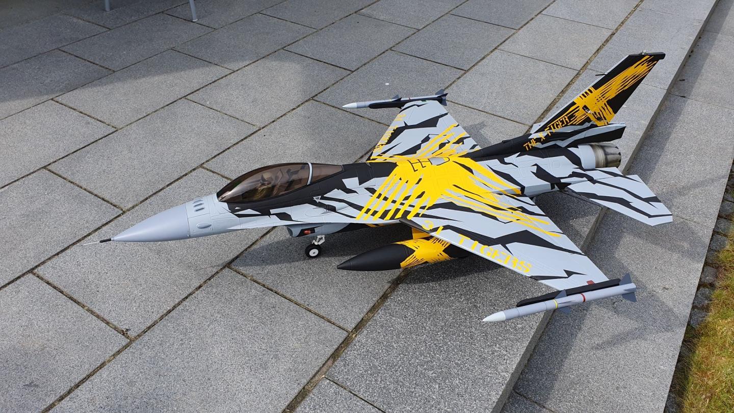

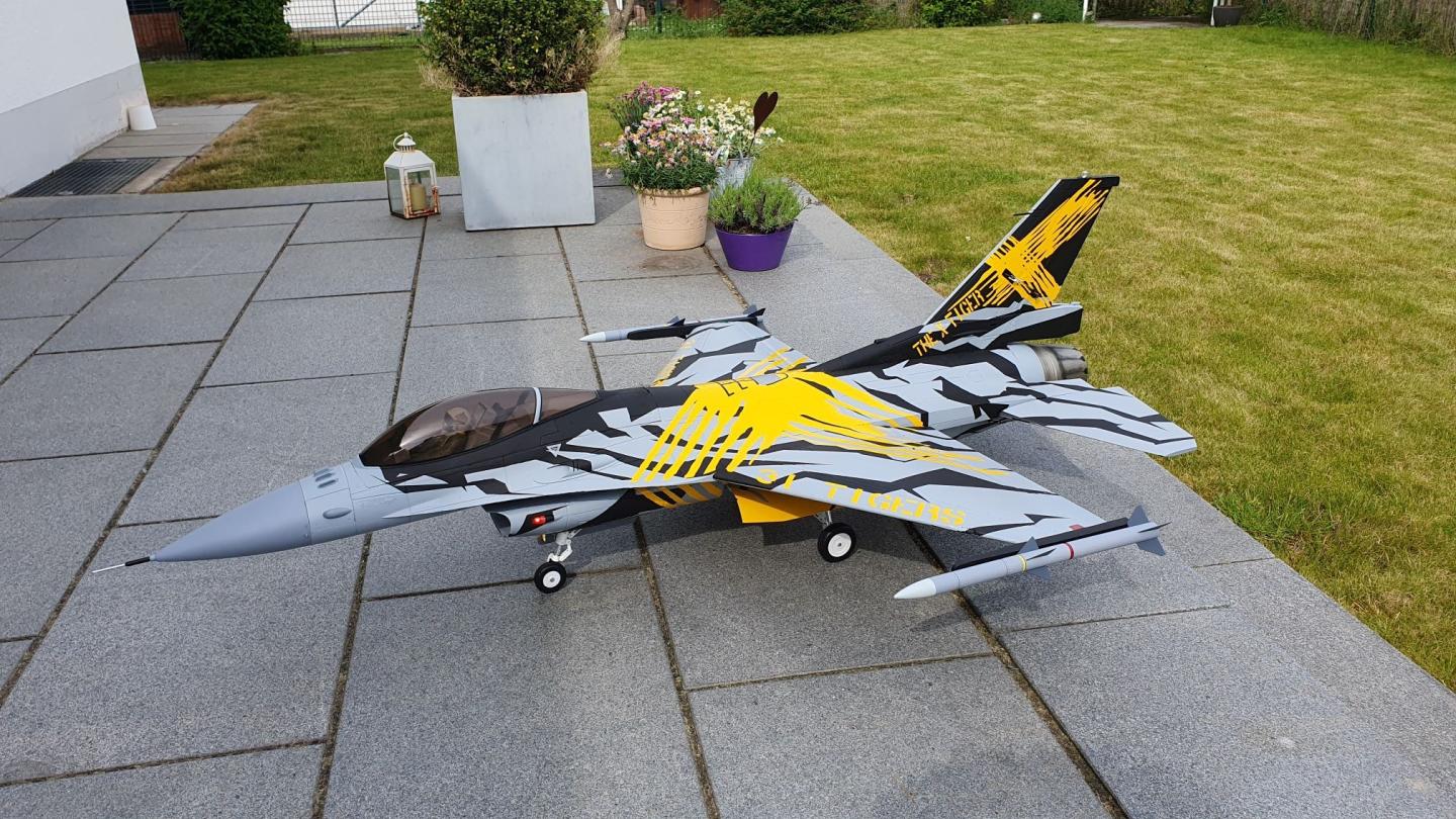

Hi all, today I finished the conversion of the F-16C of the US Air Force to the F-16AM of the Belgian Air Component in the "XTM Tiger" livery. Painting was a pain in the a... but worth it. I also constructed and 3D-printed a new rudder section as it is typcial for the AM-versions. The yellow Xs are decals from Callie graphics and they look fantastic (thx Callie). What do you think?

Eric, that is absolutely super fantastic! IMO, one of the best, if not the best looking F16 I've seen. Looks quite nefarious.Originally posted by Eric Gottwald View PostHi all, today I finished the conversion of the F-16C of the US Air Force to the F-16AM of the Belgian Air Component in the "XTM Tiger" livery. Painting was a pain in the a... but worth it. I also constructed and 3D-printed a new rudder section as it is typcial for the AM-versions. The yellow Xs are decals from Callie graphics and they look fantastic (thx Callie). What do you think?
Since I conversed with you several months ago, I started flying my F16 again as it's been in dry dock awhile forfeiting flight time to others. Forgot how well it flies and gets into a nice high AOA on landing. Doesn't float as much as the Mig or SU, but after remembering to bring it in with a little power and let it drop slowly with it's nose in an FU attitude and a slight kick of thrust just before touch down it's sweet.
I'm now tempted to do another in your scheme. Imitation is the biggest form of flattery.

thx for the appreciation. It was a lot of work, as I said, but I am definitely a little bit proud of my masterpiece 😁. Hopefully, she will not end up as a hangar queen. I've had one F-16 before (which I painted in another beautiful Belgian Air Component scheme (the 2012/2013 demo team version)) but sold her due to the bad landing behaviour (which was due to the incorrect CG that was provided). However, with the correct CG (what is yours?), I hope the next pictures will be of her in the air. I will keep you posted.

Eric Gottwald, um WOW!! One of the best livery jobs I have seen on this model. Simply fabulous. Bravo Zulu!My YouTube RC videos:

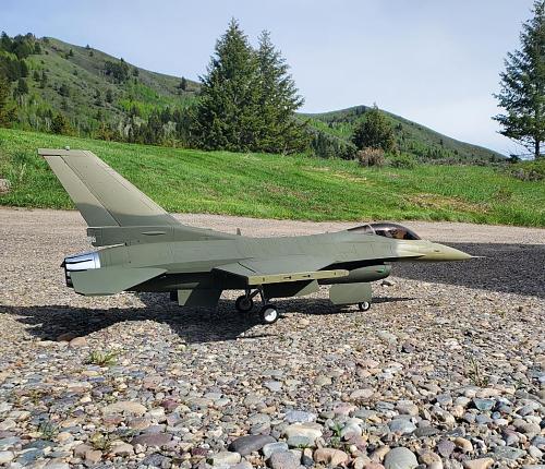

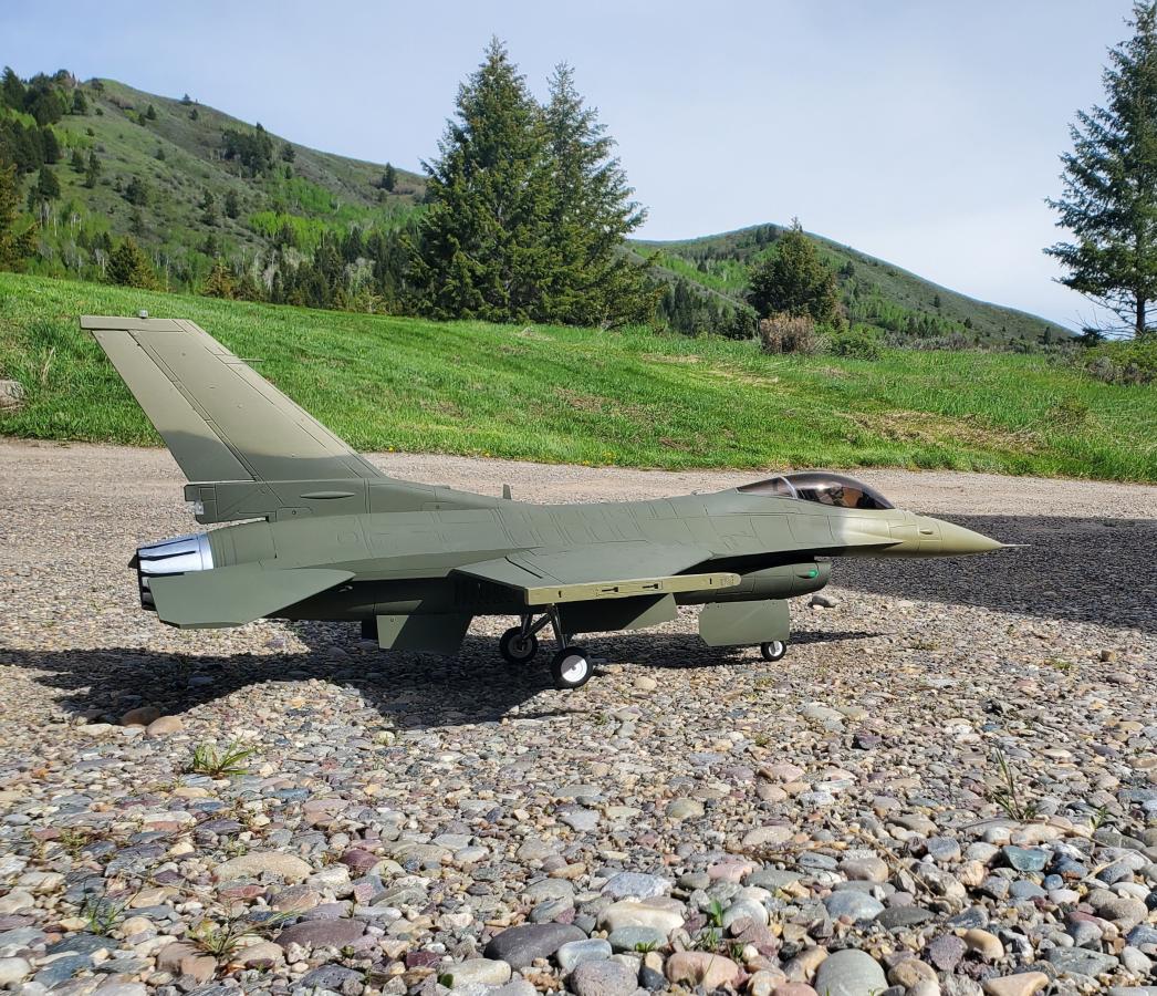

jetpltrich Yeah, it will be easier to see later in the summer when everything dries out. But your right it's too camo for the green of spring. I'm trying to make it easier on myself, my planes are starting to follow a common theme, green camo for the fall, desert camo for the spring. Red is great too.

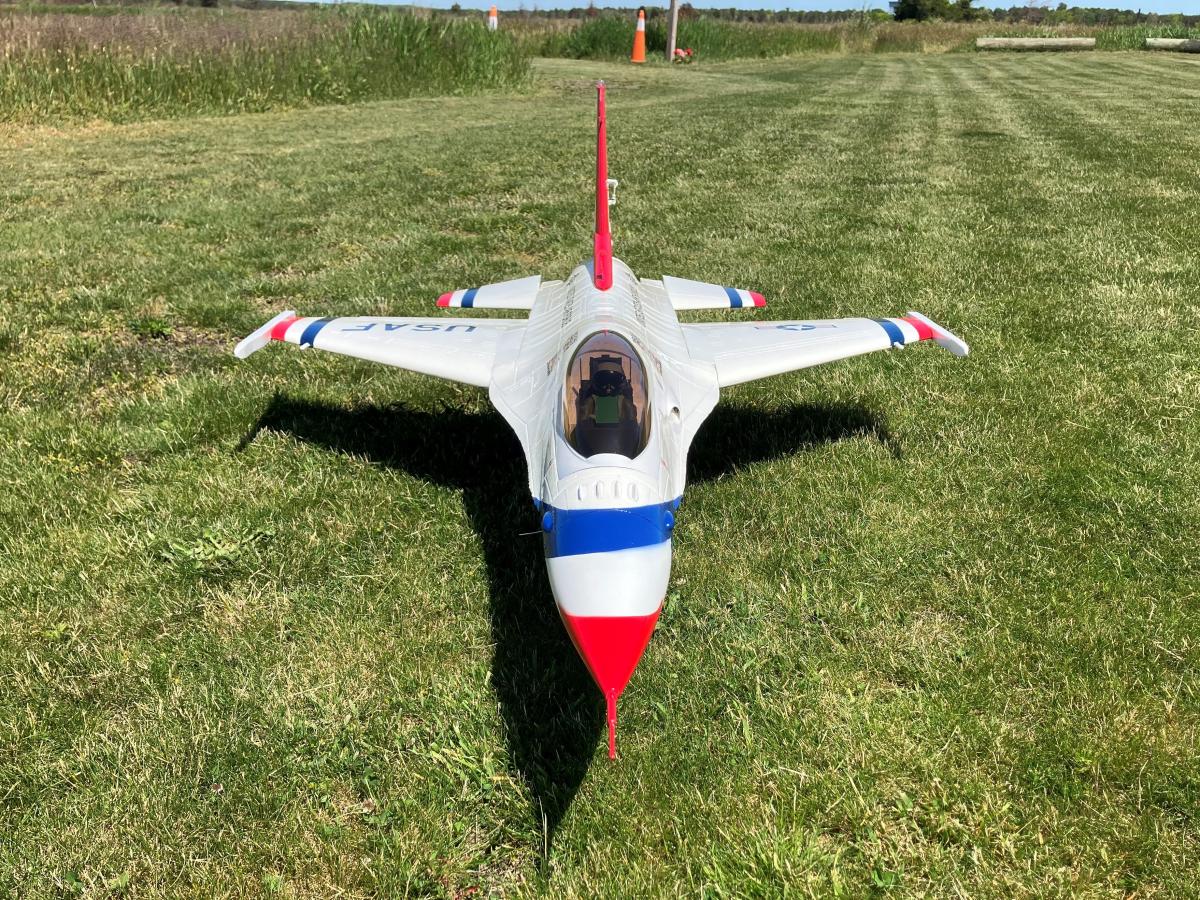

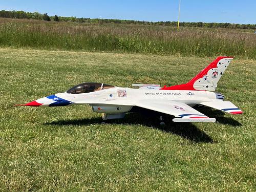

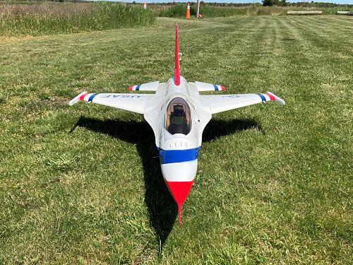

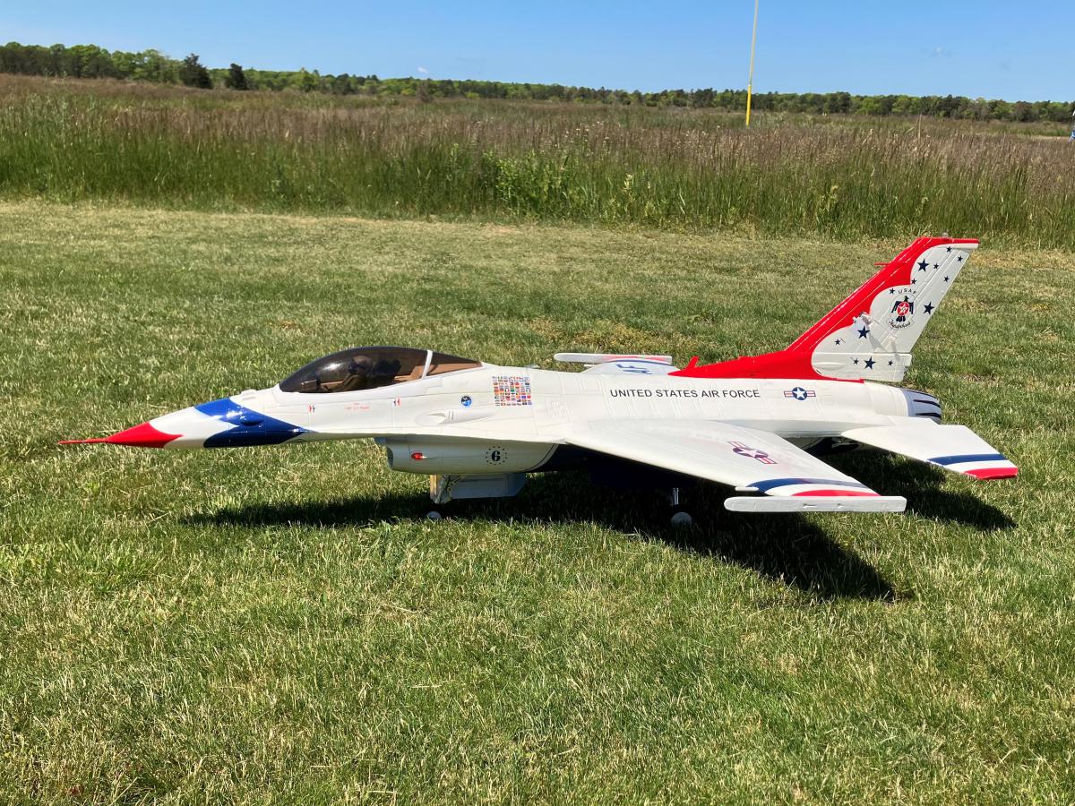

After 2 years as my prize hanger queen my 90mm F-16 Thunderbird had her maiden flight. Was nerve racking on first flight till I got her dialed in with some trims. 2nd & 3rd flights she was on point and flew great. Wondering why it took me so long to get her in the air? Only been flying a couple years so wanted to get my landings down on these big jets. She has a 8s FMS 1500Kv EDF, Spectrum AR8360T receiver, Castle Creations 130amp ESC and Hitec D85MG servos for the elevators. Have some mixes added in , but will wait to try them out.
Flying weather is finally here on Cape Codso the birds are in the air where they belong....

Good job! She can bite with her heavy wing load but if you get her figured out, especially landing profile, she will reward you with awesome sorties!My YouTube RC videos:
