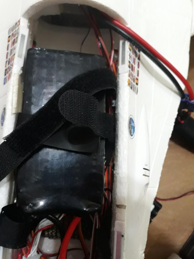

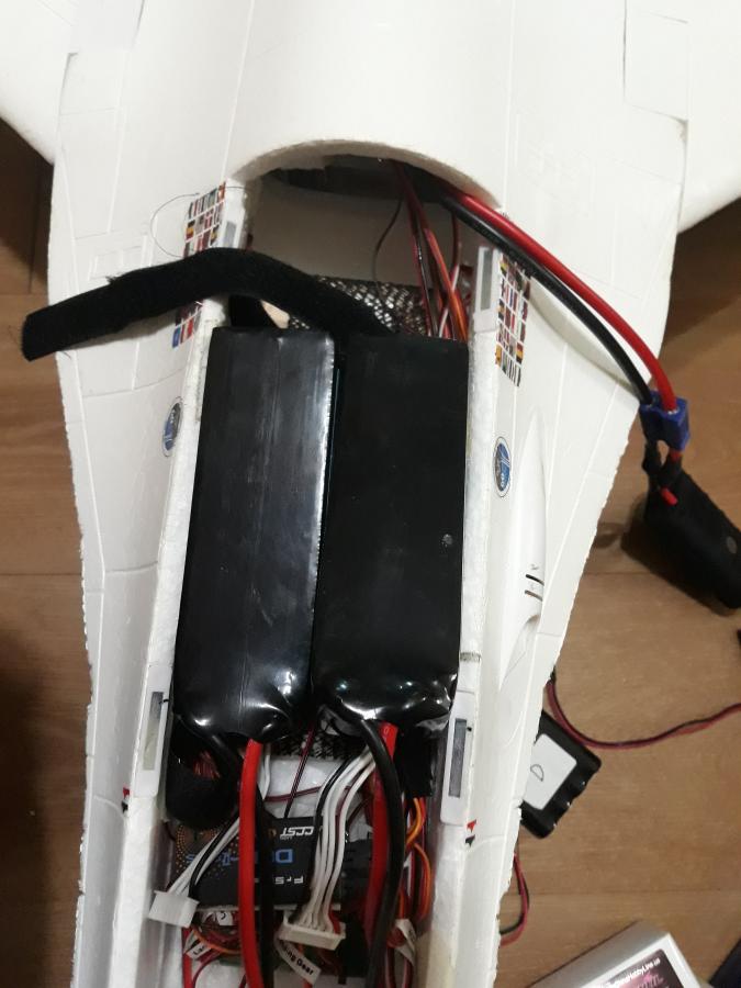

      First off Hugh, your message was hilarious especially the ending!🤣
      Secondly if you're aren't thinking of crazy ways to modify and hopefully improve your RC experience over what the manufacturer had planned for you, then in my humble opinion, you're missing out!😅
      I modified my battery compartment both top, bottom including the sides, when I replaced the fuselage after my 150amp ESC failed on short final. MRC found a bad soldering connection on it and fixed it and sent it back to me. These mods were posted in #534 to #541 of this thread, with pics and the additional room created, measured in mm. I did this mod, to be able to put two 5000mah 65c 4s CNHL Black series batteries wired in series to get 8s power. I was also able to two E-Speed 6200mah 50c 4s lipos wired in series for 8s power.
      When I reverted back to a 6s power the mods extra room was a bonus.
      Pre-mod you can get a
      >HS 8000mah 100c 6s battery in your bay. Weight is 920g, dimensions are 135x43x68mm, cost 159.99.
      You can also get these lipos in your pre-mod battery bay
      >two 3500mah 60c wired in parallel for 7000mah 6s. Weight is 445g a piece for 890g total, dimensions are 133x44x35mm each, at a cost of 69.99 each, totalling 140 bucks for 7000mah 6s.
      >two 5200mah 45c 3s wired in series for 5200mah 6s. Weight is 335g a piece total 770g, dimensions 133x43x26 each, cost 39.99 each totalling 80bucks for 5200mah.
      I attached pics of these lipos in my modified battery bay showing you the additional room left over, they should fit in your unmodified bay given the extra room I have.
      Click image for larger version  Name:	20200617_123501.jpg Views:	0 Size:	64.8 KB ID:	260234
      Click image for larger version  Name:	20200617_123505.jpg Views:	0 Size:	83.9 KB ID:	260235Click image for larger version  Name:	20200617_123559.jpg Views:	0 Size:	55.5 KB ID:	260236Click image for larger version  Name:	20200617_123603.jpg Views:	0 Size:	99.7 KB ID:	260237Click image for larger version  Name:	20200617_123426.jpg Views:	0 Size:	54.0 KB ID:	260238Click image for larger version  Name:	20200617_123435.jpg Views:	0 Size:	81.8 KB ID:	260239

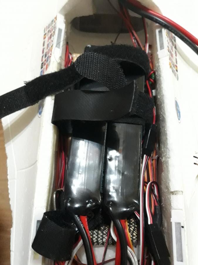

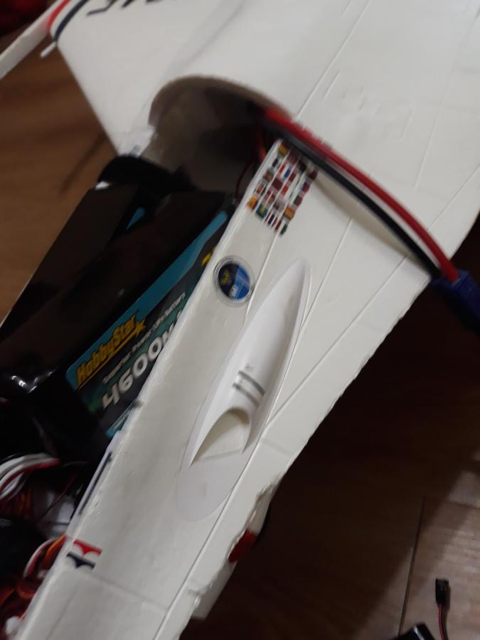

        #763
ID:	260241Click image for larger version
        Above is the HS 4600mah 35c 6s in parallel for 9200mah total. Weight is 570g each 1140g total, dimensions 130x43x47, cost 59.99 each currently on sale normally 69.99 each. So 120 bucks for 9200mah. They have 10 and 20 bucks off sales so often that's usually when I buy my lipos.

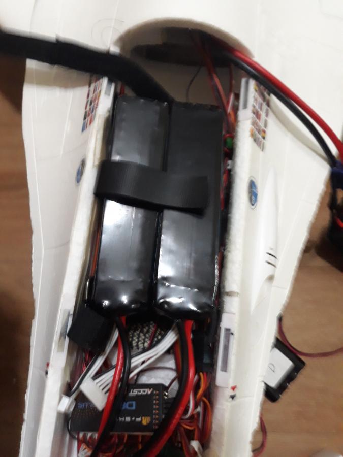

          #764
ID:	260244Click image for larger version
ID:	260245 Here my 4200mah 40c 6s wired up in parallel for 8200mah this is my powerhouse setup with over 3000watts of power. Weight is 570g each 1140g total, dimensions are 130x43x47mm, cost is 69.99 esch for 140 bucks total, but as I pick them up on their frequent sales, I've never paid more than 59.99 a piece for them.

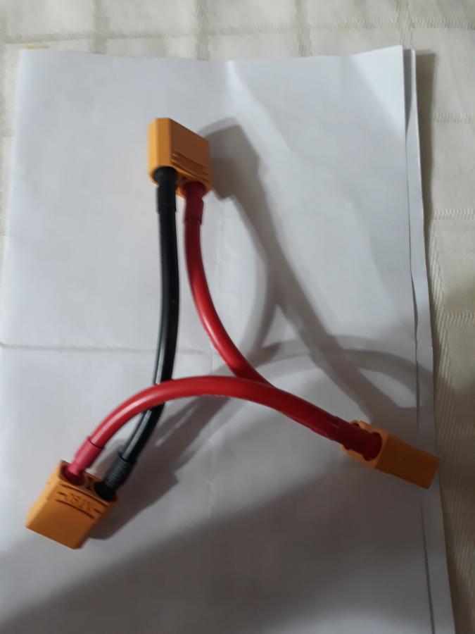

              #766
              This is a series adapter, it doubles your voltage while keeping your mah the same. So two 3s 5000mah lipos become a 6s 5000mah lipo.
              Hope this helps, the mods in post #534 to #541 only take about an hour and a half to 2 hours to do. You're just carving and shaving foam, repositioning the battery compartment magnets, and either adding or relocating your battery strap down plate further aft.

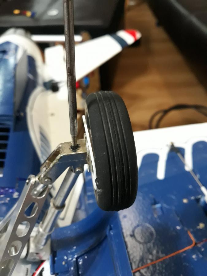

                        #771
                        Soooooo anybody have an idea on how to swap out the main wheels? I've tried the allen set screw on bottom, see photo, I disconnected the strut to check the bottom side to see if there was another set screw, there's not. I can't seem to figure out how these wheels come off.

                          #772
                          Click image for larger version  Name:	20200620_212649.jpg Views:	0 Size:	54.7 KB ID:	260688
                          Click image for larger version  Name:	20200620_212643.jpg Views:	0 Size:	59.3 KB ID:	260689
                          I have done plenty of those, a good allen wrench and soldering iron with a small tip to melt the loctite because they put plenty.........
                          Hold the iron tip in the hole when you pull the set screw out until its nice and hot and use a punch and tap the axle from the inside/outward to get the axle to loosen up, take your time, they will come out.

                            #773
                            Phantom exact same thing happened to me on one of the wheels after a landing and it seemed there was no way to get these off, but DCORSAIR is on the money, as usual. Once you get the allen screw out (with a little help from the soldering iron), that's all that holds it in but they put so much loctite on it that the axle is also "stuck" in. Holding a soldering iron inside the hole for the allen screw "melts" the excess loctite around the axel and it should come out.

                              #774
                              [DCorsair/Hugh] Thank you Gents, I appreciate the inside tips. I'll give it a try.
