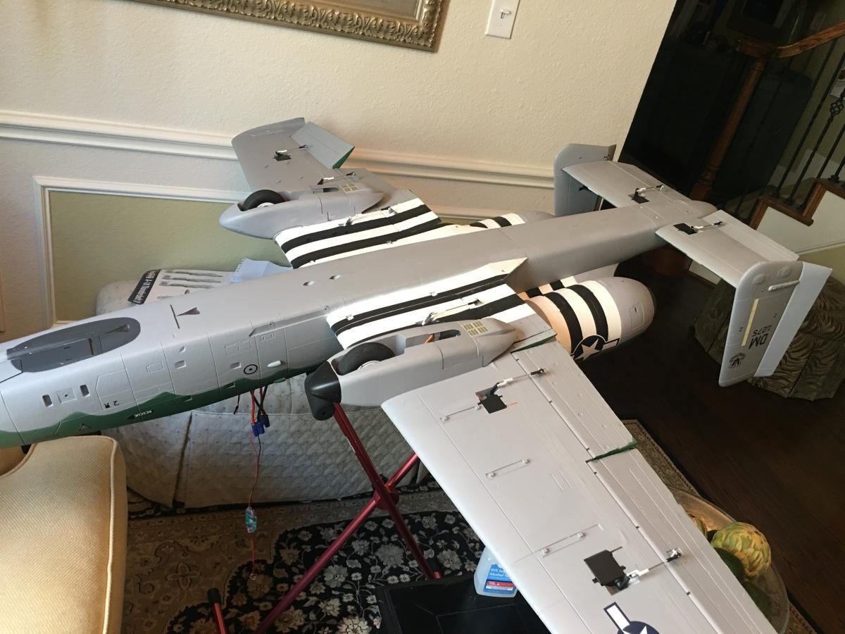

    My baby -- A-10 Demo Team Scheme
    Click image for larger version Name:	IMG_4940.JPEG Views:	0 Size:	233.4 KB ID:	267106
    Click image for larger version Name:	IMG_0179.JPG Views:	0 Size:	141.7 KB ID:	267102Click image for larger version Name:	IMG_0180.JPG Views:	0 Size:	114.0 KB ID:	267100 Click image for larger version Name:	image_59602.jpg Views:	2 Size:	108.6 KB ID:	267098Click image for larger version Name:	image_59603.jpg Views:	3 Size:	126.9 KB ID:	267099
    Very nice indeed. Love the stripes.
  • Warthog
    That's a wild AND good looking paint job!!
  • waytooslow

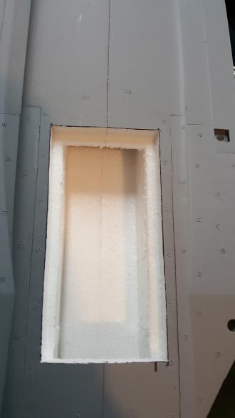

    Hey Brent, I used two of the TT-25 speakers in series to make 8 ohms. The Shockwave2 requires 8 ohms on 6S. I did take advantage of trial fitting the speakers before gluing the fuselage together but I don't think it is necessary. I cut a hatch in the bottom and framed it with strips of 1/8" plywood. Not having the back of the fuse glued on did help with knowing where to cut though.

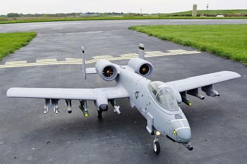

    This Covid virus must be effecting me....I was always so happy with the stock power system in my A-10. I just finished installing and flying her with the Freewing 1857kw inrunner 12 blade power system. First thing I noticed was the sound. Less motor whine sound. And I was very happy with the vertical power improvement. Increase in top end speed not real significant, but noticed. Click image for larger version
