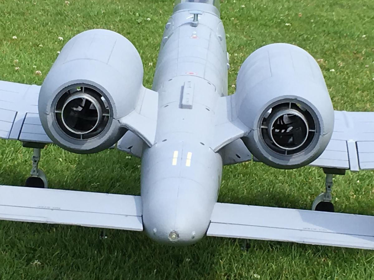

          Does anyone know where to find an stl for modified exhaust nozzle to correct thrust line? Originally I had seen a post about them but the links to thingiverse returned 404 so I have searched and searched but no luck yet. Thanks!!
            • 4856
            #685
            CS, were the A-10a nozzles you are looking for on Thingiverse, designed by Dirty Dee?
            If so, DD has smartly moved all his designs to the Cults3D website.
            Check there anyway, his nozzle design is top-notch.
            Best, LB

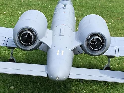

                #687
                Highly recommended!
                https://cults3d.com/en/3d-model/game...e-thrust-tubes
                  • 4856
                  #688
                  Originally posted by Radar-Guy
                  RG, I know, right?! What's not to like?! Thanks for including the the URL. Corsec, these nozzles by Dirty Dee are great and a drop-in install. Best, LB

                    Went to print them and my x axis motor crapped out. Ah well. Next weekend!!!
                      Elbee commented
                      Editing a comment
                      CS, now that truly sucks. Best, LB
                  • Corsec
                    • Oct 2023
                    • 11
                    #690
                    Got the printer running again. Side note, stepper motor Anti-corrosion coating had began to come off stator and was causing excessive dragging this the motor issue, ultrasonic cleaner for a couple minutes and clean up with a plastic bristle brush runs like a champ again.
                    Got the nozzles printed. But how to remove the stock nozzles without tearing up foam? Any pointers? They seem to be glued in? I can’t see any glue but they are firmly in place. Get rough with it? Or is there a secret to taking them out?
                    thanks!!
                      thanks!!
                      CS, As I recall, I cut the OEM nozzles in a couple places fore to aft. I pried up on an edge without much damage. In any event, clean up was minimal and not much shows after you reassemble the nacelles . Hope I've helped. Best, LB
                      • Corsec
                        • Oct 2023
                        • 11
                        #692
                        LB, thank you sir. I went ahead after reading your post and just worked around the edge with x-acto and then worked the nozzle around some. It did come loose with a little paint :-) but as you say nothing shows with the new nozzle in place. Thanks so much!

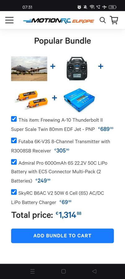

                          Morning all
                          I'm looking in to getting the Freezing A10 and apologies if this gets asked a lot.
                          Is there a list/record of all the mods so I could make an ultimate A10, add ons, mods, improvements and tweaks. Does anyone sell mods ready to install as I don't have a 3D printer and work away on ship a lot so things already painted would be ideal.
                          This is the package I'm looking at, any recommendations for the electronics such as Gyros, and such that would dramatically help out with balanced flight and keeping her steady for take off and landing?
