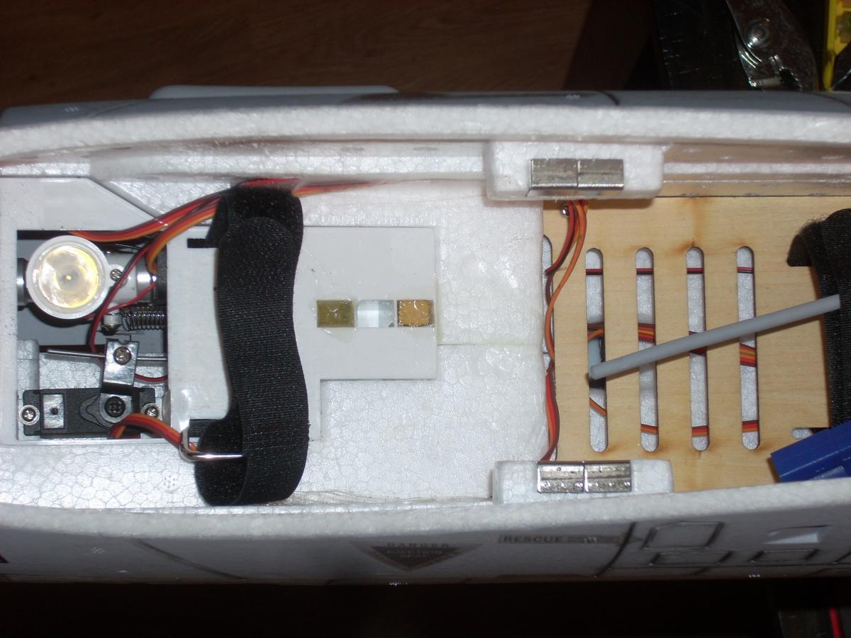

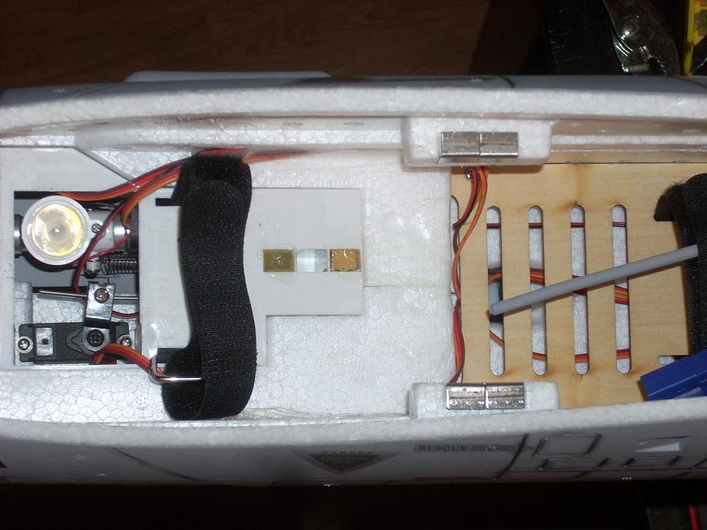

What I did was take some square hardwood and glued it into the holes in the plastic from the top, then used larger wood screws on that side. Helps a lot. But there is a 3D printed nose gear mount as well.
Nose gear mount file here: https://www.thingiverse.com/thing:4177413
