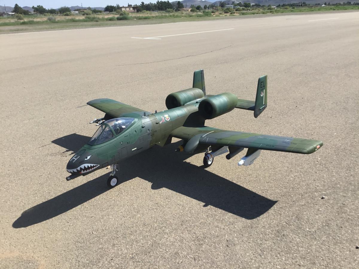

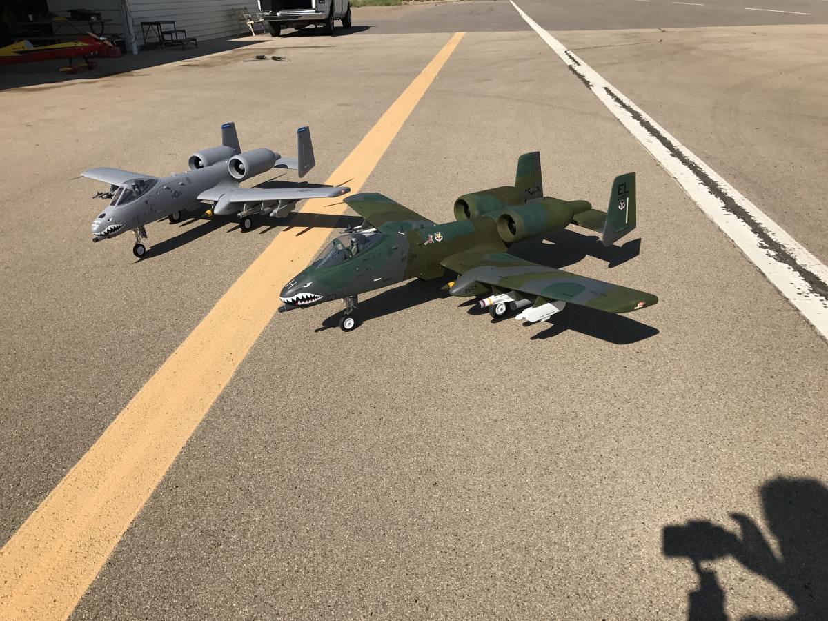

                                Hey everyone, saw Steve's documentation on the mods he made and I've decided to go whole hog on detailing my hog ;)
                                My first flight didn't go well because of a few things, poor field choice (it has LOTS of trees around it) too optimistic on the flight time, and a stuck retract. It ended up pretty much destroying itself in a flight into trees but the electronics were ok.
                                Got my second one recently, go it all put together and flew it at a better field with a little more pessimistic timer setting for flight time. Got two flights on it and I'm absolutely loving it. Flies very much like the real A-10 (I was a flight simulator tech on them in Alaska) and I already have my shockwave 3 system ready to install, I'll be doing the ladder mods, opening canopy and dirty Dee's STL files (totally worth it) and some other models off thingiverse and three d print a lot of accessories for it. Might even give the powder cannon a shot. For the paint scheme I'm going with the 'Spirit of Fairbanks' from when they first got stationed at eielson (thanks Callie Graphics for the decals they look amazing)
                                I'm also using redundant receivers from frsky
                                I'm also going to go through all the pictures I have and post it on here. It will have to wait a little as I just had back surgery and a total knee replacement on my right knee. But I'm estimating a year to finish it all up
                                Here's the video of the remaiden flight ;)
