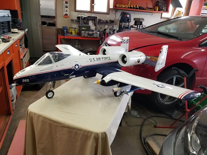

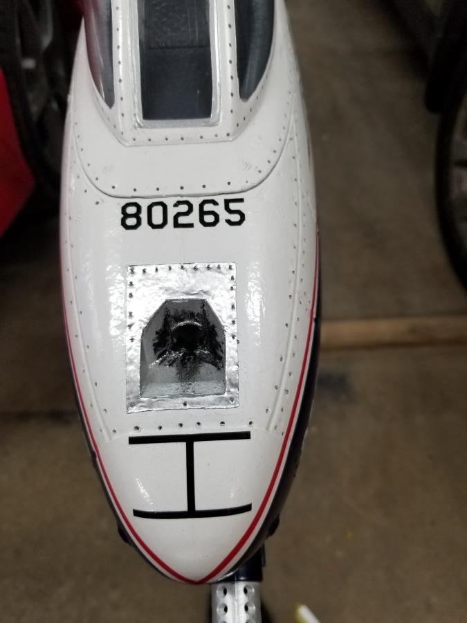

    #621
ID:	251916Click image for larger version
ID:	251917Click image for larger version
ID:	251918Click image for larger version

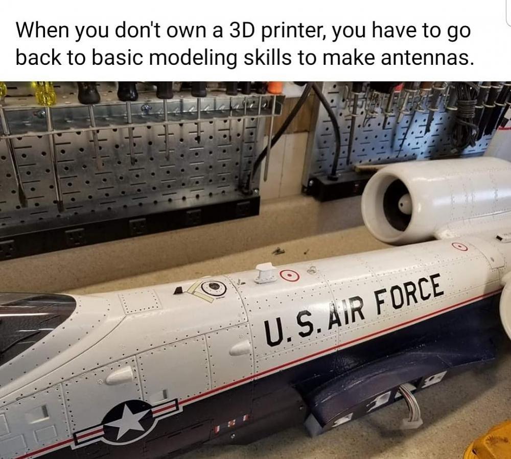

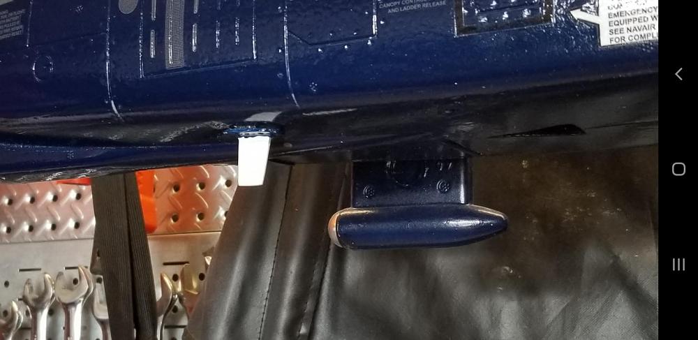

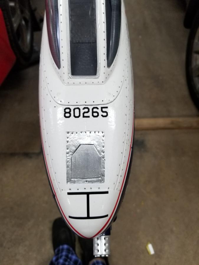

      Originally posted by t33jetman
      Click image for larger version  Name:	69799711_2301106643257996_5982376405189525504_n.jpg Views:	0 Size:	147.3 KB ID:	251916Click image for larger version  Name:	94504798_2776575252377797_4508796413244604416_o.jpg Views:	0 Size:	98.5 KB ID:	251917Click image for larger version  Name:	94220720_2782266828475306_2678323828915961856_o.jpg Views:	0 Size:	111.9 KB ID:	251918Click image for larger version  Name:	92860923_2756489144386408_4243804490223845376_o.jpg Views:	0 Size:	115.7 KB ID:	251919
      Looks great!! I still do a lot of "old school" mods with Styrene, Epoxy Putty, Basswood and such although I am designing more 3D printed stuff. No where near the level of Elbee, Dirty Dee or apmech1 but I am getting better. Hey, whatever it takes.

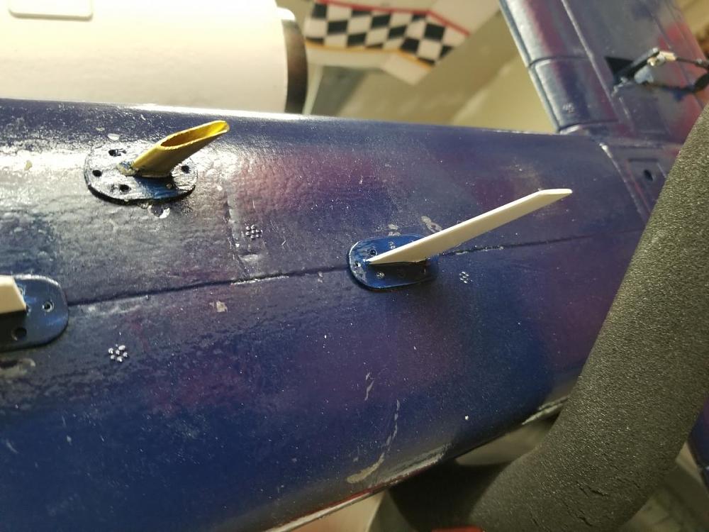

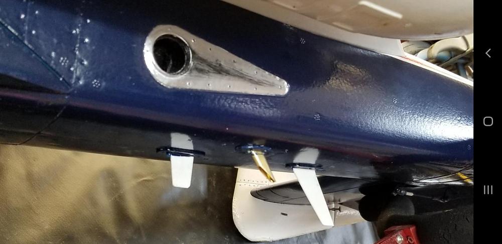

          t33jetman or anyone else that might know. I want to redo the antennas with styrene that might be a little thicker. What thickness is advisable to use?

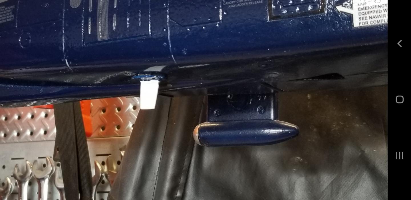

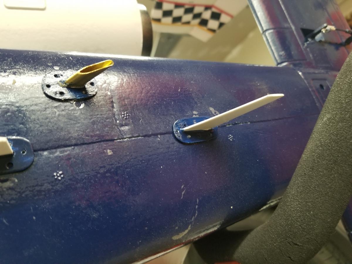

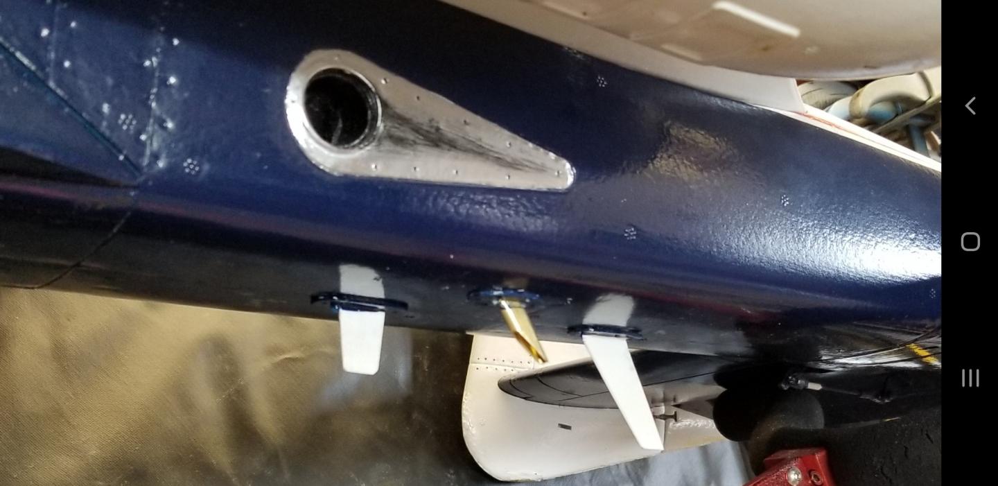

            I use credit cards for my antennas and a small brass pipe for my exhaust. Click image for larger version

              #626
              Thank you, I never would have thought of that.
                #627
                I did mine in .06"/1.5mm Styrene.
                • t33jetman
                  • 515
                  #628
                  The middle one is a pipe.

                    Yep, it's the fuel dump

                        Jetman, what was the size of the pipe you used for the fuel dump?
                          You wont like this , but I just took a round brass tube and flattened to shape it to an oval by eye balling it to size with the antenna , the cut it on the bandsaw.
