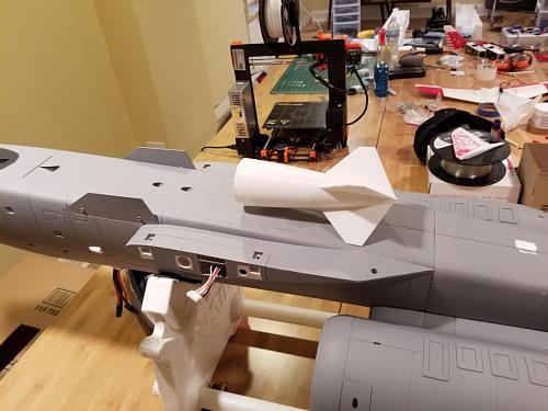

Yes there is an Anti Collision Light aft of the canopy, just behind the TACAN blade antenna..Originally posted by RCjetdude View PostHey Chris, another member has a question about beacon lights on the aircraft. Isn't there one on the spine of the fuse aft of the canopy? Any pictures you know of?

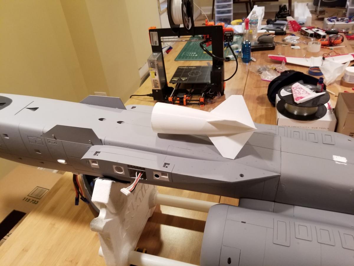

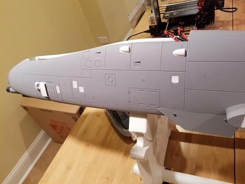

The 2 side scoops were removed for the "C" models. I did a white paper to show the turbulence from the Gun Exhaust disrupts the Laminar flow to the AOA which is downstream, and plays havoc with the CICU's targeting solution. We removed both gun scoops on A-10's getting the PE mod. The Wire mesh screen was left so large FOD could not enter the fuse.Originally posted by Dirty Dee View Post
Thanks for the Info Chris. Though the reason I have the scoops, similar to Steve is that I am recreating it as an A-10A from the gulf war in Euro green. On the topic of accurate detailing, do you have recommendations for books or sites for reference materials on the structures and markings for A-10s? Also, any idea if there is an available structural repair manual available to the public to get accurate cross sectional data on the fuselage?Originally posted by Czonio View Post
Off hand I don't know of any particular books to recommend. Not sure if the TM's (Technical Manuals) are out in public, but you can check Ebay....you never know.Originally posted by Dirty Dee View Post
