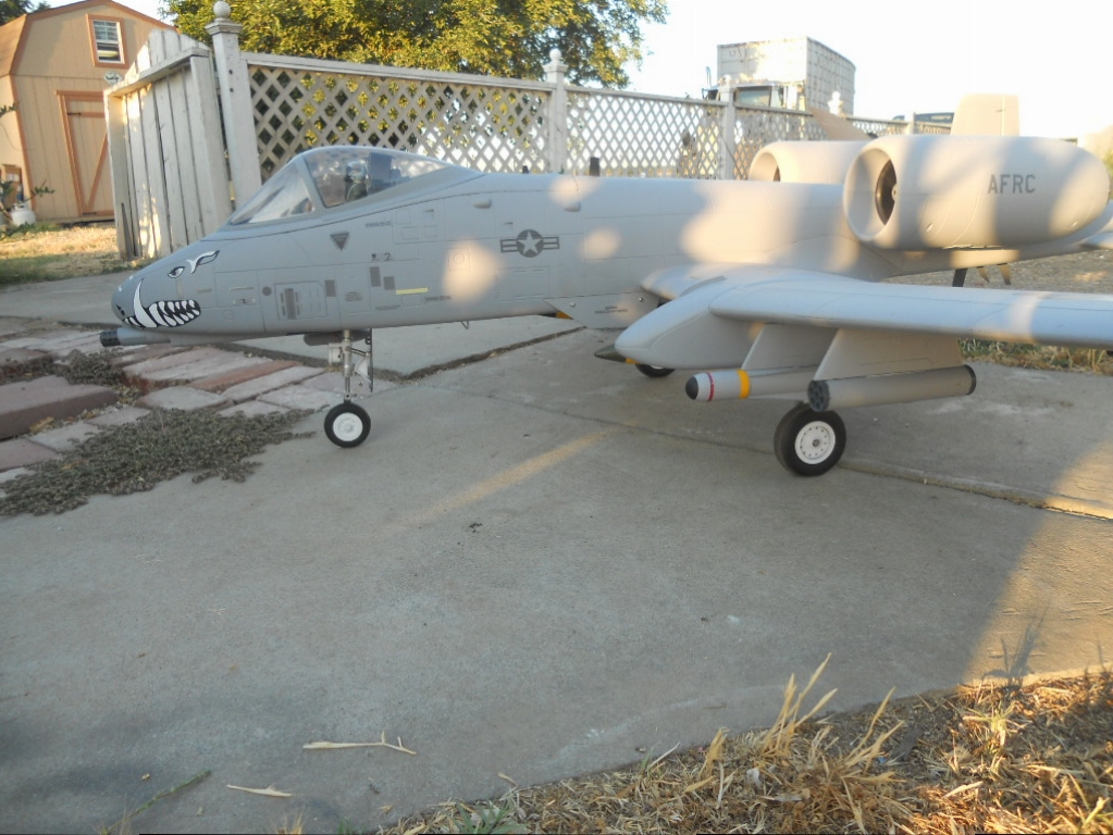

That no doubt looks better to me :Cool:. I think Freewing created larger wheels simply for better non-pavement related operation.Originally posted by DCORSAIR View Post
If you make up some plates, I'm sure there are others who would be more than glad to pay for one, my nose gear has a lot of slop in it, so I would need one for sure. Also changed out my nose gear tire, the stock tire just looked to big to me.

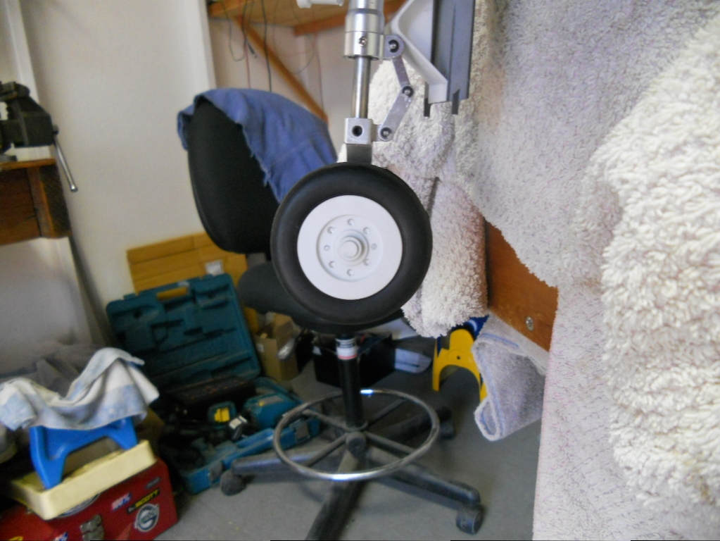

I thought they must have did that for the grass guys, I fly off asphalt so it shouldn't be a problem for me, to bad FW didn't include a smaller scale front tire or offer one for us asphalt flyers. I used a main wheel from the fw F-14, drilled some dimples in it and painted it white to match the rear, now it looks more scale, I know it's a small detail but that big tire was all I could look at on those locked down and dirty passes.
Note: You will have to shim it to keep it centered like the stock one was. Let me try it first guys and make sure it holds up or have any tracking issue, it has two small screws that hold it together pinching the tire in between the two rims, it's one of those two part rims, seems strong and very well made.
+1 on the nose gear plates. Love the scale nose wheel mod as well, will definitely be changing to the F-14 wheel on mine!Originally posted by DCORSAIR View Post
Nice mod. Let us know how it goes.Originally posted by DCORSAIR View PostI thought they must have did that for the grass guys, I fly off asphalt so it shouldn't be a problem for me, to bad FW didn't include a smaller scale front tire or offer one for us asphalt flyers. I used a main wheel from the fw F-14, drilled some dimples in it and painted it white to match the rear, now it looks more scale, I know it's a small detail but that big tire was all I could look at on those locked down and dirty passes.

Wanted to update my tire mod, it works great so far, got several touch and goes with it. Don't know why but the stock A-10 axle fits a little loose through the F-14 main wheel hub but fits the A-10 stock tire really tight and they both are supposed to be 4.2 axle size, it's no big deal, I shimmed it up tight and it's working great, looks better to and it's rubber so I did notice it didn't skid like the stock foam tire kind of does when steering it for take off on asphalt.1 Photo
Good to know. Thanks for the update!Originally posted by DCORSAIR View PostWanted to update my tire mod, it works great so far, got several touch and goes with it. Don't know why but the stock A-10 axle fits a little loose through the F-14 main wheel hub but fits the A-10 stock tire really tight and they both are supposed to be 4.2 axle size, it's no big deal, I shimmed it up tight and it's working great, looks better to and it's rubber so I did notice it didn't skid like the stock foam tire kind of does when steering it for take off on asphalt.
