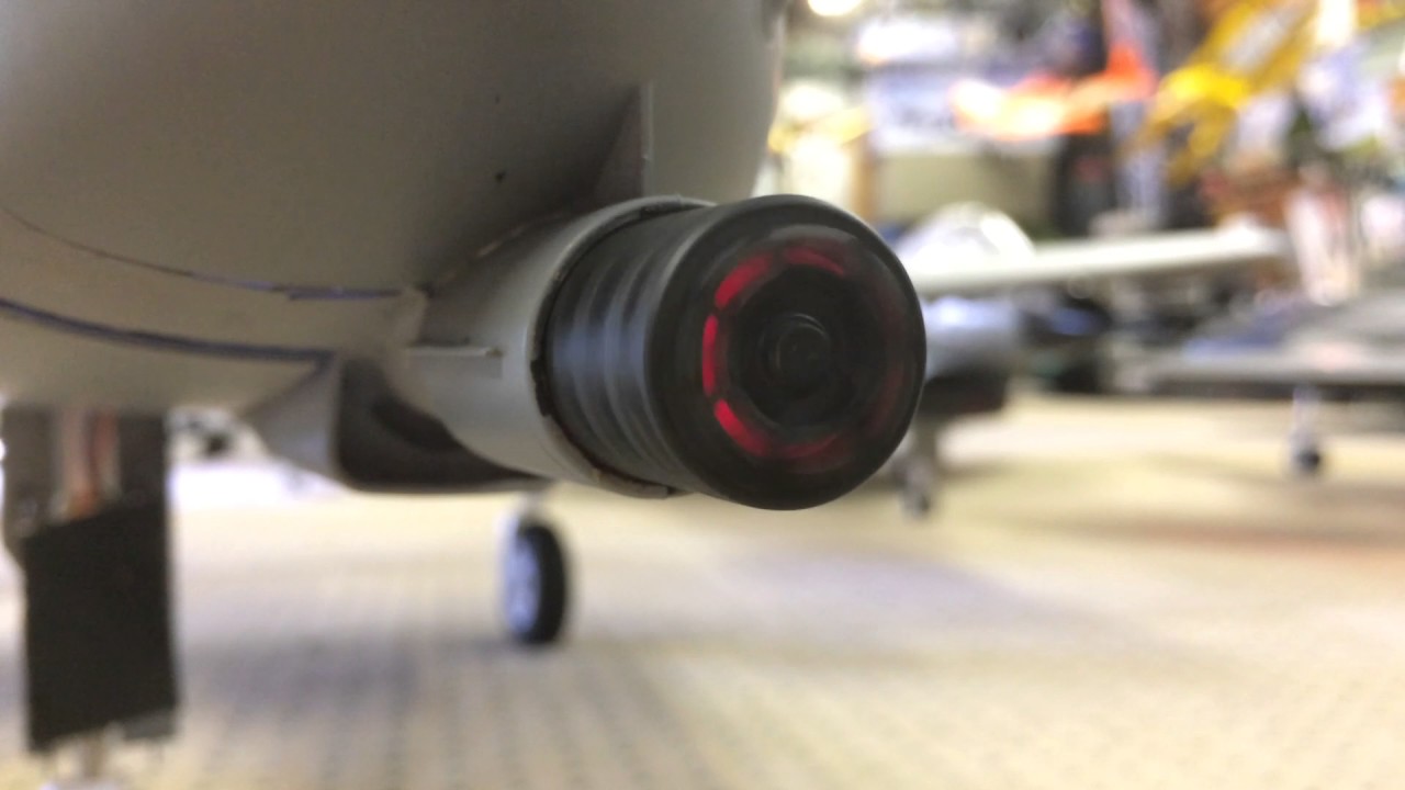

          Here's the cannon mod, used an LX retract motor, some clear red Lexan tube, a Freewing P-51 LED controller and a cardboard tube a drill bit came in to make a rotating "lit-up" cannon.

                                        TiredIronGRB That cannon is awesome!!! The only suggestion I would give is to have used Hi output LCDs in white. 7000cl range. I use them on all my planes and you can see them in direct sunlight. The red led not so much.
                                          #340
                                          The LED is white but shines through the the red tube, the LED is back in the fuse.
