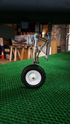

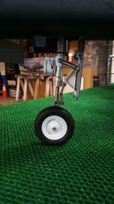

    I noticed an issue with the nose gear after doing some taxi tests today. It is possible for the scissor links on the back of the strut to hyper-extend and lock up.
    Click image for larger version  Name:	20170529_235222.jpg Views:	1 Size:	18.7 KB ID:	78229
    I loosened the set screw just above the tire and found that the strut was not bottomed out all the way. I bottomed it out and tightened the set screw and it can no longer hyper-extend now. It is worth checking when everyone starts getting theirs.

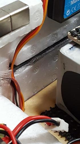

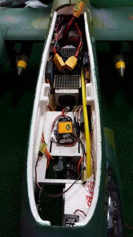

                                I just got done going back and adding some 5mm square carbon fiber tubes inside the fuselage to strengthen it. There are chanels already molded into the inner walls of the fuse on each side and I just ran a bead of Foam Tac into the chanels and pressed the rods in place. I am doing this to strengthen the fuse because of the weight I am carrying and based on input from Captin Mike and Pilot Ryan. It might not be a bad idea to go ahead and do it on your own planes as well just in case. It certainly can't hurt and it is super easy to do.

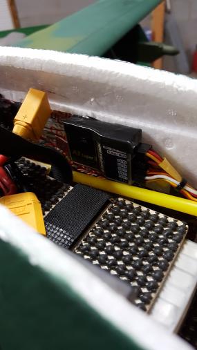

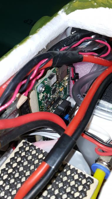

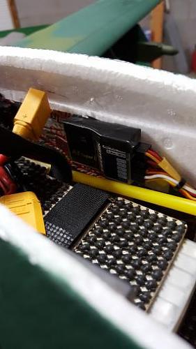

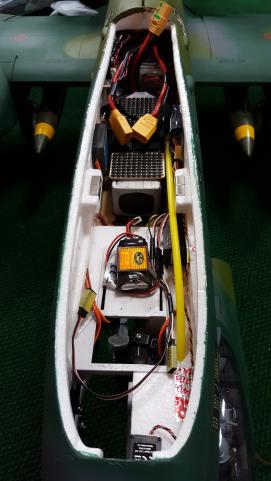

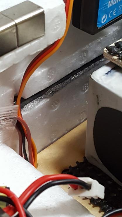

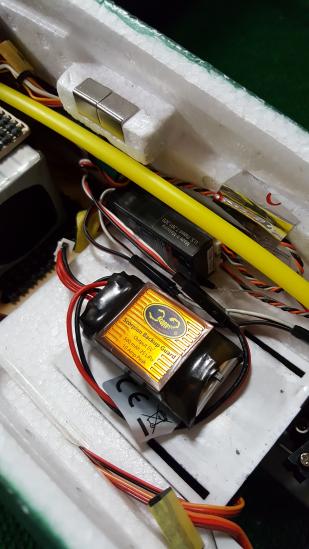

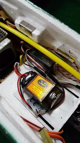

                                    My radio and electronics installation with the upper battery removed.
                                    Click image for larger version  Name:	14961988511651676950543.jpg Views:	1 Size:	23.4 KB ID:	78375
                                    I mounted an A3 Super II gyro here because I had it lying around.
                                    Click image for larger version  Name:	14961990261131236050755.jpg Views:	1 Size:	23.7 KB ID:	78376

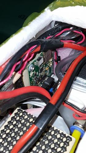

                                    Receiver and Scorpion here...
                                    Click image for larger version  Name:	149619908655812841169.jpg Views:	1 Size:	32.9 KB ID:	78377
                                    Shockwave2 sound card here. The card is mounted to a couple pieces of 1/8" ply and servo taped to the wall.
                                    Click image for larger version  Name:	1496199159425286507271.jpg Views:	1 Size:	50.0 KB ID:	78378

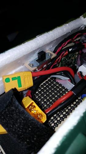

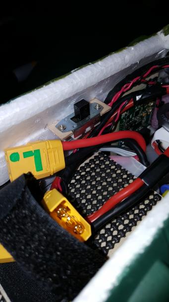

                                    This is the switch to turn power on or off to the sound card.
                                        Am quite interested in what the input from Mike and Ryan was. It's one of those "ounce of prevention" things.
                                          #180
                                          For me, because my weight is at the upper end they thought it might be just that in case I had a harder than desired landing (who me?). The channels are in there and great for wiring runs but can also be used to help strengthen the fuse if desired. I don't think it is necessary on a stock setup but sometimes people start out stock and then get "mod fever" and it is easier to install them before making any significant mods obviously. Or if someone desires to add bigger heavier batteries that puts their weight up around mine.
