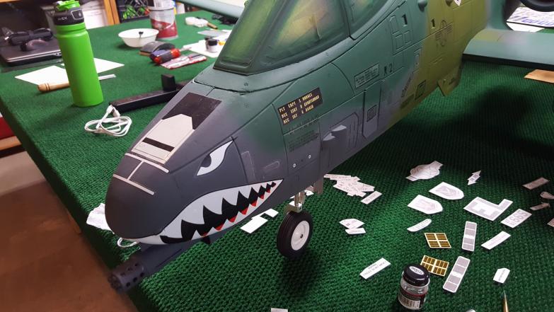

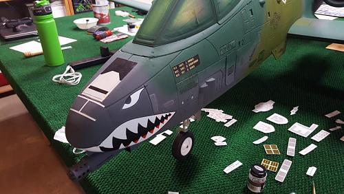

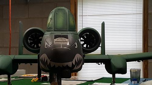

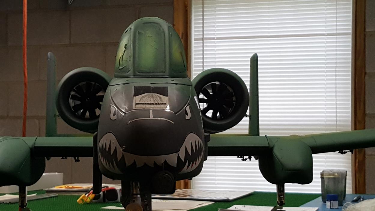

    With the decals going on I wanted to take just a moment to comment on them. The decals that come in the box are a combination of water slide and vinyl. The nose art decals are water slide and get applied to a compound curve. Needless to say they are not very flexible and if you have never used WS decals before you could be in for a frustrating experience. I applied the Tiger Shark decals for my subject livery and had to trial fit them to the best of my abilities to pre-trim them to fit around the gun. If you take your time you will get it just like I did but I had to also cut the decals into sections or slit them to overlap. The goal her being no wrinkles.
    Click image for larger version  Name:	20170521_155349.jpg Views:	1 Size:	91.0 KB ID:	77075
    The vinyl decals can be trimmed and slit to fit contours as well. Most all of the text and detail decals are a dark gray, almost black color which unfortunately rendered then invisible against the darker colors of my particular scheme so I ended up using a combination of decals from the kit, some I made myself and some from Callie Graphics. I had to make the 'I' just ahead of the refueling port because Callie's was way too big and the one that came in the box was not the right style for my model. I also made my own refueling port
    Click image for larger version  Name:	20170521_014631.jpg Views:	1 Size:	63.5 KB ID:	77076
    Overall the paint stuck very well that I applied directly to the original gray paint. I do think wiping it down with alcohol helped and being very careful to keep my bare fingers off of it during the process. Wearing Nytrile gloves if you do have to handle it makes a huge difference. So far I am liking how this is turning out.

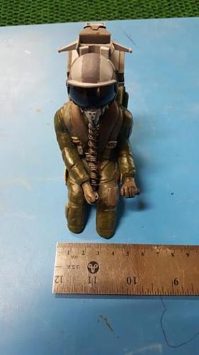

                      hey dude, loving your work so far..very inspiring. Now that youve been working on the cockpit, wonder if you could tell me if this figure might work in this plane? not sure how much room is in there

                            Let me get some dimensions off of mine to compare and get back to you but it looks like the 1/10 figure might work fine. They all look decidedly "British" and very real.
                                thankyou, I appreciate that. yes, I think with a little work they will look great. The painted samples on their site dont do them justice at all.

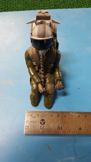

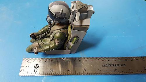

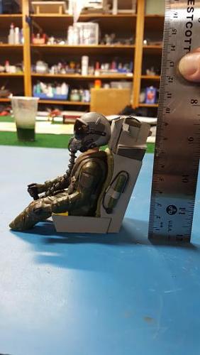

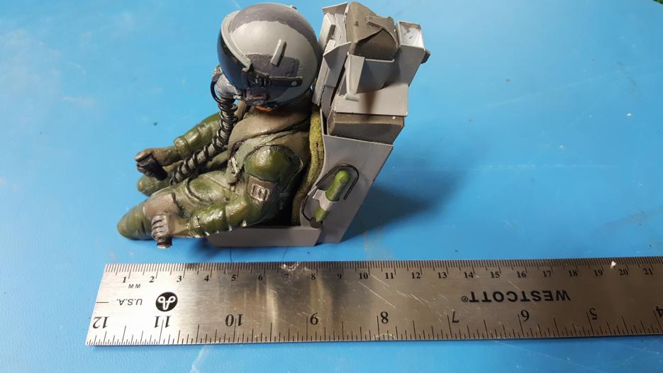

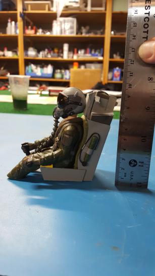

                                  Here are some size shots of mine against a ruler.
                                  Click image for larger version  Name:	20170523_130226.jpg Views:	1 Size:	19.1 KB ID:	77299
                                  Click image for larger version  Name:	20170523_130134.jpg Views:	1 Size:	51.0 KB ID:	77300
                                  Click image for larger version  Name:	20170523_130052.jpg Views:	1 Size:	24.4 KB ID:	77301
                                  If you cut some of the bottom of their seat off you could set it lower. Notice that my seat is not full depth.

                                    thankyou sir, looks like it'll fit just fine.

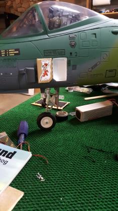

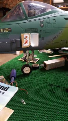

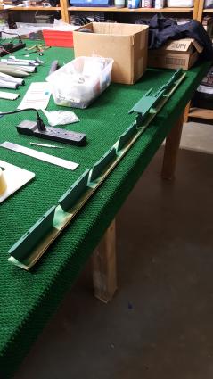

                                      I've run into a little bit of a snag.The GT POWER gear door sequencer I got does not seem to be working like it should. I have tried everything I can think of to no avail. I will contact Motion tomorrow about it. In the mean time I went ahead and painted the hard points and detailed the inside of the ladder door.

                                      I still need to paint the inside of the ladder box and of course build the ladder.

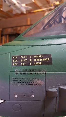

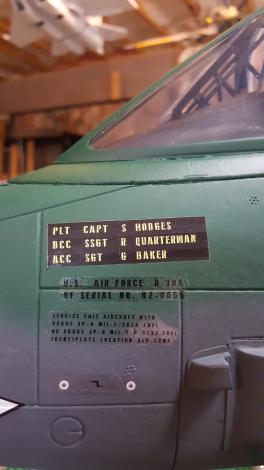

                                      Notice this little detail? My DCC or Dedicated Crew Chief is a buddy I fly with at our local club named Randy Quarterman and the ACC or Air Combat Command I believe is our own George Baker or TIGRB who is another buddy I fly with in Tennessee. Of course I am the pilot.
