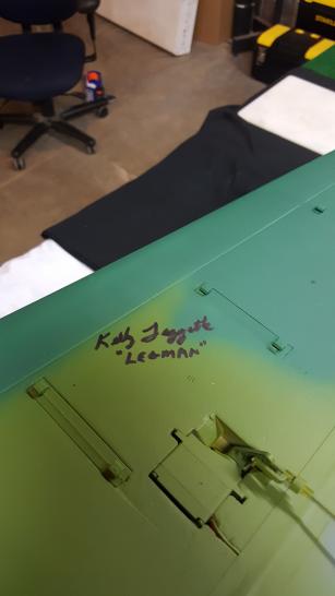

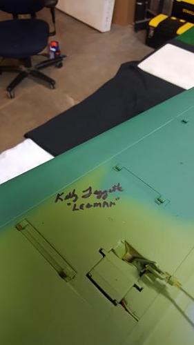

      Hey Alpha, thanks for chiming in. Yes, once I get these mods complete I would love to add the additional detail of the adapter rails and TER's. There is so much that can be done. I was impressed with how Kelly's flew. Even the sound was impressive in person. You and your team did an outstanding job designing this bird and I am excited to fly mine soon.
      Gotta get the paint finished first though.
      Kelly's autograph...

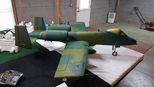

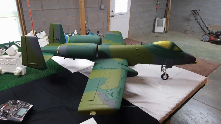

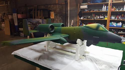

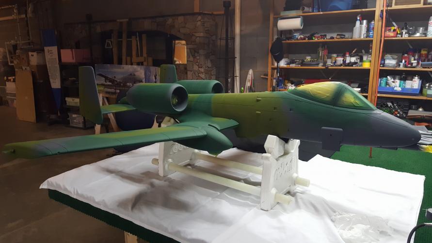

            I am calling the paint done! On to decals, weathering and then a clear coat.
            Weathering will darken the colors a bit and the decals will make it pop...

              Looks incredible- well done! Steve, I was just looking at the Parkflyer servo fairings I have on hand and remembered even the large ones are only ~10mm high which may not work on the A-10. In the past I've used these- the middle ones are ~13mm high.
                Bring it over and let's maiden it!
                  #88
                  Gorgeous paint job Steve! Looking forward to seeing the final result.
                    #89
                    Tom
                    If you trimmed the servo arms down I think they could work.
                      #90
                      I wish George. Not just yet. ;)
                        #91
                        Thanks Pat. I'm a sucker for camo. I'm anxious to get the decals on it.

                          #92
                          Awesome work, the camo job looks fantastic! I am amazed at how fast you have done all these mods! I still have repaint projects that have been on the shelf for months, and you've done four times more inside of a week!

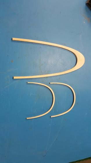

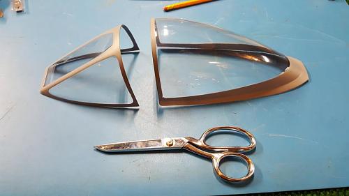

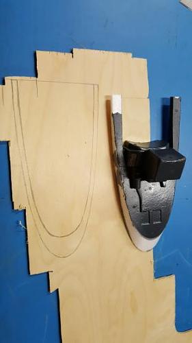

                                  Canopy/cockpit mods (continued from post #76 and next installment is post #194)

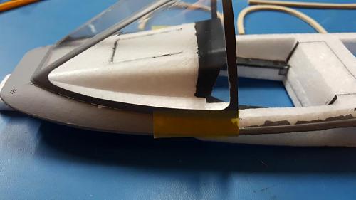

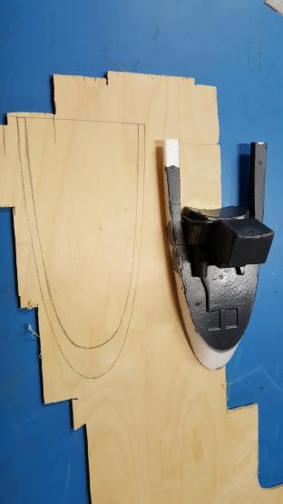

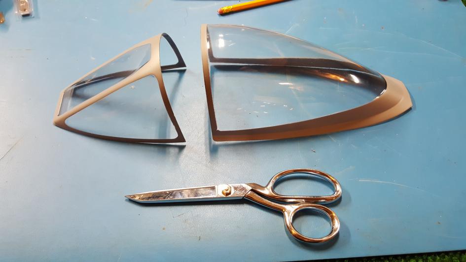

                                  Still trying to get caught up on this part of the build. For all the changes I made where I needed to add material I would make templates out of poster board to ensure a part would fit before I even cut it. Once I had the cockpit the right size and shape and the instrument panels fitting the way I wanted I then set to work on separating the front and back sections of the canopy and making the frame members from 1/8" plywood. I used the section of the canopy deck I removed earlier to help determine the size and shape of the sill plate.
                                  Click image for larger version  Name:	20170504_223948.jpg Views:	1 Size:	16.1 KB ID:	76739
                                  Click image for larger version  Name:	20170504_225731.jpg Views:	1 Size:	45.5 KB ID:	76740

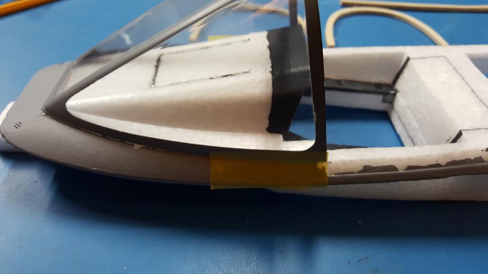

                                  I temporarily taped the front canopy section in place which allowed me to trace around the canopy onto some poster board to make the template for the windshield frame. Once drawn I cut it out and folded it in half vertically to determine that it was symmetrical.
                                  Click image for larger version  Name:	20170504_231738.jpg Views:	1 Size:	42.8 KB ID:	76741

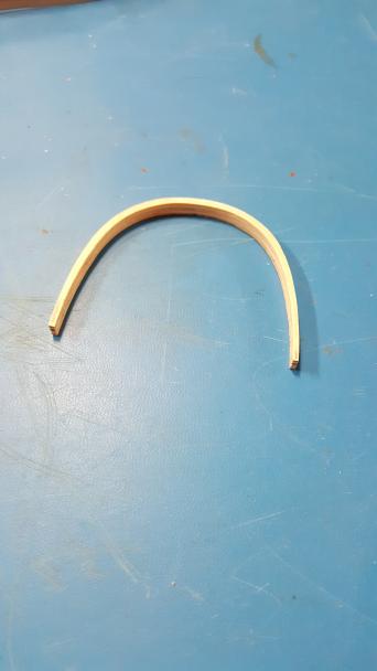

                                  I made two of these frames exactly the same size and shape by using the tiniest amount of medium CA to tack them together in three spots. This allowed me to sand them on my belt sander and with my Dremel to be identical and the pop them apart.
                                  Click image for larger version  Name:	20170505_223358.jpg Views:	1 Size:	14.7 KB ID:	76742
                                  The frame parts ready to go.
                                  Click image for larger version  Name:	20170505_224414.jpg Views:	1 Size:	12.4 KB ID:	76743
                                  Next up will be the raising mechanism...

                                          I just received from Kelly the shot of him signing my wing at the Nall. Thank you again sir.
