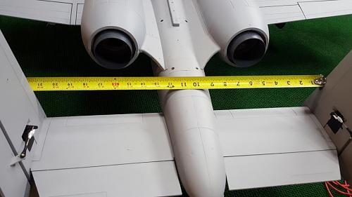

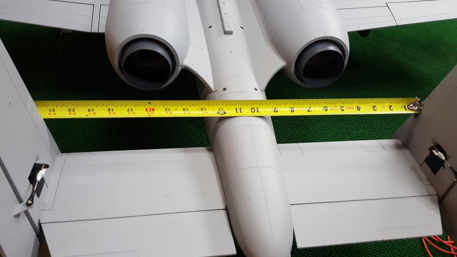

          I hate to bother you with this, but if you have time, can you measure the horizontal stabilizer (not including the vertical stabilizers)? I'm hanging up mounts and looking to see if the distance is the studs in the wall (16 inches apart) is perfect, or if I need to go much more narrow and go through the drywall on one of the hangars. Thanks!
          • #25
            No bother at all T-CAT. Looks like it's 21" between the vertical stabilizers. Is that what you needed to know?

              Here is a quick video of the sound system, taxiing through my basement and the canopy opening.
              • #27
                Thanks a ton RCjetdude. That's exactly what I wanted/needed to know. That helps me tons. Thanks again!
