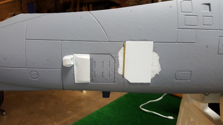

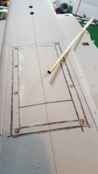

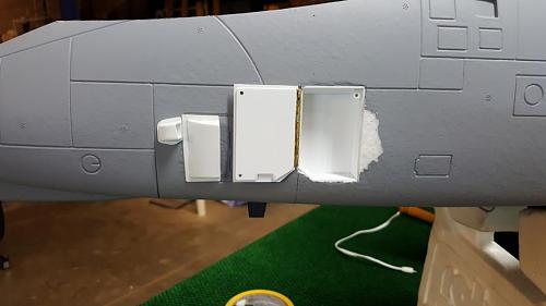

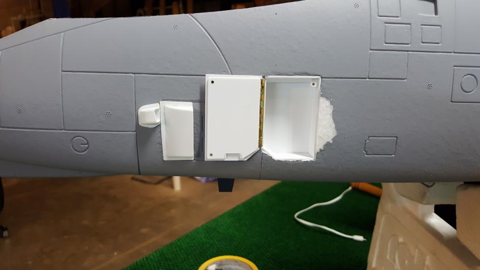

          The last bit of exterior detail I had to complete before painting is now done. No ladder yet but the box and door are made as well as the vent covers just ahead of it. Paint goes on tomorrow.

            How deep is your ladder pocket? Did it intrude into the interior space or just embedded in the foam. 3D printed box?
              #46
              I made the side walls 14mm deep as my upper tube has a 10mm OD and then I will add a small section of styrene tube to secure the top of it inside the box. Also, the door has a plate on the inside of it which is 0.040" thick so I SWAG'ed 14mm deep. It is completely hand-made from 0.020" and 0.040" Styrene sheet. The only part of the interior it intruded into was a wire routing channel molded inside the fuse. I wish I had a 3D printer. The piano hinge I got from Micro Mark and the smallest one I could find. There are a couple tiny magnets I got off of ebay embedded in the corners of the door. There is only one magnet at this time in the upper right corner of the box to hold the door shut and it works pretty good.

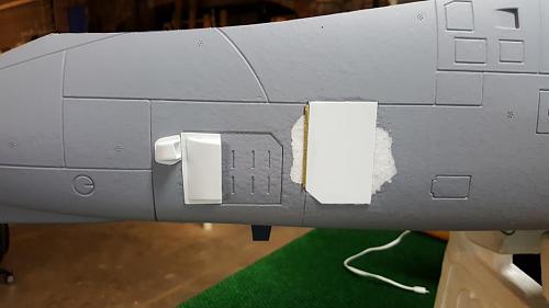

                  That's some crazy detail work on the ladder cabinet Steve, awesome craftsmanship!

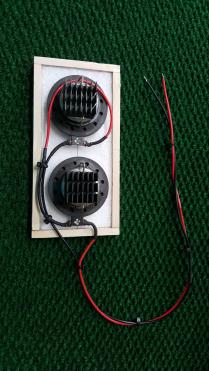

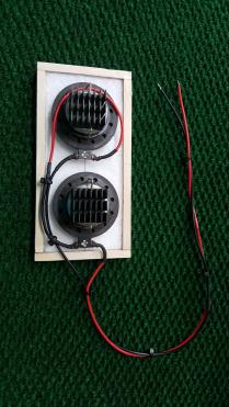

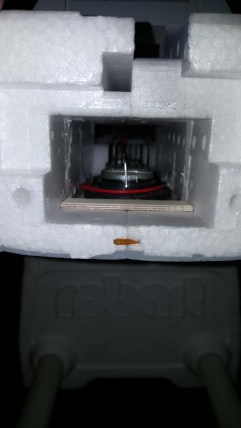

                      I have been playing with the sound file trying to get more sound pressure out of it and reducing the duration of the pauses. Both TT-25 speakers are mounted in the belly of the plane so the sound projects down and may behave differently off the concrete floor as well. Sound is a tough thing to deal with.

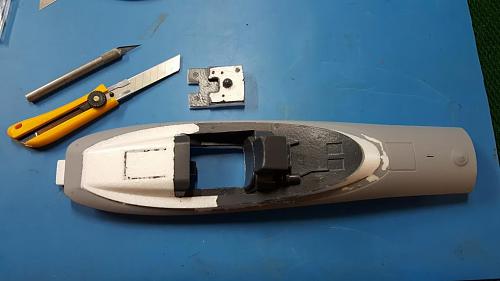

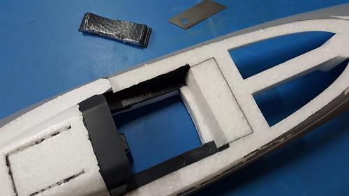

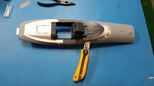

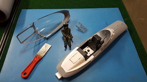

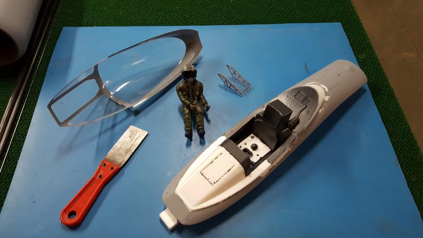

                        Canopy/cockpit mods (next installment on post #76)

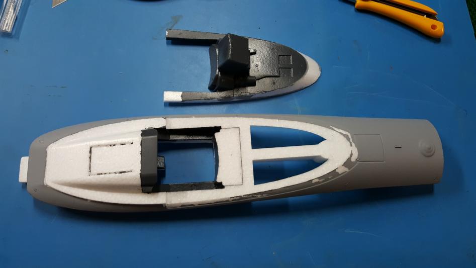

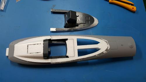

                        OK, Here is a little on what I did to modify the canopy to open add some more scale realism to the cockpit. The paint on the cockpit was quite thick on mine but none the less I wanted to cover it with styrene to eliminate any possibility of "gatoring". I also wanted the canopy to open and close on a servo and to have a semi-scale ejection seat that would hold the JHH 1/10th scale pilot I had ordered and painted up some time back. The first thing of course was to remove the canopy which really only required sliding a flat dull blade under the edge to lift it and worked my way around. Pretty straight forward. I used a metal spatula.
                        Click image for larger version  Name:	20170504_213725.jpg Views:	1 Size:	48.4 KB ID:	76166

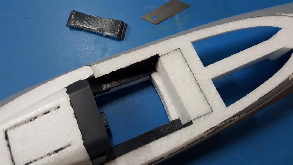

                        Of course some of the paint lifted from the foam, especially where it was so thick up front. The original pilot is held in place with a screw and easily removed.
                        So I began cutting foam starting with removing the seat/floor...
                        Click image for larger version  Name:	20170504_215441.jpg Views:	1 Size:	45.9 KB ID:	76167

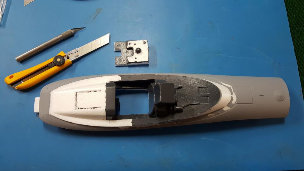

                        and then the deck aft of the seat.
                        Click image for larger version  Name:	20170504_220228.jpg Views:	1 Size:	37.8 KB ID:	76168
                        Click image for larger version  Name:	20170504_220330.jpg Views:	1 Size:	38.5 KB ID:	76169

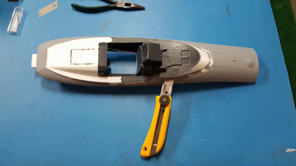

                        And I just kept cutting...
                        Click image for larger version  Name:	20170504_221102.jpg Views:	1 Size:	49.6 KB ID:	76170
                        To be continued....

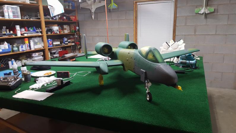

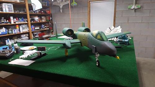

                            #53

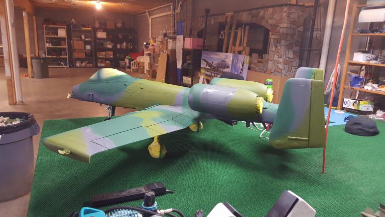

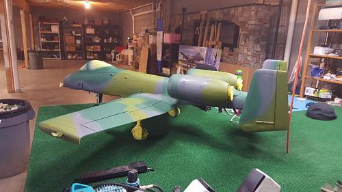

                            Ha! Good one T-CAT. No I am not a surgeon but I do claim to be a foam smith. I love working with foam. Got some paint on it this evening. Still not ready to un-mask it but it may be good enough to get legman01 to sign it at the Nall. The artificial light in my basement exaggerates the colors in the pics. Time for bed.
