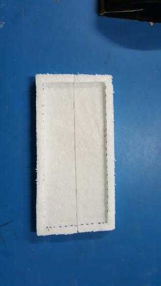

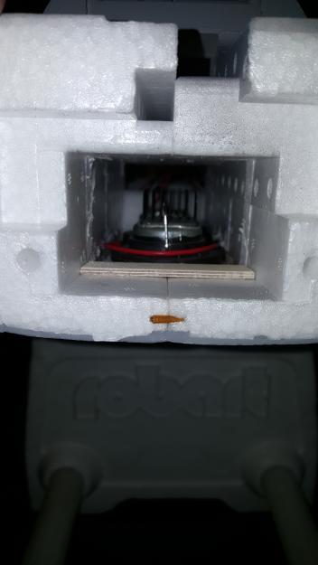

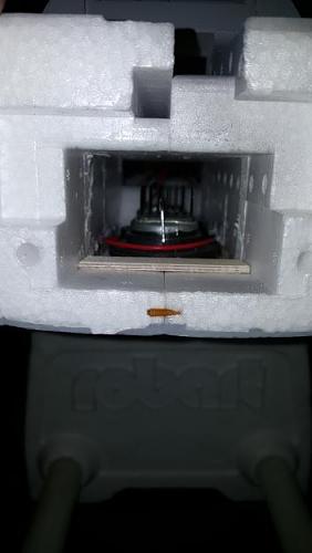

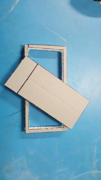

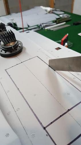

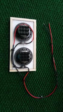

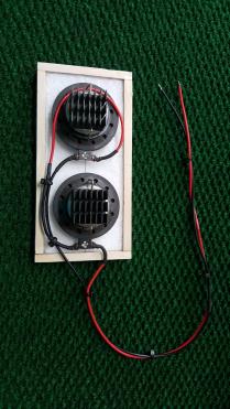

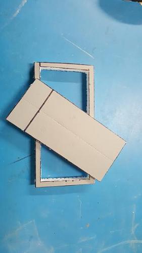

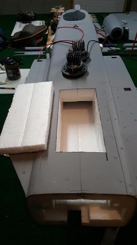

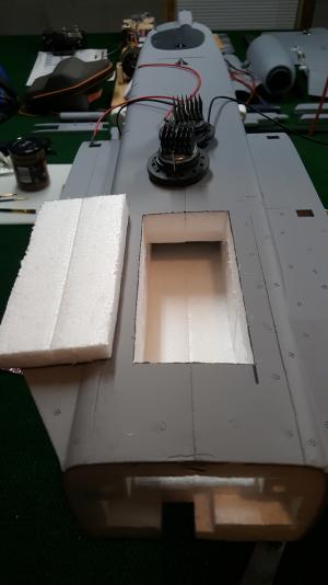

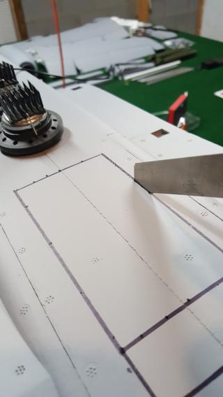

        Hey Brent, I used two of the TT-25 speakers in series to make 8 ohms. The Shockwave2 requires 8 ohms on 6S. I did take advantage of trial fitting the speakers before gluing the fuselage together but I don't think it is necessary. I cut a hatch in the bottom and framed it with strips of 1/8" plywood. Not having the back of the fuse glued on did help with knowing where to cut though.

        Hey Dude, where do I get those heat sinks for the speakers? Thanks
        • These should work
          • Thanks Dude. Bought them. Do you use one on the motherboard?
            • Originally posted by Warthog View Post
              No. Just the transducers after I had two of them fail on a Corsair using an Aspire system.
              • Ok. Thanks a lot Dude. Can't wait to hear this system in action. I watched your you-tube video of the system on the test board. Really loud!!! Love it.
                • Hey Dude, I just watched the video of your BAD ASS A-10 when you taxied up and down your street. Was there much difference in sound between the test bench and that video? I know you were using the 4" speakers on the bench and the 2" exciters in the bird.
                  • I noticed no real difference.
                    • How thin did you make the bottom foam where you mounted the exciters?
                      • If I recall correctly it was around 1/4" or so.
                        • Ok. Thanks Dude. I'll let you know how it comes out. That smoke unit I made from an E-cigg works very well.

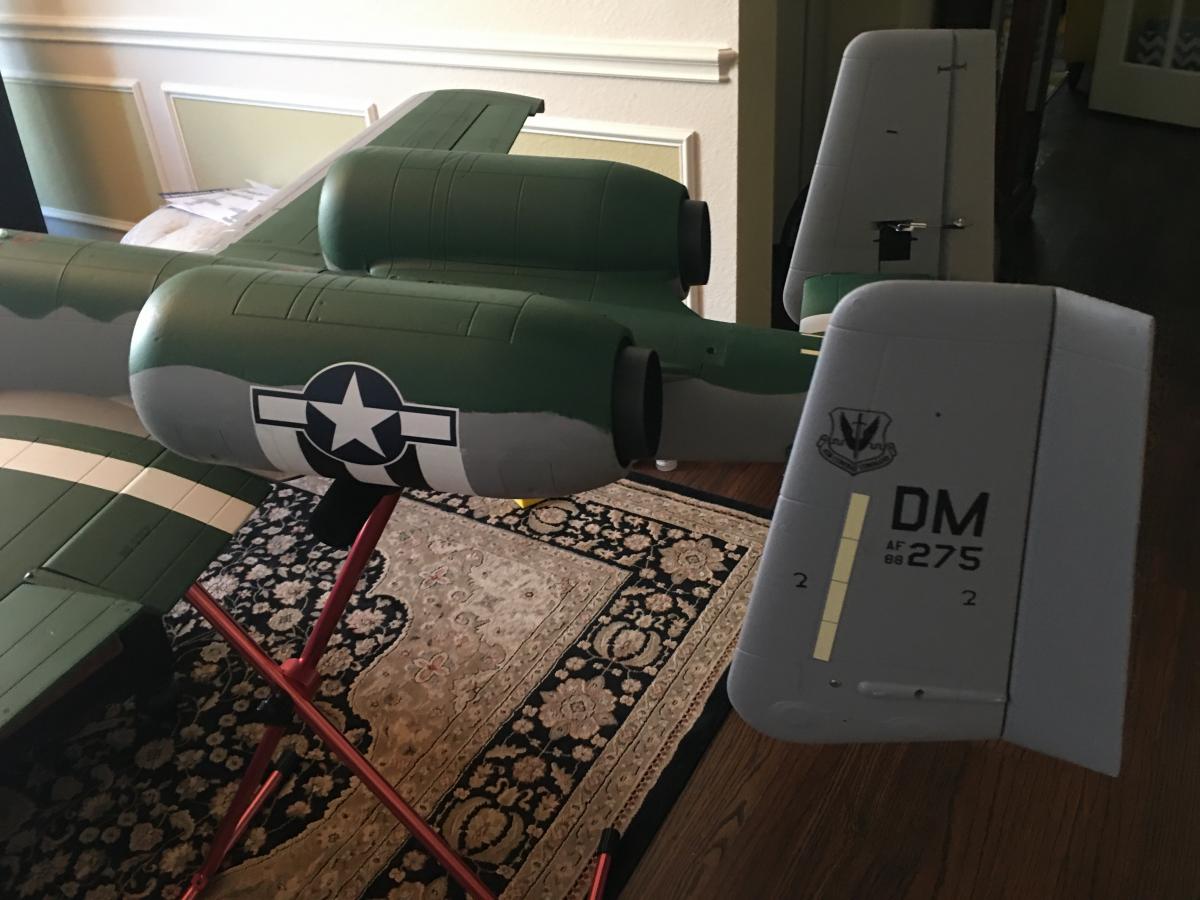

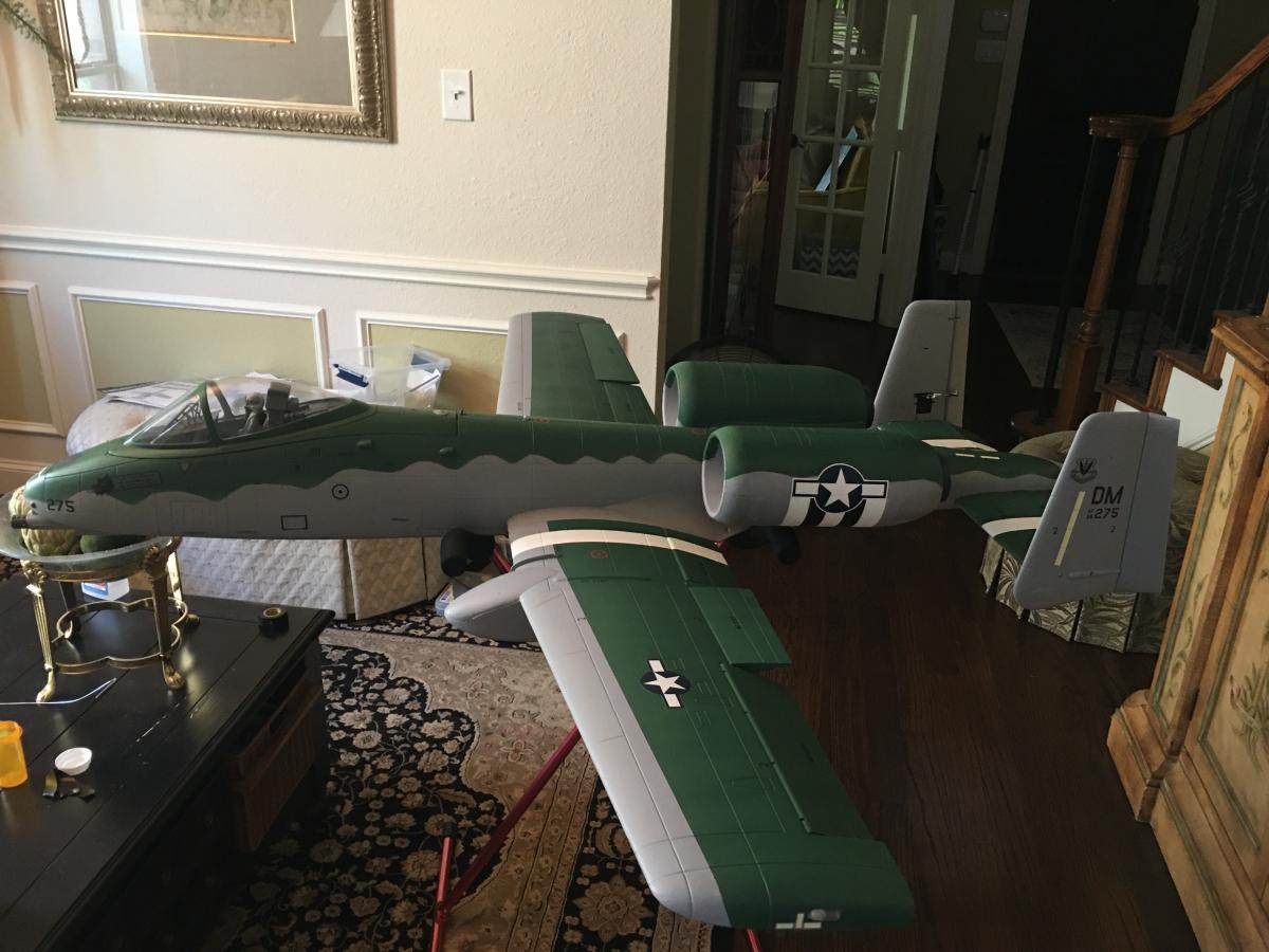

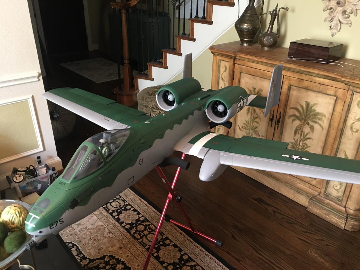

                          • My baby -- A-10 Demo Team Scheme
                            Click image for larger version  Name:	IMG_4940.JPEG Views:	0 Size:	233.4 KB ID:	267106
                            Click image for larger version  Name:	IMG_0179.JPG Views:	0 Size:	141.7 KB ID:	267102Click image for larger version  Name:	IMG_0180.JPG Views:	0 Size:	114.0 KB ID:	267100 Click image for larger version  Name:	image_59602.jpg Views:	2 Size:	108.6 KB ID:	267098Click image for larger version  Name:	image_59603.jpg Views:	3 Size:	126.9 KB ID:	267099
                            • Originally posted by waytooslow View Post
                              That's a wild AND good looking paint job!!
                                Very nice indeed. Love the stripes.
                                • Got a question for Jetdude. I'm installing the Shockwave system and wanted to know what type of glue you used to glue the foam panel to the wood frame where your exciters are. Do you think Foamtac would work, or should I use CA?
                                  Lots of vibration, and Foamtac is flexible.
