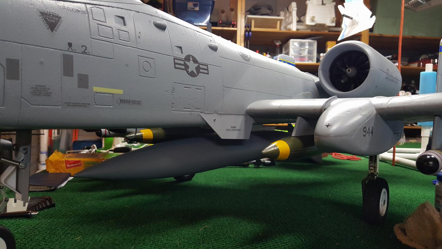

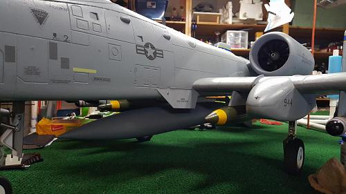

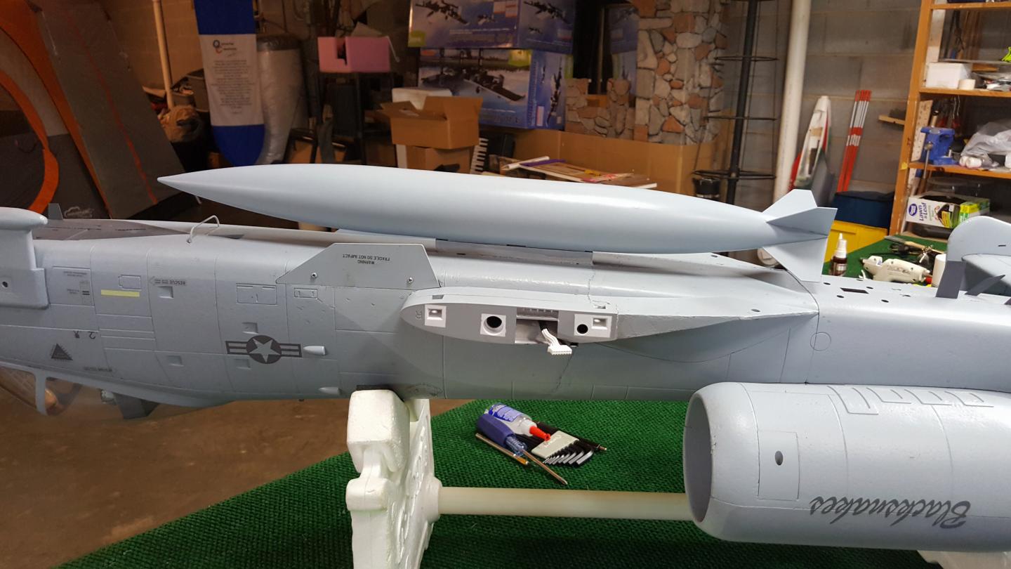

    Drop tank loosely attached to the belly of the gray A-10.
    Click image for larger version  Name:	20170813_234504.jpg Views:	1 Size:	129.7 KB ID:	92589

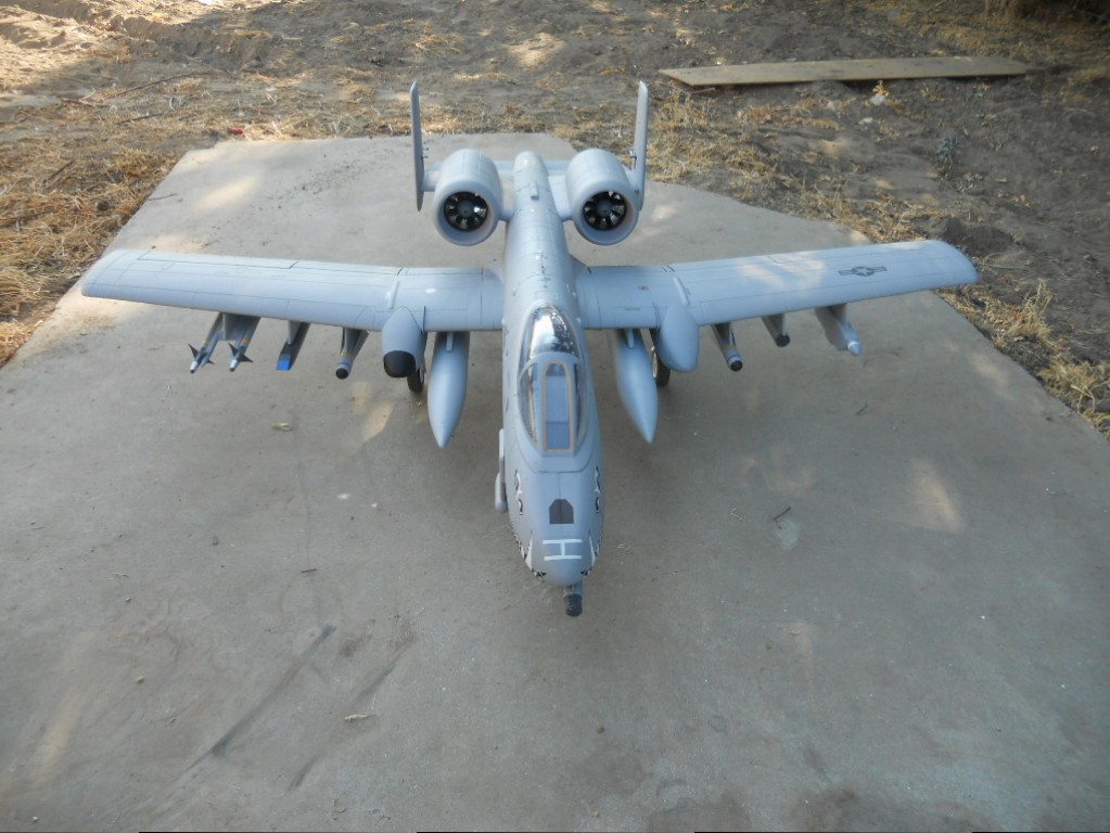

    I debated to do the one tank but went with two, yours looks great though, the A-10 actually had one tank like yours down the middle and some did have two tanks as well, I do like the one tank maybe better, oh well, you will like the looks of it when your in the air, my A-10 had no trouble with two so your one will be fine I'm sure.

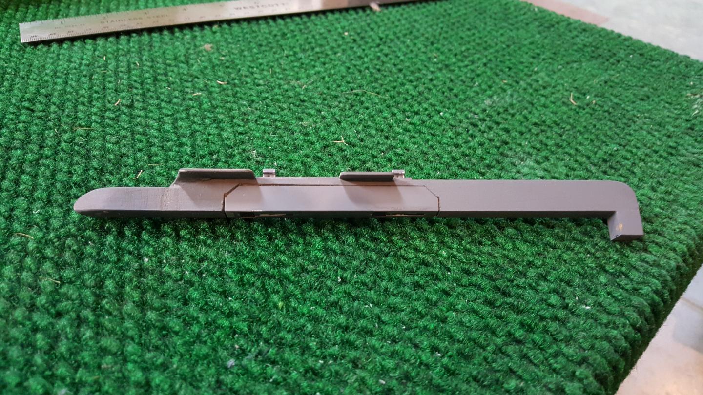

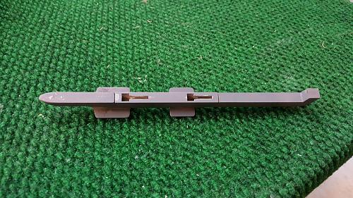

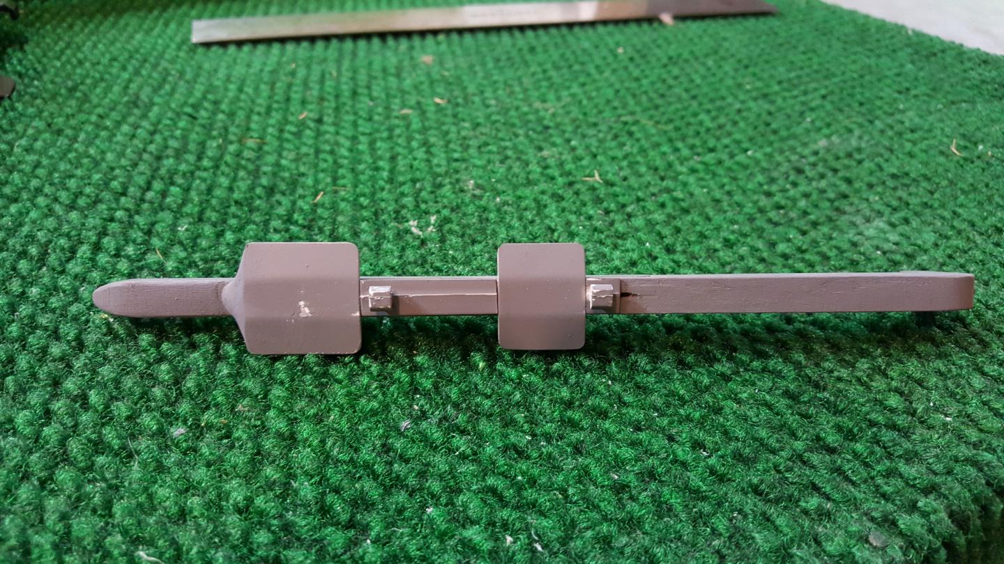

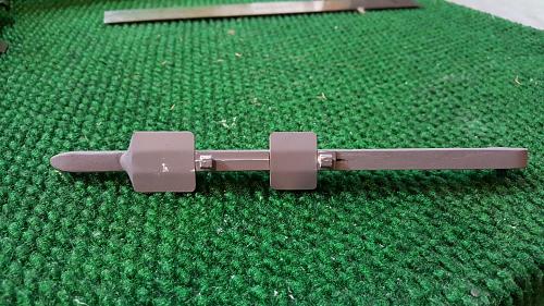

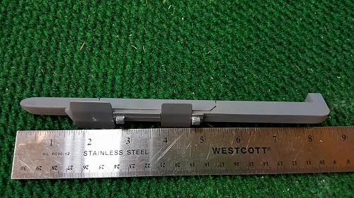

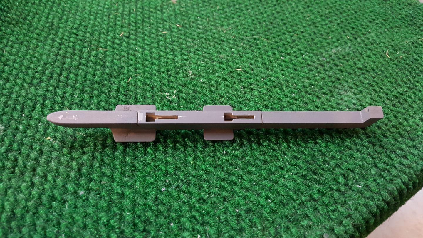

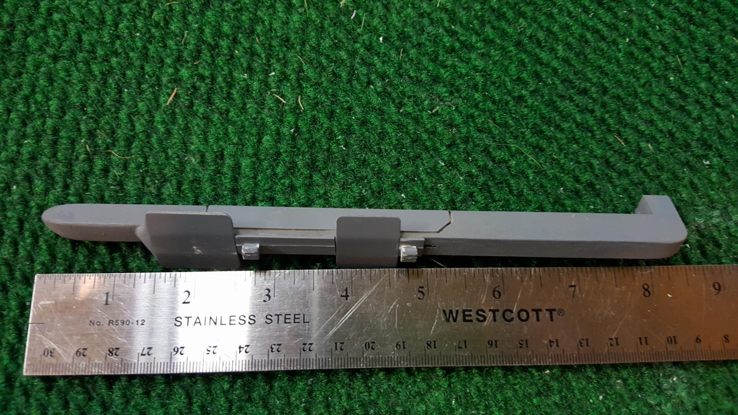

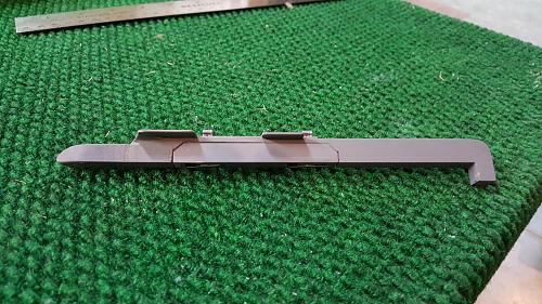

    Ok, my Maverick rails were made from 1/2" x 5/16" bass wood strips cut to 8-3/8" long. In the photos you can see how I cut down the front and where I added the styrene plates. The front of the bracket that holds the missile is located 2-1/8" from the front edge of the rail. The top mounting bracket it centered with the bottom one. I cut a grove with a Dremel cut-off disk down the center to secure the bracket. You need to remove material accordingly to fit the lower bracket. After the Top bracket was in place I used a razor saw to remove a section of it to be replaced by the styrene plate. The styrene plates I bent down slightly after gluing them on. I used Fix-it-stick plumbers epoxy putty to blend the front edge of the forward plate. I added a small block of Bass wood to the back of the rail and gave it a shot of gray auto primer.

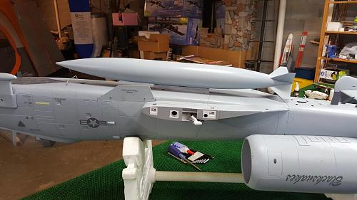

    Centerline tank is done. I hope to give it a try tomorrow.
