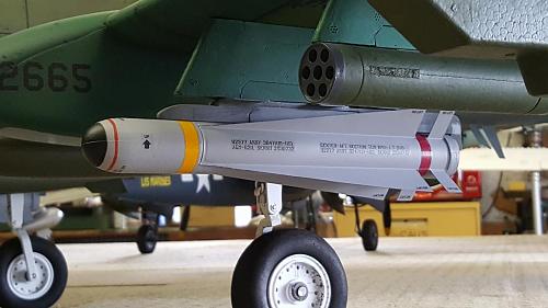

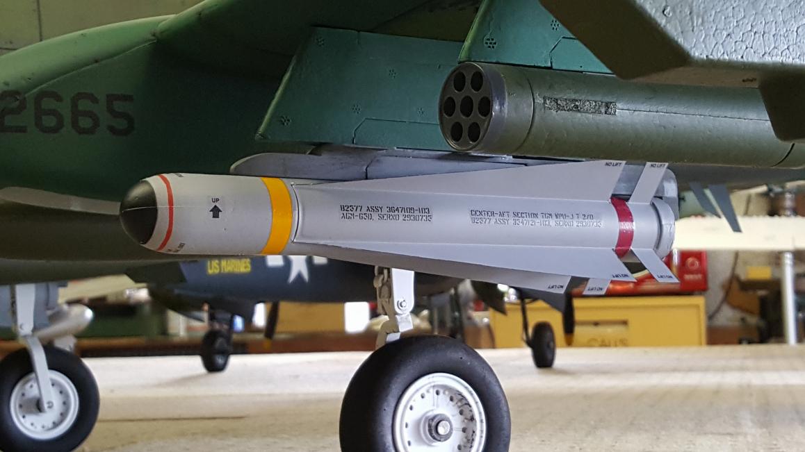

    I finally completed my Euro Green A-10. The finishing touches were crxmanpat's ordnance decals.
    I am posting a list of the things I did to it on the first page and will be getting back to the canopy mod to try and finish documenting it. Clearly it is one of the most striking features of the plane.
    Finished them off with some Stainless Steel paint.

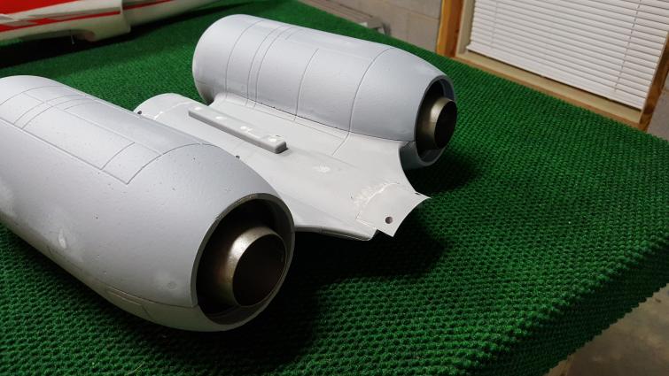

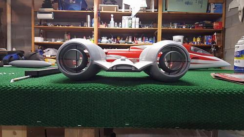

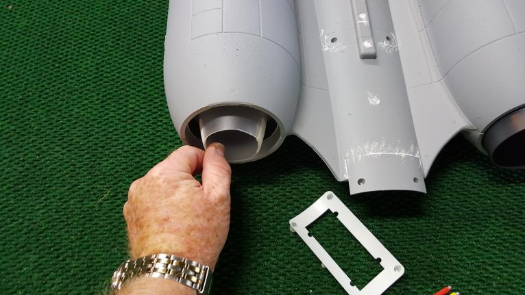

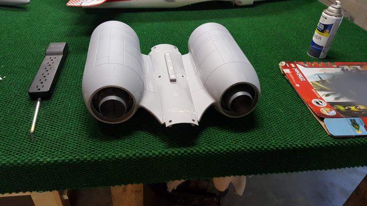

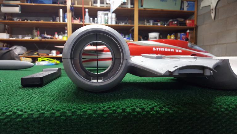

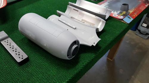

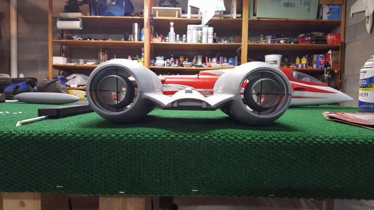

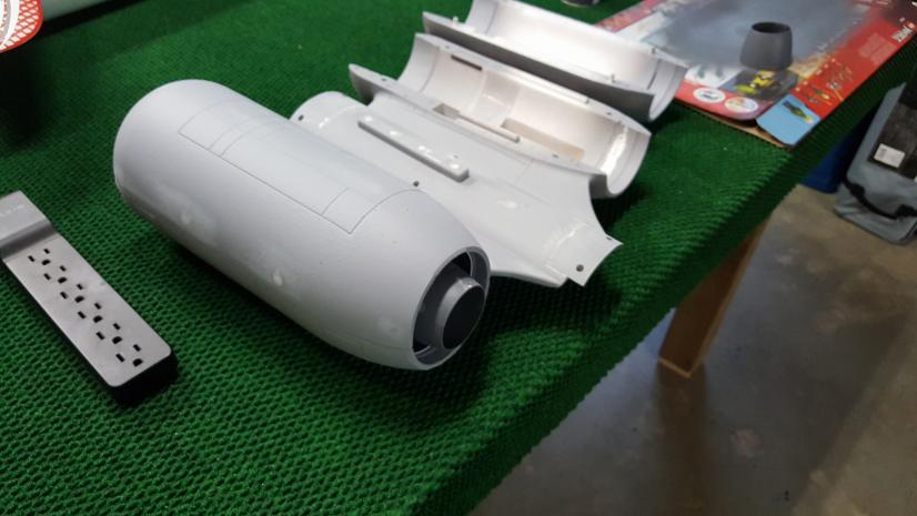

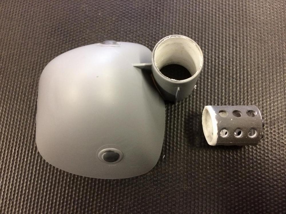

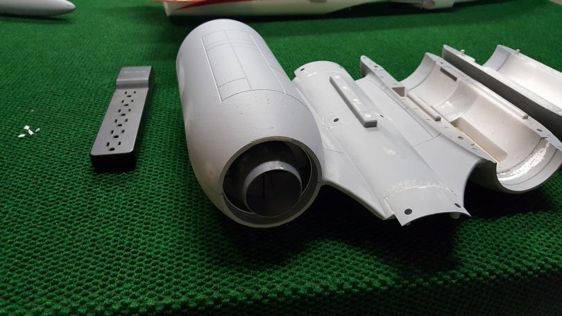

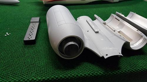

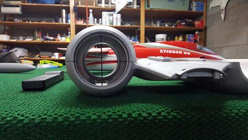

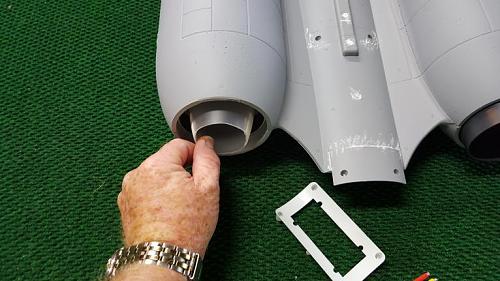

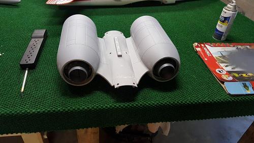

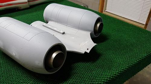

    90mm nacelles. Working on a more scale looking exhaust.
    Click image for larger version  Name:	20170625_195639.jpg Views:	1 Size:	57.9 KB ID:	83074
    Click image for larger version  Name:	20170625_195633.jpg Views:	1 Size:	48.0 KB ID:	83075

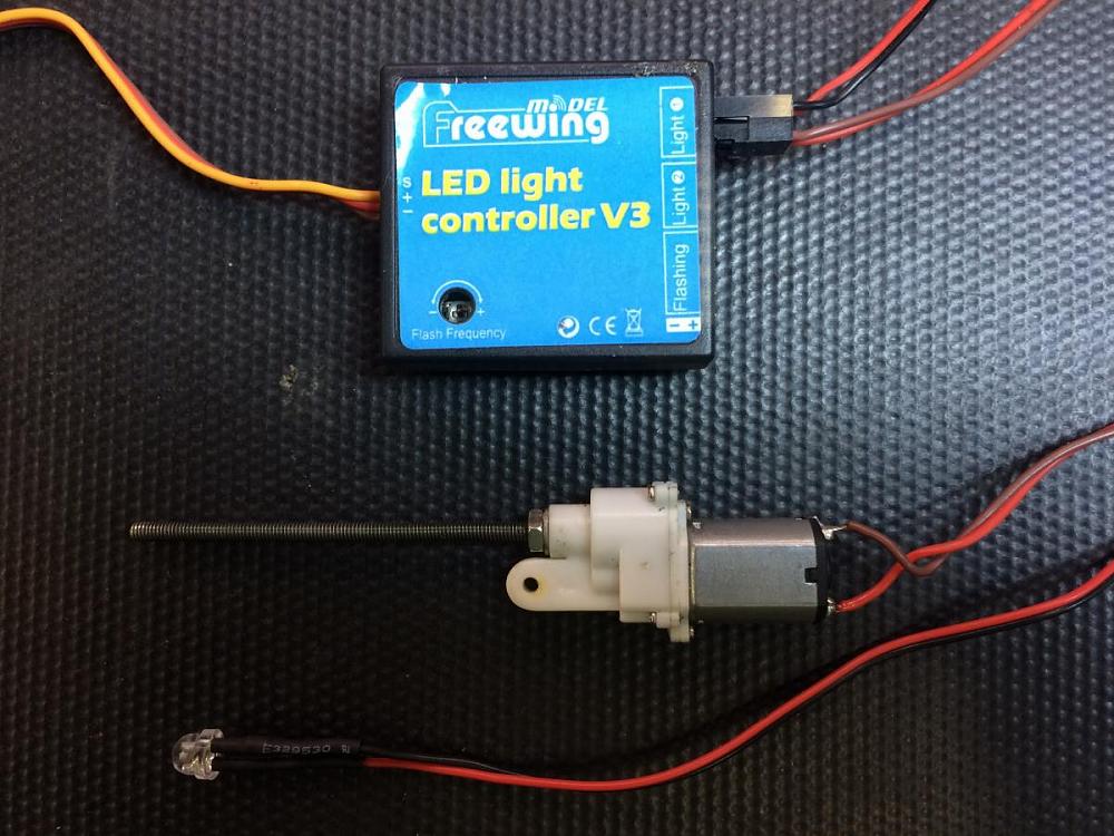

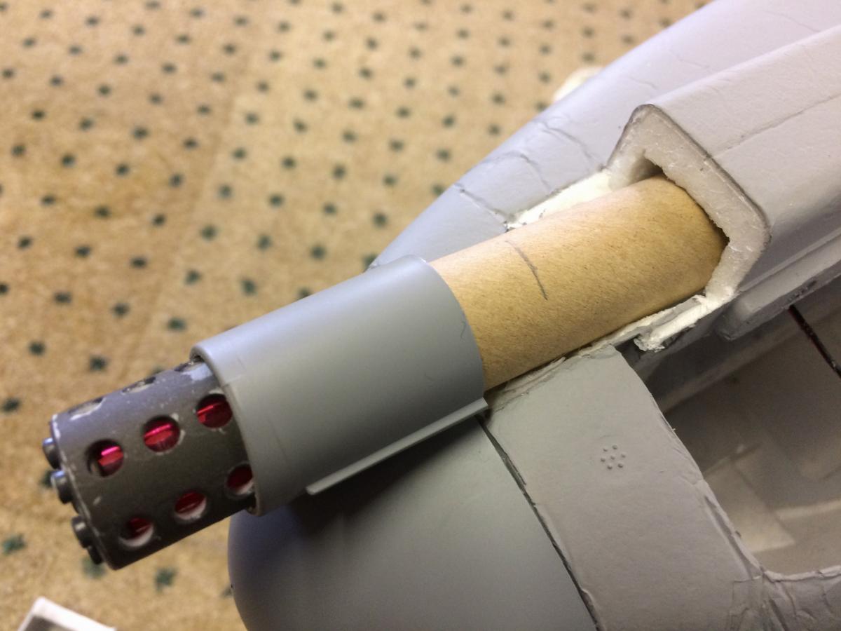

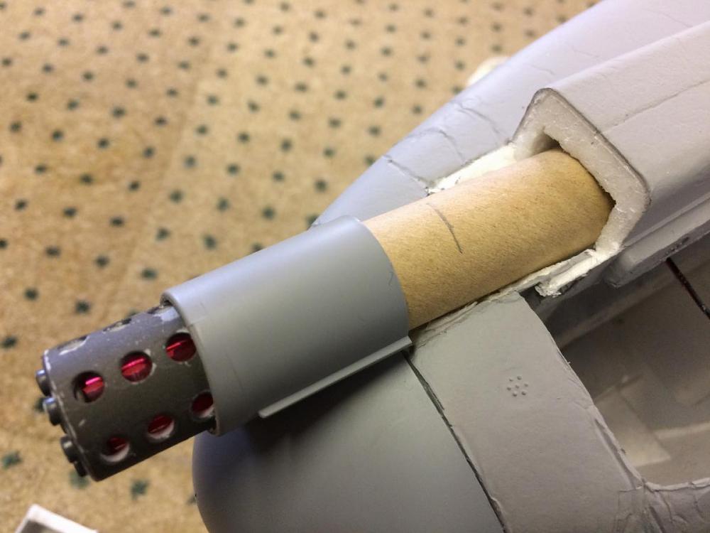

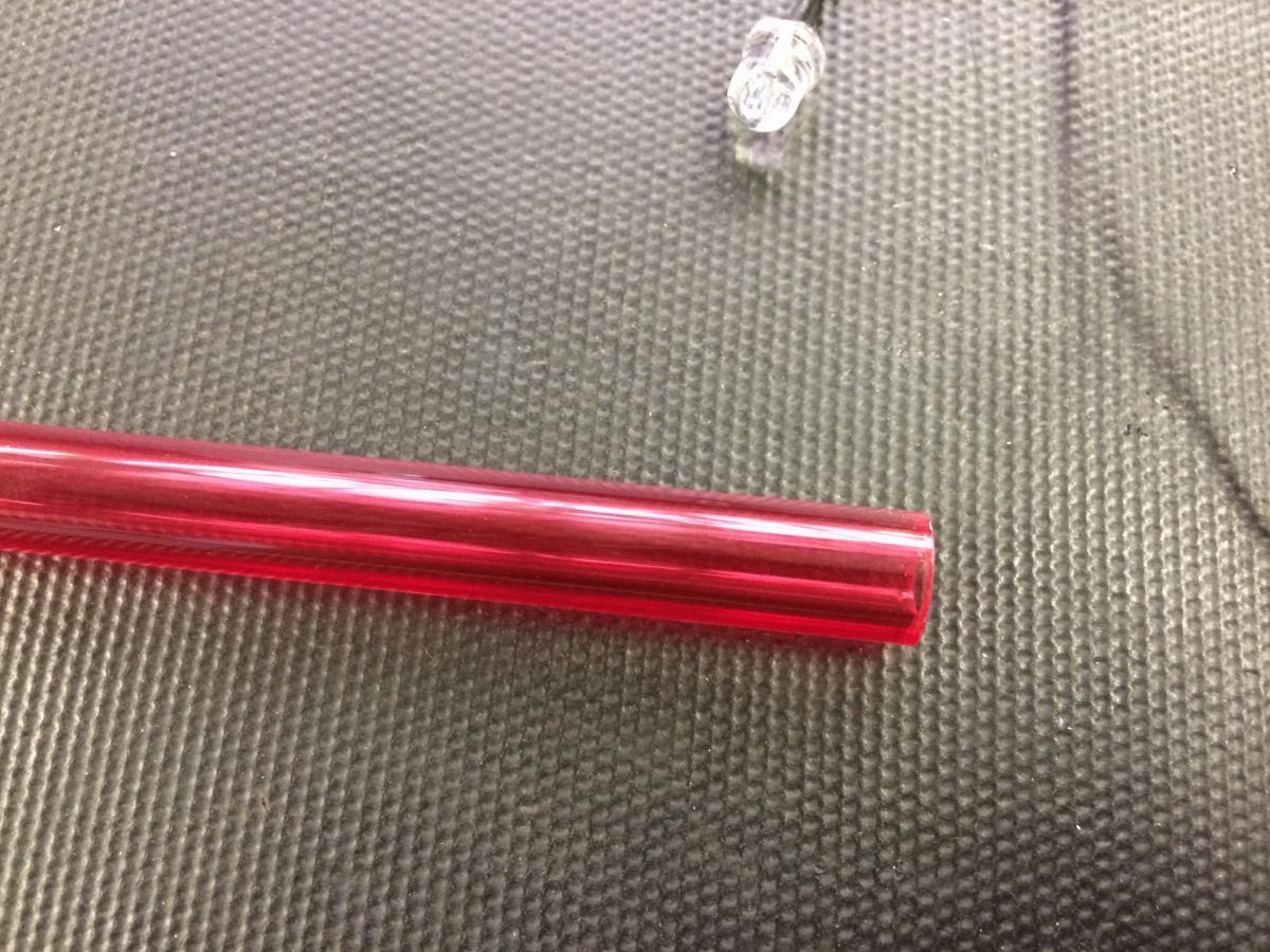

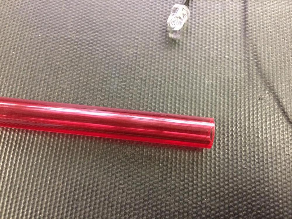

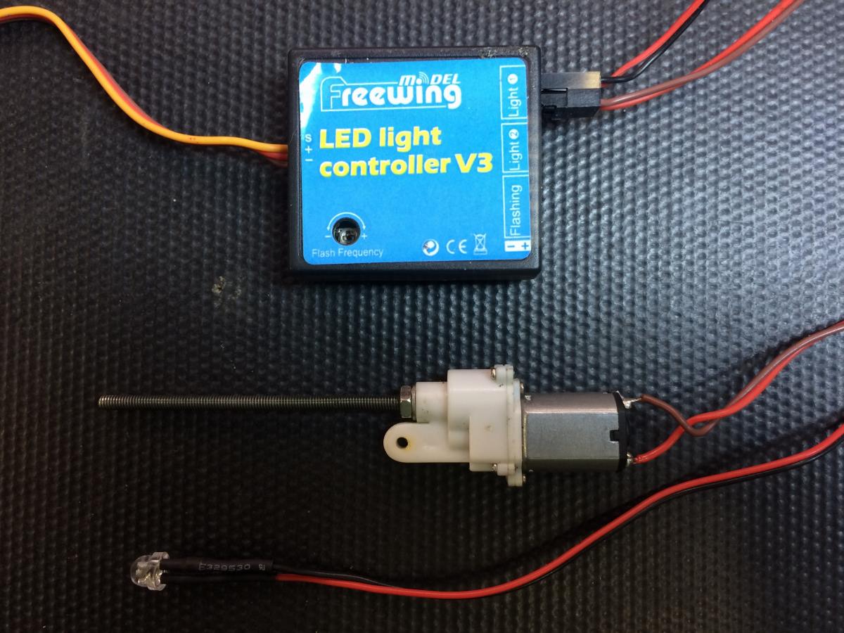

    Here's the cannon mod, used an LX retract motor, some clear red Lexan tube, a Freewing P-51 LED controller and a cardboard tube a drill bit came in to make a rotating "lit-up" cannon.

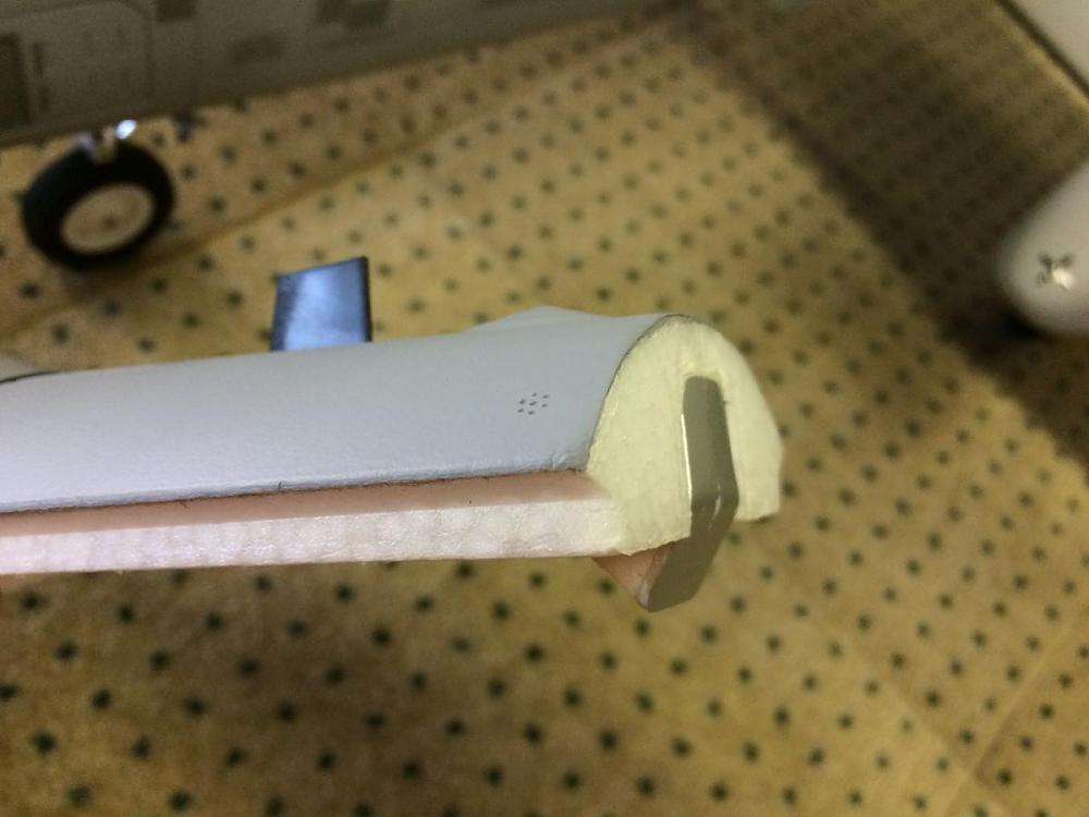

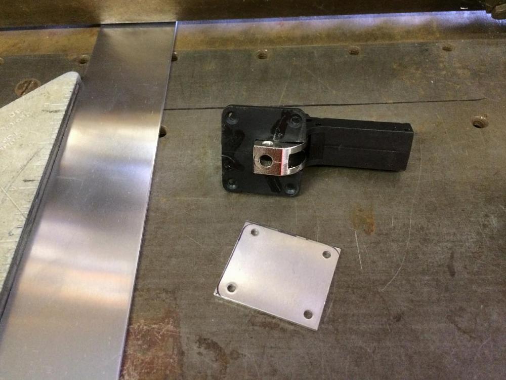

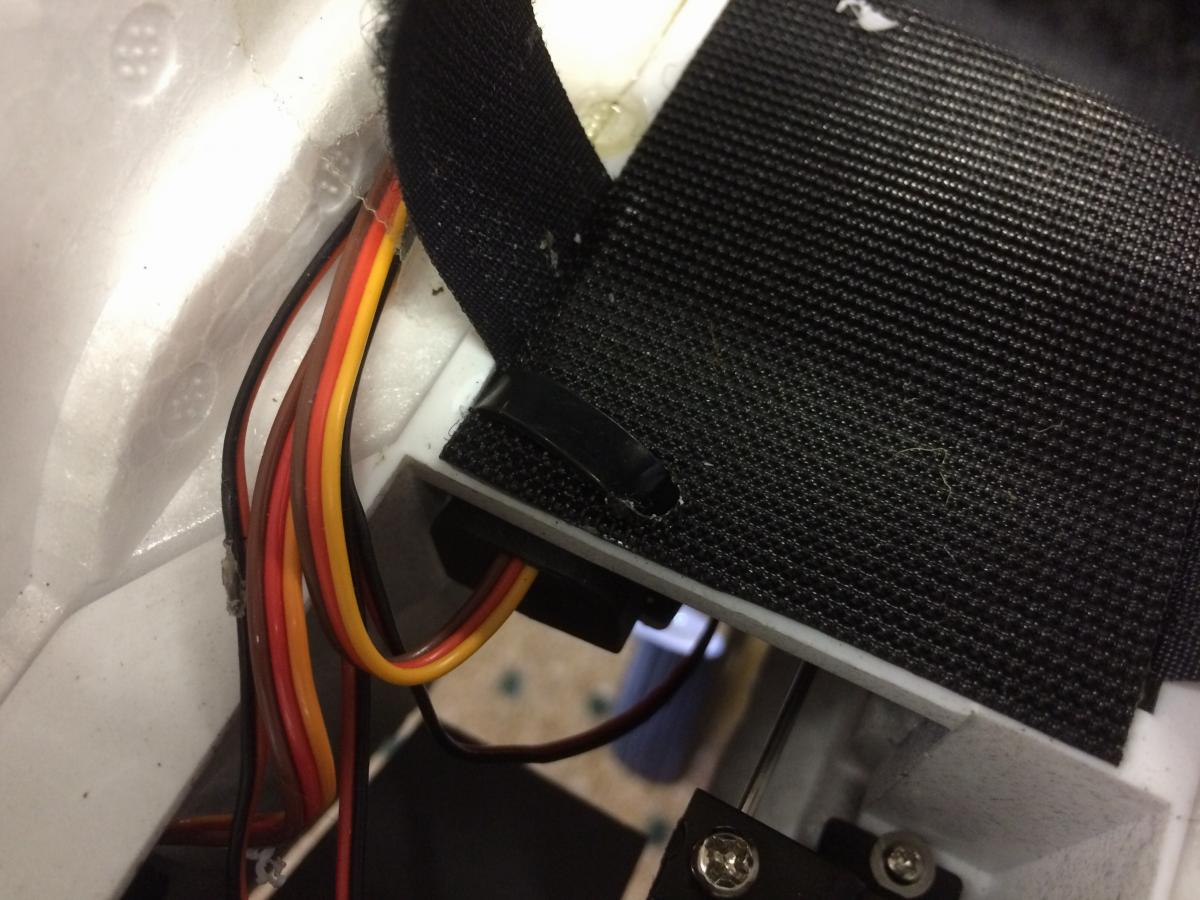

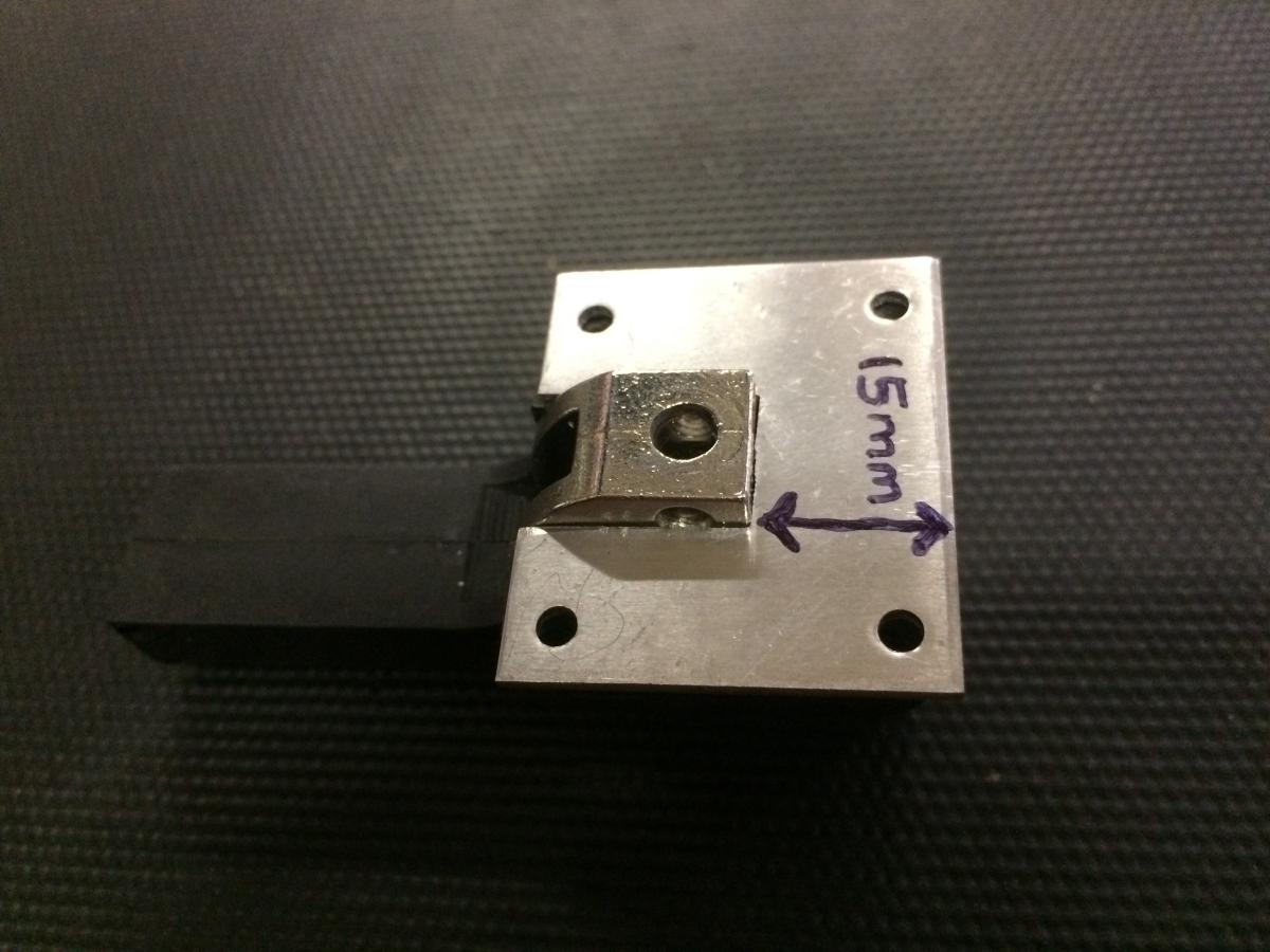

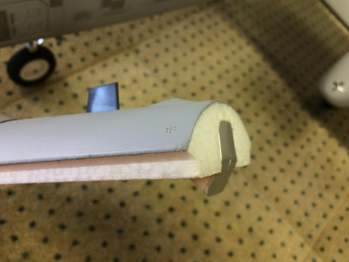

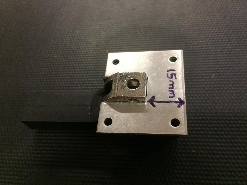

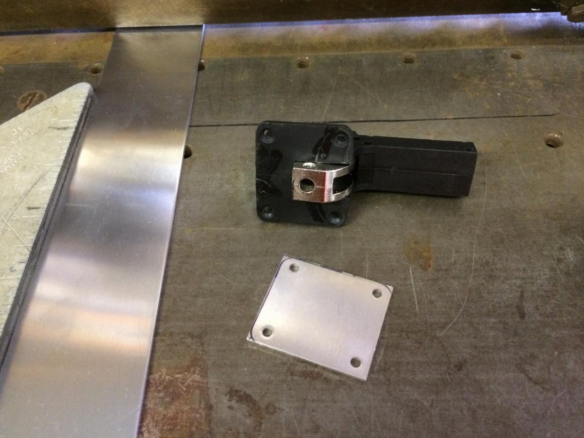

    This is what I did you take the slack out of the nose gear and will work on the mains once they need it. I used .062 5052 aluminum sheet and cut an additional retract plate that's 1mm shallower which limits travel to 45 degrees.
    Use the stock plate on top of the new one for extra strength.

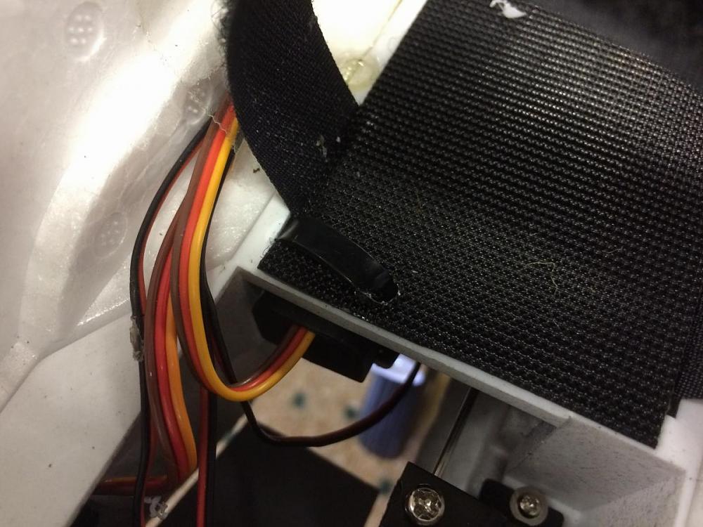

    I also ran a wire tie around the end of the retract to strengthen it some, just had to drill one hole and ran it through it and the slot for the battery strap.
