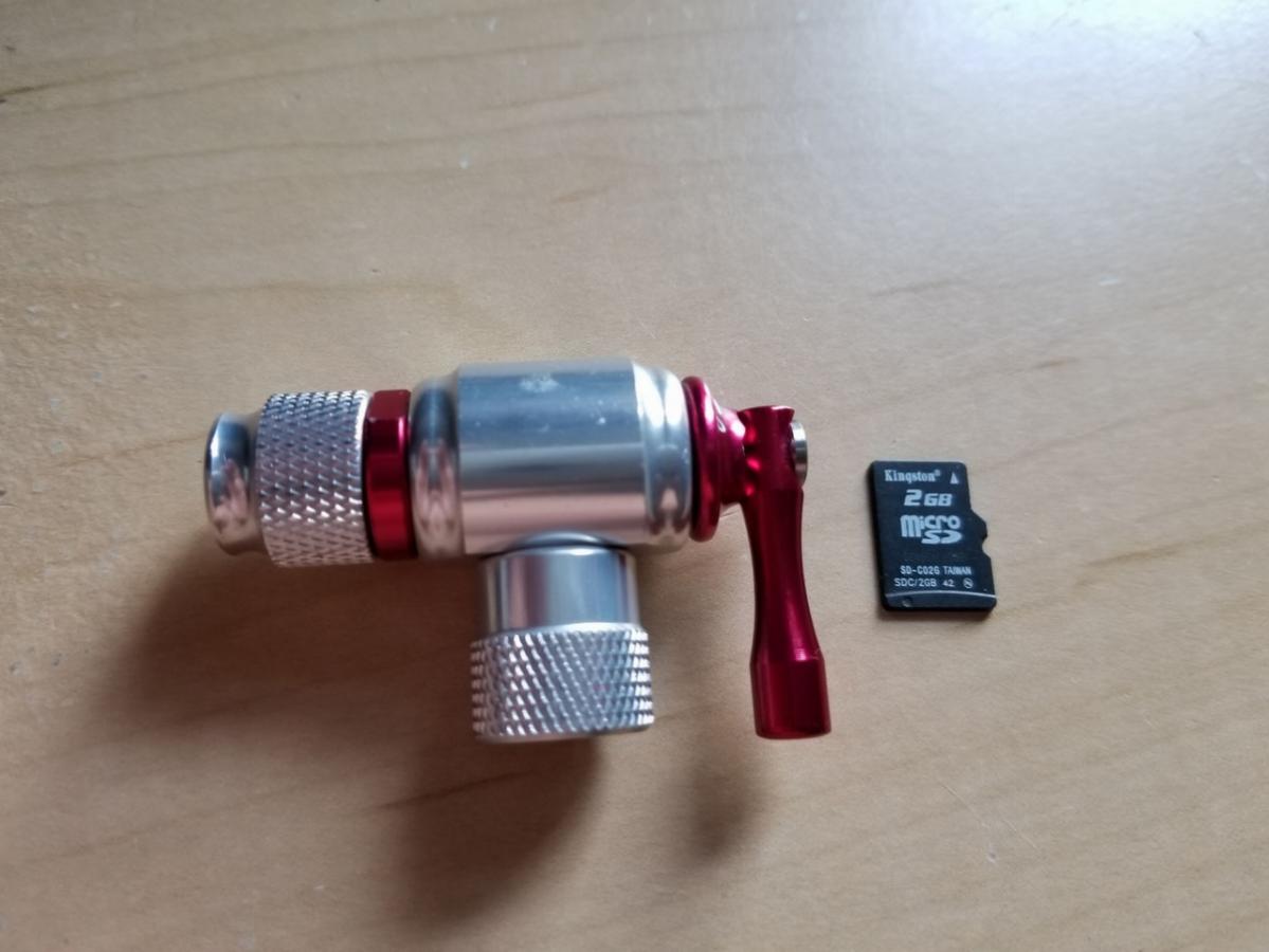

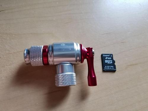

    It's something to watch out for and I appreciate the advice. I got the inflator yesterday. It's really small; smaller than I expected. And it's lever-operated rather than push-button. This is actually a good thing as I can simply attach the lever to a large servo wheel, and set my end-point to exactly how much airflow I need. Looking forward to testing it!

    Thanks very much Steve, appreciate that. I ordered the CO2 inflator and a box of 16g threaded CO2 canisters. I chose this one because it's small, lightweight, has a handle to adjust the intensity of the released air, and push-button operation. The idea is to affix a tube to the end of the inflator, run that tube into some sort of container that holds powder (baking soda, talcum powder, corn starch, or whatever sticks to the plane the least :) ) and then run another tube out the opposite end of the container to expel the powder. My thinking is that the CO2 inflator should have enough power to overcome the wind of forward flight and expel the powder outside of the airplane. The powder doesn't have to go forward of the actual plane of course, only just have to exit the airplane in a convincing matter.
    I'll mock up something on the ground first of course, then test it on an airplane.... my large flying wing, perhaps. If all goes well, it will go in the A-10 and if THAT goes well, I'll then order a sound system. No point in ordering the sound system if I can't get the visual part working. ;) I'll post pics as I progress through the prototypes and testing.

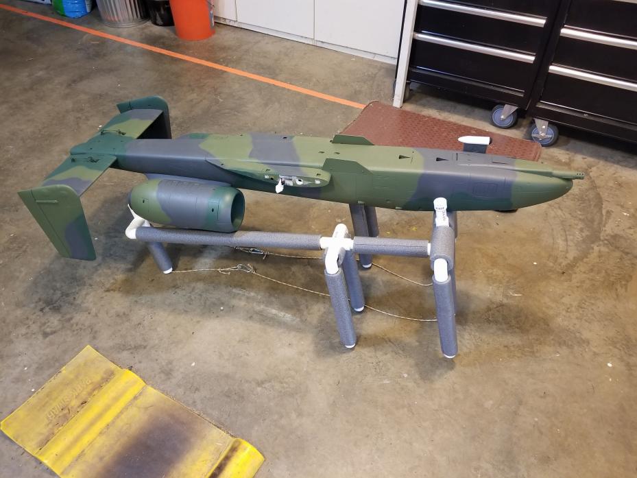

    Originally posted by vduniec
    Not a mod to the plane but something worth considering. This is a transportation/storage holder for the plane. It allows all of the wing pylons to remain in place. I pinch the pitot tube between one of the battery velcro straps and place the wing tubes in the cockpit area. I also screw the wing mounting screws back into the wings for storage. The plane is entirely self contained for easy storage and transport, sans the armament. The unit can be turned upside down to act as a cradle for assembly and disassembly at the field.
    The cords with the carabiners, act as a carrying handle and also as a mounting point to suspend the plane from the ceiling.
