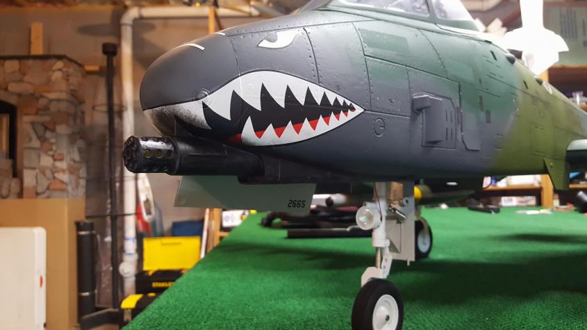

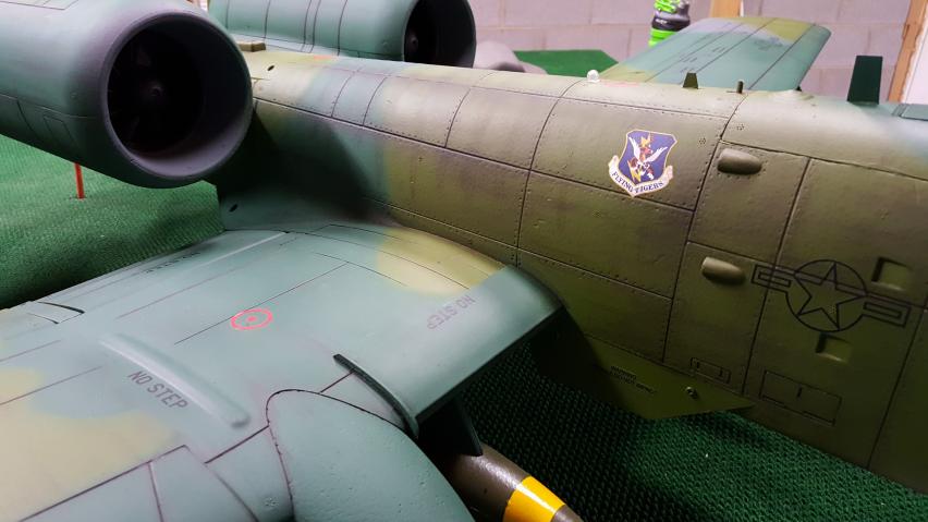

    OK, I think they came out pretty good! Got a few more things I want to do, especially to my AN/ALQ131. I trimmed off all the mold flashing, and then had to repaint. I wanted to repaint it anyway because I wanted it a light shade of gray to give it a little contrast as everything else is the same color as the plane. I also want to add some panel and rivet detail as well, but that will be done by hand. No decals for those.

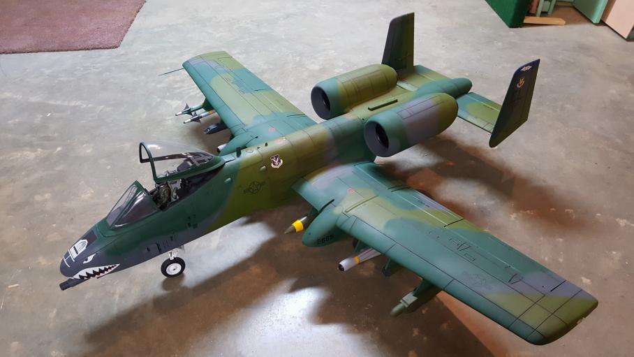

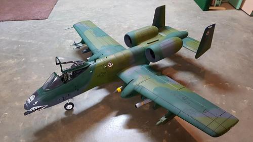

    So after my flights yesterday I noticed my lipos were extremely warm (like has been posted by a few pilots already), and I decided to mod the air cooling ducts a bit. I'm using the cheater grate from a Freewing F-5 for the exit air, and I cut some spoons to put over the forward NACA ducts to help draw air through.
    Still need to glue everything in place, and touch up with paint, but I hope this helps get more cooling air over the batteries. Of course, it was 103° when I flew yesterday, so that might have contributed.

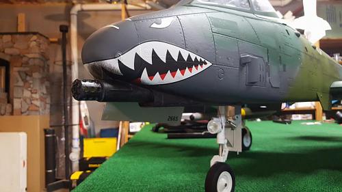

    I also blackened around the gun.

    Originally posted by Jpahemi1
    Rcjetdude
    did you us a wash on the panel lines they look real good
    john

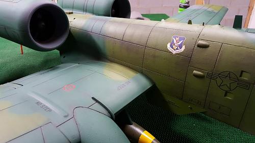

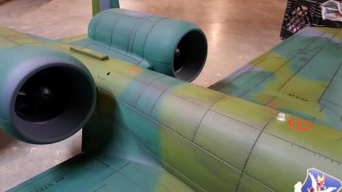

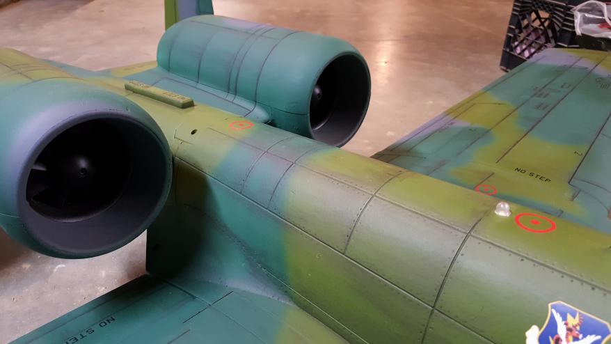

    Yes, just a wash of black and burnt number acrylic paints that I watered down. I brushed it on the panel lines and rivets then wiped it off in a backwards direction with a dry paper towel that I had folded several times to make it more rigid. I kept using a dry part of the towel. Tonight I applied some in a more vertical manner on the fuse and vertical fins.

    Rcjetdude
    john
    If there is any shine to them I just give then a matte clear coat and they are good to go.

    Nice rivet work. Did you use Alpha's technique or something else? I tried his technique on a spare cockpit I got for mods and found that it is really easy to push to hard and actually puncture the skin of the plane ......DOH ! A very fine line between a depression and a puncture for sure. Brad
    I just used the tip of a blunt pencil. Most did not go through but some did. No big deal.

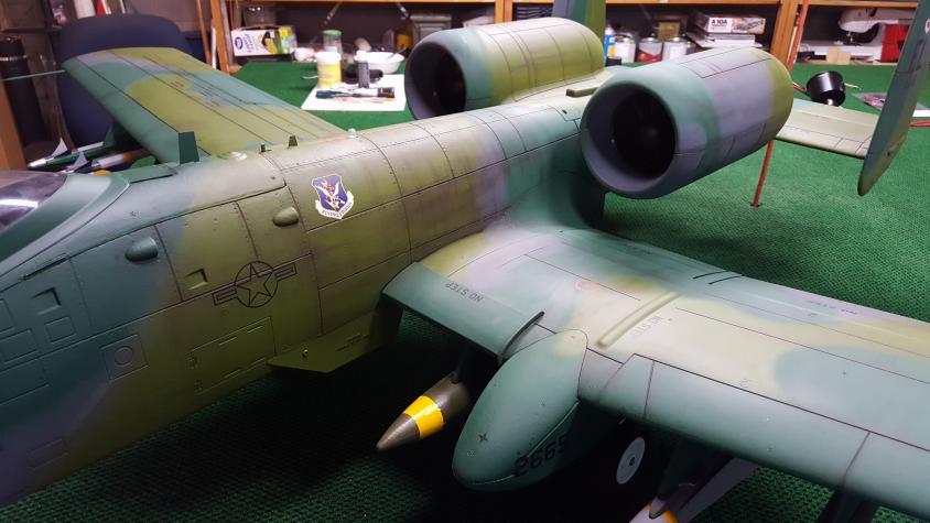

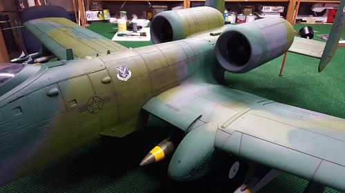

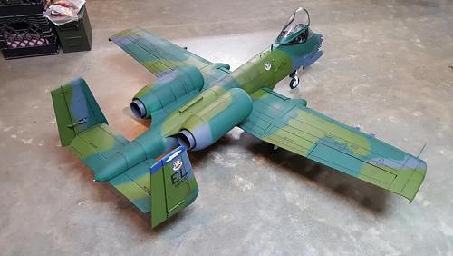

    Hey Brad, I will get to that tomorrow. Tonight I am trying to do some subtle rivet detail and weathering. I still have to weather the bottom and after I re-do some of the decals on the nose (Callie is making them based on my artwork) I will finish weathering the nose.

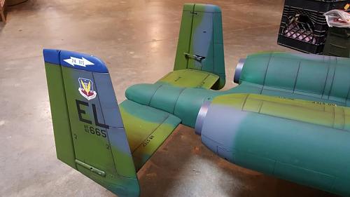

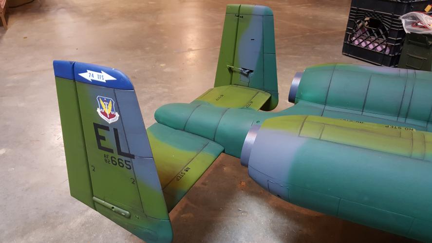

  • vduniec
    Looking good. Did you mask between the colors?

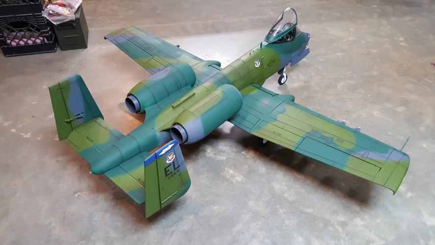

    Thanks. I used clear plastic sheets as patterns, raised off the surface with rolled up pieces of Blu-tac. I hand painted the light green then airbrushed the other two colors on.
