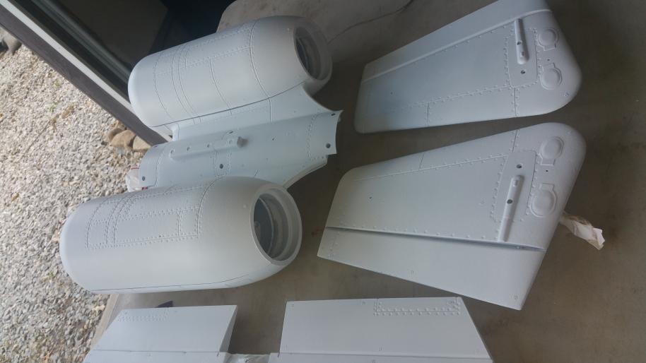

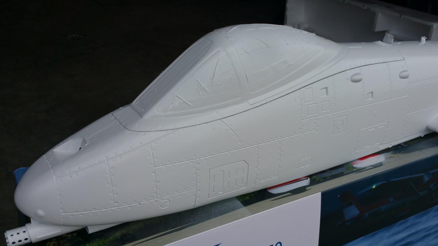

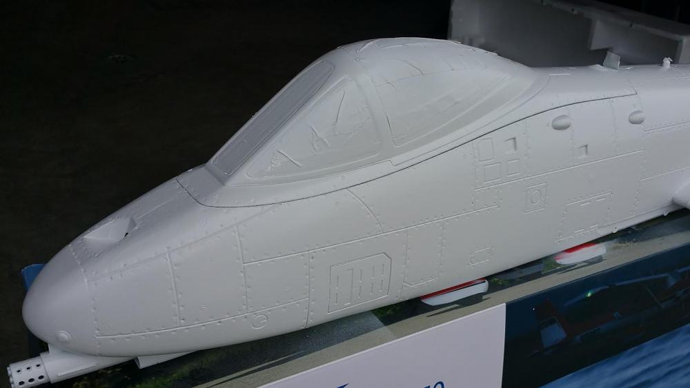

    The rivets to put on only took two hours ,with the radio on for some music. I didn't try to be perfect, just get them on fast so I could put the primer on.
    Looking good, t33jetman.
    Seeing all those rivets reminds me of a conversation I had with Xplaneguy late one night. I was trying to decide if it would be worth taking another week to draw the rivets, depressions, round heads, etc on this A-10. Ultimately we agreed, for a variety of reasons, to omit them. We're all modelers after all, right? A shish kebab skewer, for those who wanted that look, saved lots of hours of redrawing and avoided potential issues with mold resolution surface smoothness.

    I must say, this is the cheapest mode, but it does dress up the plane alot.
    I used a shish kebab skewer sanded down and just pushed in on the foam lightly. Click image for larger version  Name:	Screenshot_2017-06-27-05-49-02.png Views:	1 Size:	70.4 KB ID:	83256Click image for larger version  Name:	20170624_143544.jpg Views:	1 Size:	48.1 KB ID:	83257

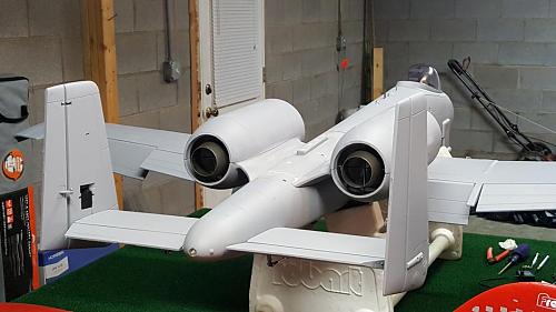

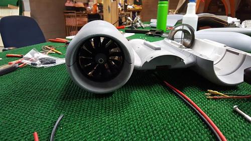

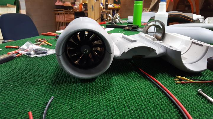

    I'm working on it bud :Cool:. We'll definitely compare as soon as I get another EDF to make the pair. The modified tailcones really set it off! Looks amazing! The tailcones on the 90mm nacelles are the only things I find unappealing about the set-up, so your mod cures that completely. I also personally like the look of the 12-blade fans (I have the 80mm 12-blade inrunner FW systems on my A-10 now) in comparison to the 9-blade. Oddly enough, I even like the silver (can even be painted easily) spinner in comparison to the stock black spinner on the fan unit. I know the spinner should be round and not pointed to be more scale, but I personally don't mind it a bit.
    I don't think the tail cones will interfere much with the air flow so it should still work fine. I just used two Krylon paint can caps and some fairly stout CF flat bar stock about 1/8" x 1/16" to support them inside the fan outlet ring which I cut down. I think I can live with the spinner as well. It definitely looks better.

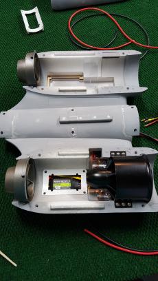

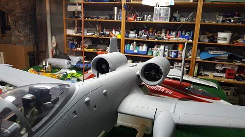

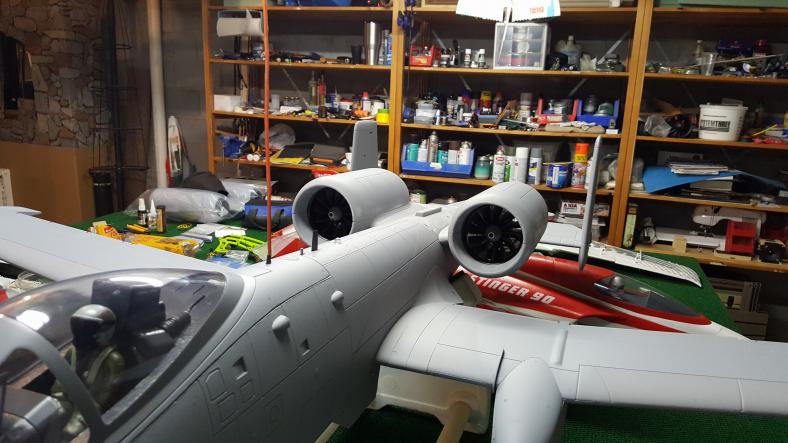

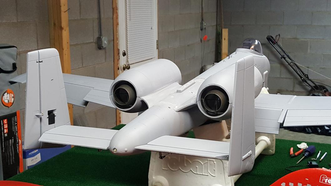

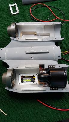

    I am building my 2nd A-10 (an ARF+) to have 90mm fans. I am using the 1550kV fans and 150A Cobra ESC's. I am going to experiment with 5S as well. So far I have the nacelles put together and the main components of the plane assembled. I need to pick up a BEC as that does not come with the ARF+ kit. I am trying to keep this one as stock as possible outside of the fans and my custom exhaust nozzles. I may do more cosmetic filling and sanding to warrent a two tone gray re-paint as a base for the Black Snakes livery and some weathering and I do plan to styrene sheet the cockpit but other that I don't plan to do much of anything else. T-CAT, I hope you are able to score another fan so we can compare notes.

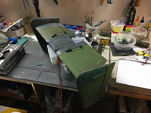

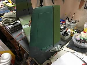

    Originally posted by MikeT

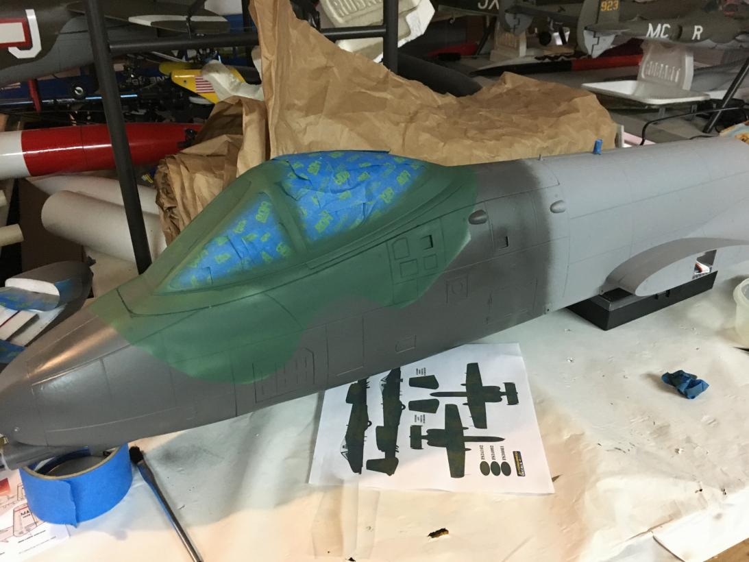

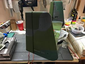

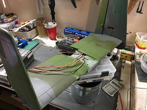

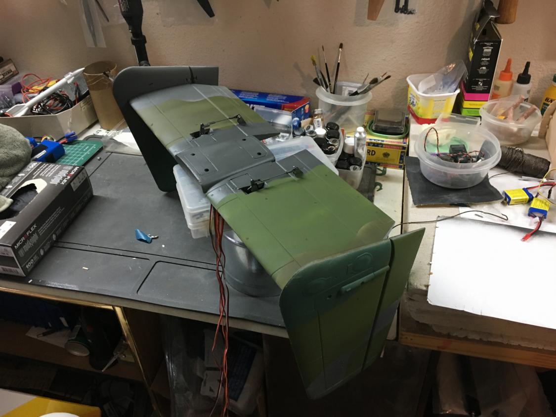

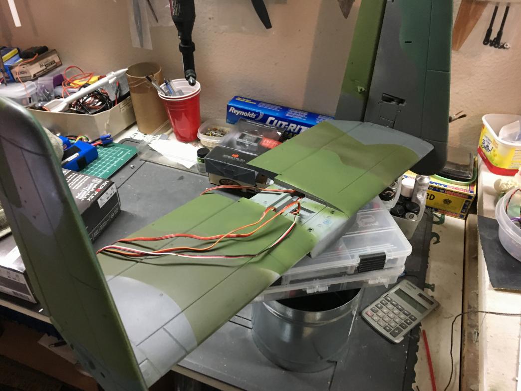

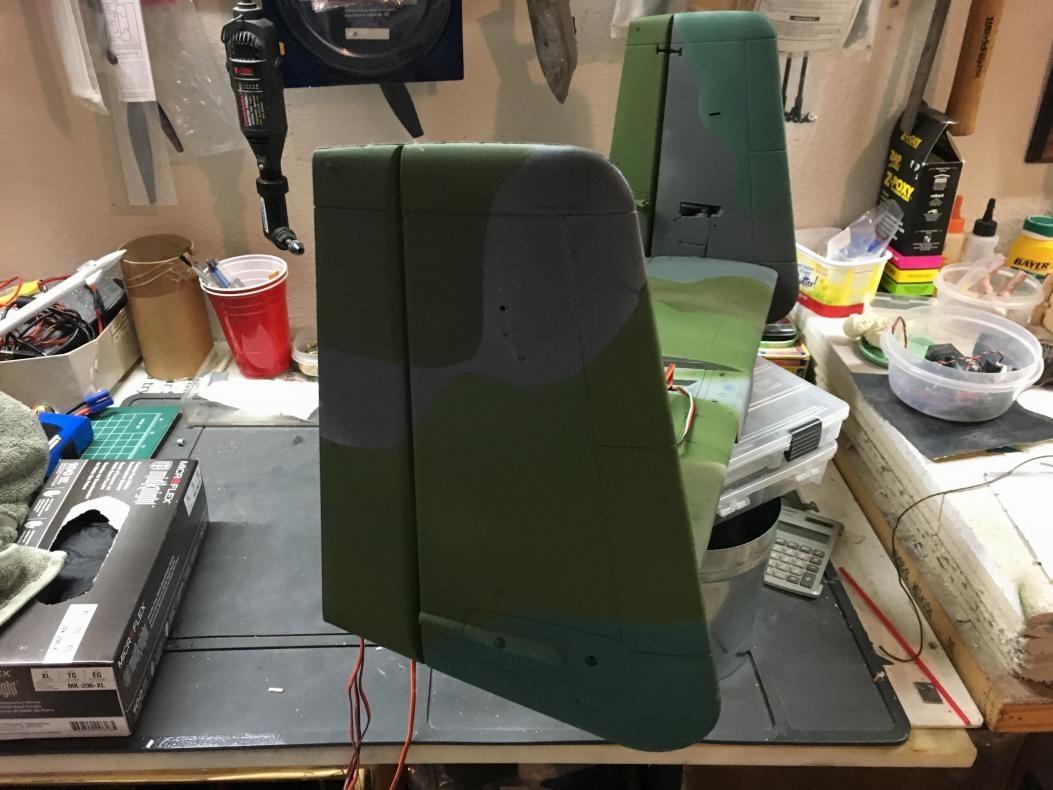

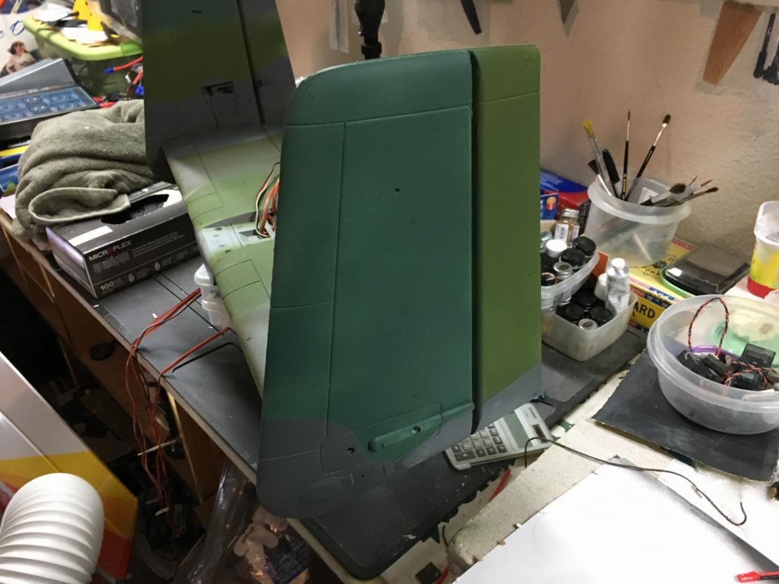

    Paints coming along it sure is a learning experience. I'll need to go back and touch up a few areas but all in all I'm pleased. I am taking a few "liberties" with the scheme to suit my taste.
    Mike Click image for larger version
ID:	83115Click image for larger version
ID:	83116Click image for larger version
ID:	83117Click image for larger version
ID:	83118Click image for larger version
    There you go... Looking good Mike.There will always be a soft place in my heart for a Euro Green A-10. I just love 'em.
