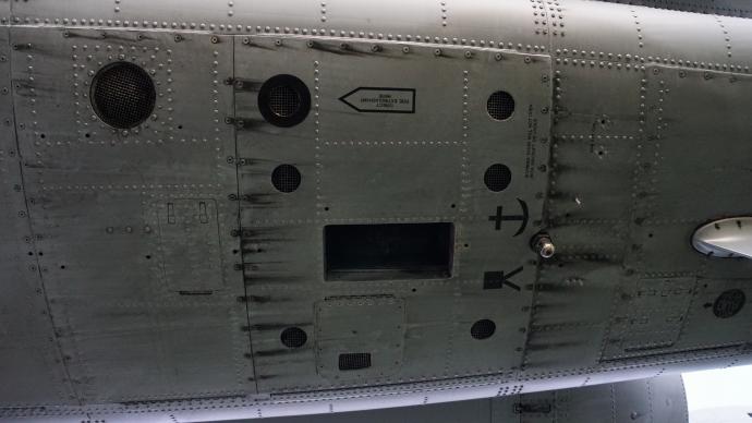

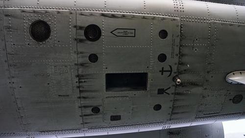

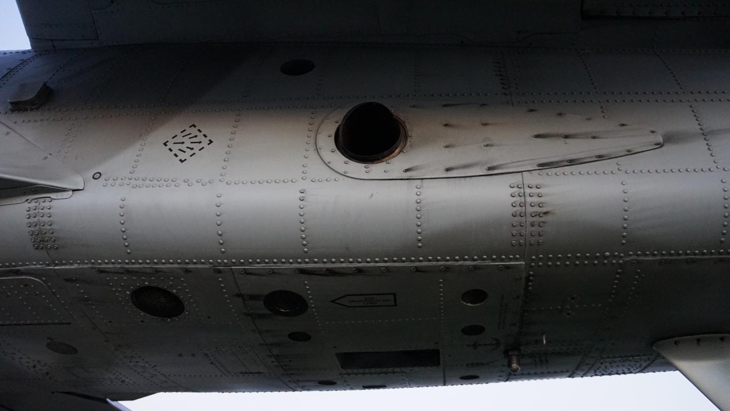

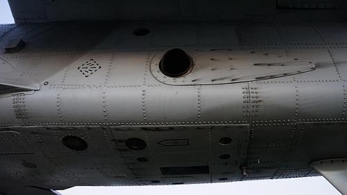

    Started with the rivets, Long way to go. Trying to match location and spacing as best I can from online photos. I noticed that not all adjoining panels have rivets/screw heads on both sides of panel lines. Not trying to be too critical, but don't want it to look like stitches either.
    Don't know if it's been mentioned with other hogs or I missed it, but the stock paint on mine is two tone, lighter contrast on bottom. Others the same?
    In that case, Ronnie, I look forward to seeing what you come up with on the A-10 and I hope my pictures helped. I might have other ones of areas if you're particular about where which kind of rivet is used.

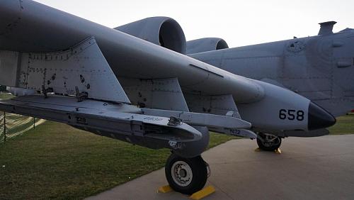

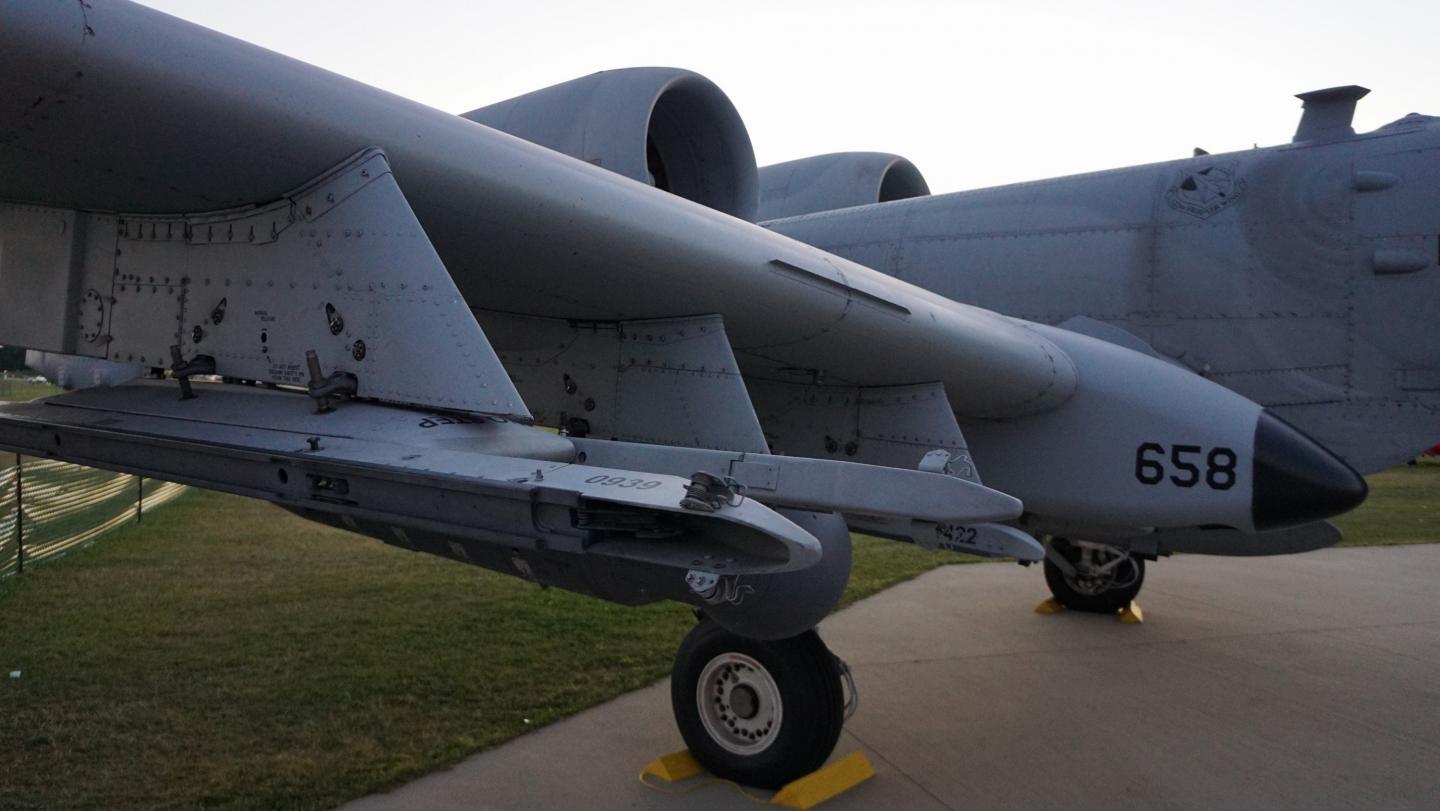

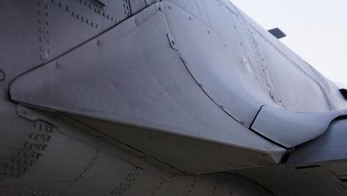

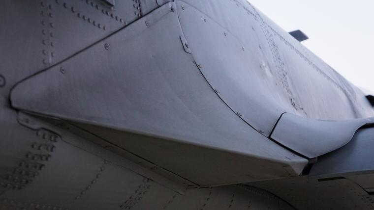

    Hi Ronniehinesh, the real A-10 uses different rivets in different areas, so your "OCD" as you say may not be fully satiated here, haha. If we want to get technical, most but not all of the real A-10's fuselage forward of the main spar uses flush rivets. 5mm is way too thick for the effect we want --What we're doing on this model are just shallow depressions, that try to capture the overall effect of a rivet without actually replicating its real life shape (which is a flat circle with a small dot in the center, not merely a hole). Its really difficult in this scale in foam to model an actual flush rivet shape as shown below. The outer diameter is nearly flush, and the dot/hole in the center would be very tiny. Perhaps someone could create a specialized die/tool for the job, but then again, you're working against the surface tension of the foam... and besides who's inspecting rivet fidelity on this aircraft?! To thicken the challenge, much of the fuselage behind the wing uses rounded head rivets. See some references I photographed myself on a Black Snakes A-10, 658.
    The wing root fairing shows the flatter flush rivets, and you can also see the round head rivets as they begin to dominate the rear fuse.
    Click image for larger version Name:	DSC04083.JPG Views:	1 Size:	23.1 KB ID:	83542
    Note that the rear fuse has both kinds of rivets, flush and round head:
    Click image for larger version Name:	DSC04074.JPG Views:	1 Size:	33.6 KB ID:	83543
    There are also visible seam lines of seam sealant. Even Mibos don't have that level of detail.
    Click image for larger version Name:	DSC04071.JPG Views:	1 Size:	89.7 KB ID:	83544
    An easy "scale mod" is to add the joiner plate visible in this picture on the leading edge of the outer wing. I sliced straight into the foam and buried thin piece of scrap plastic. It's visible in several pictures of Regulus [Prime] that won the Scale Jet award in Arizona.

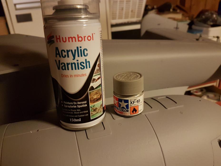

    I've used Tamiya XF 19 Sky gray. It's a very close match. Painted all my servos.
    Me too! :)
    Also clearcoated the whole thing in satin spray. Looking much better now :Cool:
