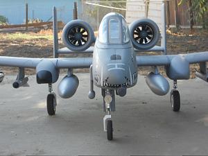

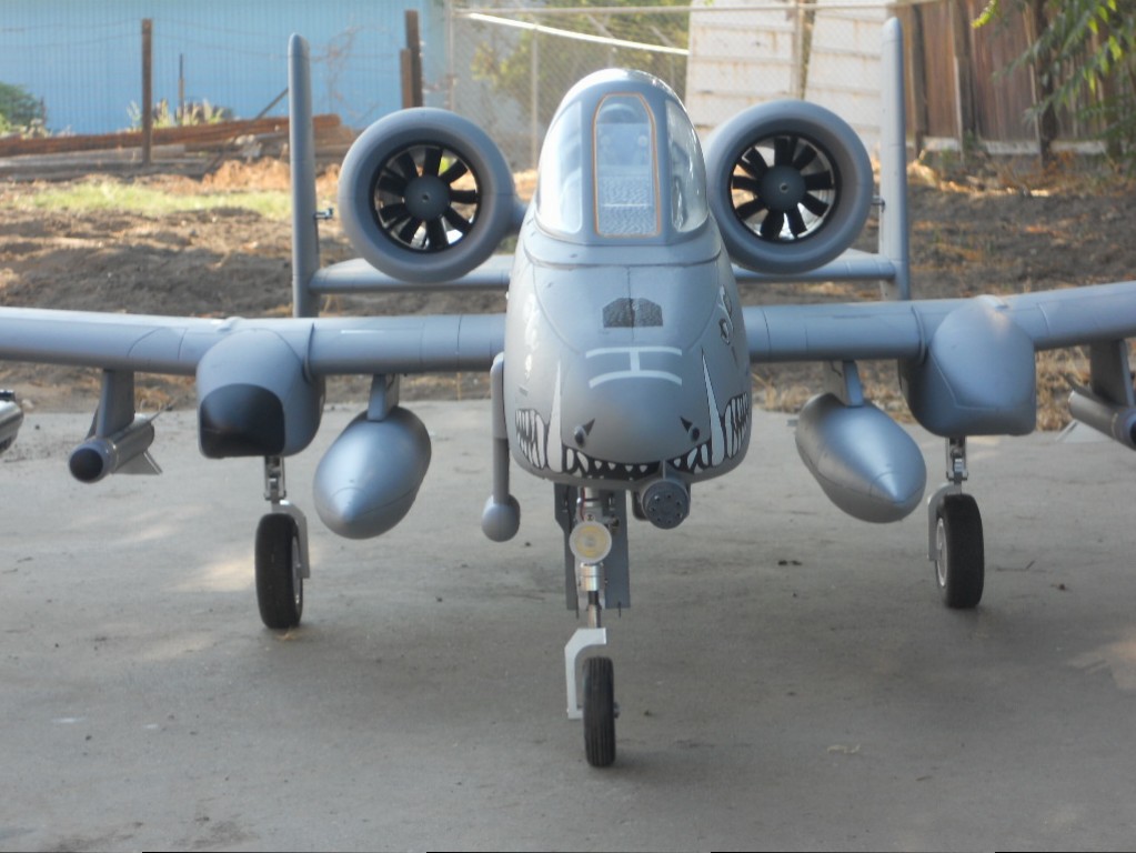

  • DCORSAIR
    Originally posted by Xtraflyr
    I'm going to have to try and make that drop tank. Makes the A10 look even more bad ass!
    Frank
    I decided to go with two tanks because RCjetdude did the one tank..........:)
