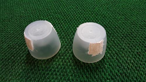

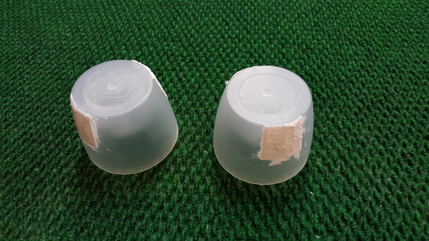

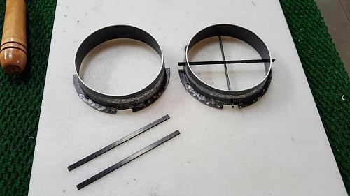

    it started out with two Krylon spray paint caps.I filled in the places you squeeze to remove the caps with some putty and sanded them smooth. When done I CA'd a layer of thin fiberglass cloth over them and then cut the ends off.
    Click image for larger version  Name:	20170624_231800.jpg Views:	1 Size:	220.6 KB ID:	98422

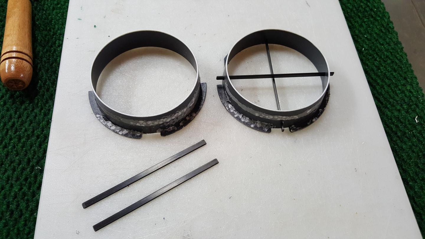

    I removed the original rings and cut them just shy of being flush (so they did not protrude) with the back of the nacelles with a razor saw. I then marked them to locate holes to position some 1/8" x 1/16" or so CF strip that I had. I used a Dremel with a small grinding tip to make the holes on the rings. Notice the rear most CF strip overlaps the other.
    Click image for larger version  Name:	20170625_191808.jpg Views:	1 Size:	138.0 KB ID:	98423

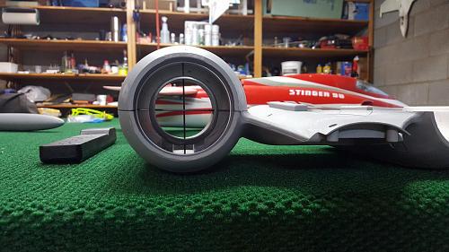

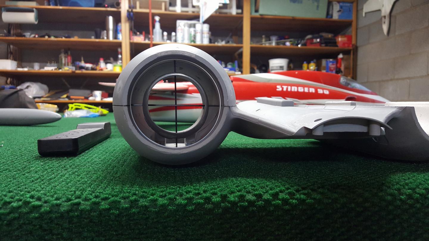

    Centering the nozzle is a bit more tricky but I just positioned, marked and Dremelled like I did the ring. Just keep it as flat as possible with the ring so as not to induce any additional incidence. After that I primed it with automotive primer and sprayed it with some stainless steel paint. Badda Bing!
    Click image for larger version  Name:	20170625_200423.jpg Views:	1 Size:	151.5 KB ID:	98424

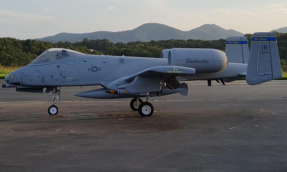

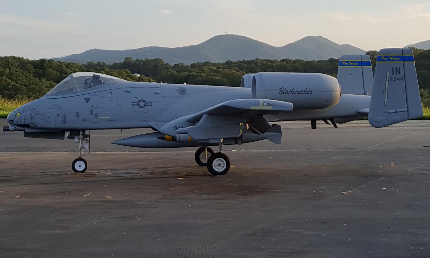

    Not sure. It cycled fine after landing. Go figure. I flew it on 6S per fan for the first time and with the new center-line drop tank and it definitely has more muscle in the air.. Could make for a very fun plane.

    I'm going to have to try and make that drop tank. Makes the A10 look even more bad ass!
    Frank
    Originally posted by OV10
    So what's up with the mains in this pic Steve :Confused:
    Looks like the stbd one has an oleo style strut and the port one has the "TI" 180 degree rotated trailing link strut
    They both are I would say that the port on is just a little compressed.
    Thanks George. I am going to clip the main springs next as it squats too easily as is and then just fly it. It sure doesn't look like it hit a chain link fence in the picture.
    These really are tough birds.
    Thanks T-CAT. Yeah, the more I look at it I really like it too. The lighting was good at the time. Not bad for a Smart Phone.
    That's an excellent picture and the drop tank sets it off. :Cool:
