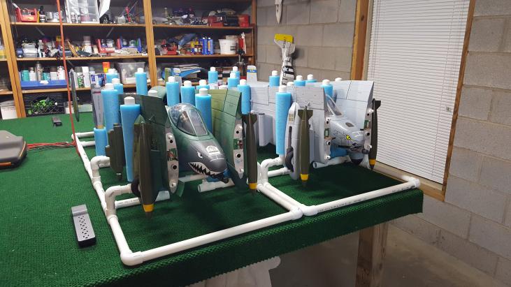

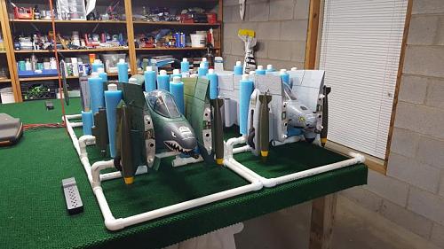

    I made a stand like the one posted earlier in the thread. It seems to hold the place very well.
    I have also been building some transport racks so I can haul them in a trailer without beating them to pieces.

    It is an ongoing process my friend... I just added the leading edge wing joiners and changed my nose wheel to the 60mm main wheel from the 90mm F-16. I was also monkeying around with the Shockwave2 sound card and somehow corrupted a file causing it to not work but got it back in order last night. I have also been building some transport racks so I can haul them in a trailer without beating them to pieces.
