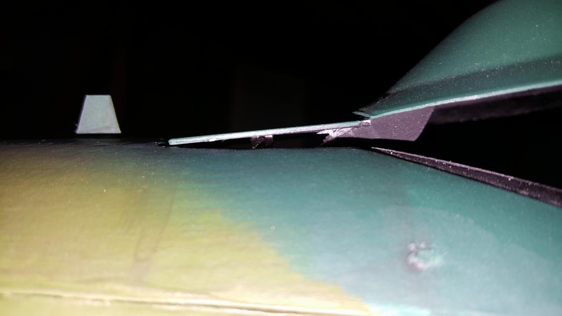

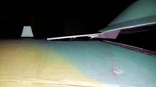

    I have added an additional air intake vent to the battery area. I cut a slotted area under the refueling decal and added a cut spoon to act as a scoop. From the top you can't even tell it's there.
    While my extra venting on the bottom did help get some more airflow into the battery area, they were still warmer than usual. Hopefully this will help. I will find out tomorrow.
    I think this mod has finally done the trick. Batteries still come down a little warmer than some of my other jets, but they are now definitely cooler than before, and there is not heat build-up in the battery cavity. On my maiden flight, when I opened the hatch a heat wave came out. Now it stays pretty cool in there.

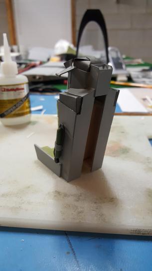

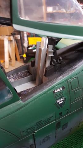

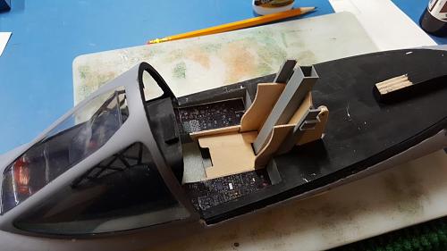

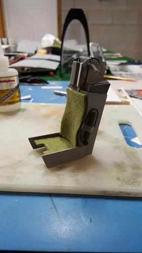

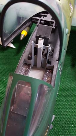

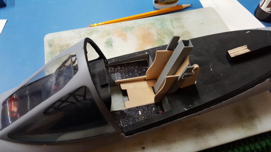

    Ok, getting back to the cockpit mods. For the ejection seat I looked at a lot of pictures to get a basic understanding of it in my head. Mine is removable so here are a couple shots of the framework with it removed.
    Click image for larger version Name:	20170610_233425.jpg Views:	1 Size:	21.3 KB ID:	80669
    Click image for larger version Name:	20170610_233432.jpg Views:	1 Size:	20.3 KB ID:	80670

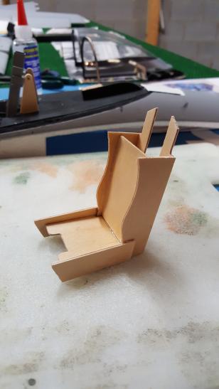

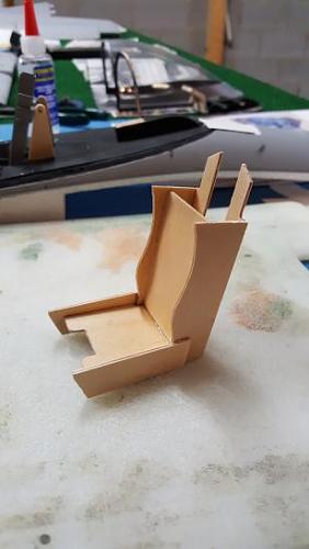

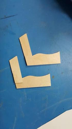

    The seat was made from 3/32" plywood after I made poster board templates and trial fit them. I started with the sides.
    Click image for larger version Name:	20170510_191403.jpg Views:	1 Size:	13.7 KB ID:	80671
    Click image for larger version Name:	20170510_200946.jpg Views:	1 Size:	50.9 KB ID:	80672
    Click image for larger version Name:	20170510_203841.jpg Views:	1 Size:	20.0 KB ID:	80673

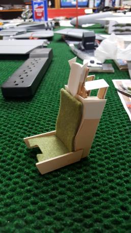

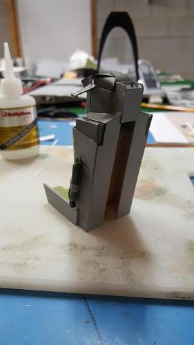

    After I had the basic shape and size determined I embellished it with styrene, dark gray photo album paper and an olive colored felt I found at a local Jo Ann's craft store.

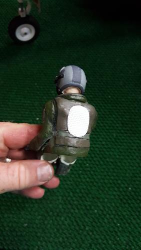

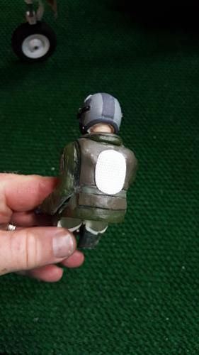

    Be creative. I did mine this way adding detail as I saw I could. There is no right or wrong way to do this. I also added a Velcro pad to the back of the pilot to help keep him in the seat.
    Click image for larger version Name:	20170610_235929.jpg Views:	1 Size:	18.0 KB ID:	80677
    Once in his seat you can't even see the Velcro.

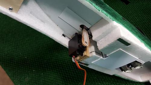

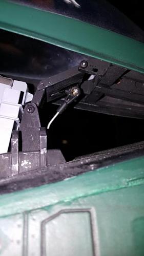

    Wow, very cool. What did you use for the hinge pins of the linkage between between the servo and the canopy lift mechanism? Didn't mean to sound like you didn't do it right in the first place man, just thinking out loud. Truly, I am amazed at your enginuity! Brad
    I didn't take your meaning that way at all. I used a ball link to attach the pushed from the servo to a small bracket on the bottom of the lifting arms. The lifting arms are secured either with screws or attached together with a wire pin.

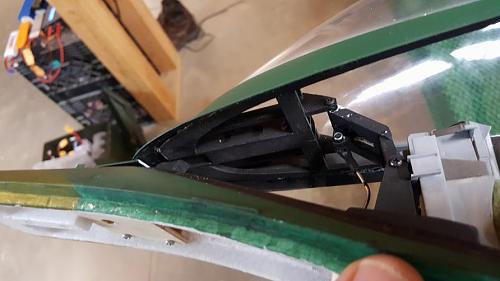

    I didn't realize there was a lip on the underside of the leading edge of the canopy or that it slid forward like the LX so that's cool. Second, I was refering to what you are calling the main beam. I didn't know at the time I posted that that was what you were calling it. Terminology is always half the battle. Now we know what to call that 3/8" plywood piece. Great pictures but I'm still having trouble understanding the mechanics of it. So you have 8 pictures in this latest post. I will use them as a reference. In picture #2 does that plate simply keep the main beam from falling through? In picture #4 does that sliding square tube attach to the underside of the canopy? In picture #8 if understand correctly you are using the foam tac as a " hinge" for the leading edge of the styrene plate.Wondering if a small Dubro nylon hinge, #119, might be more durable over time or? Makes good sense that the trailing edge of the canopy helps stabilize the styrene plate. In picture #9 I think I understand your explanation but a side view showing where the clip holes are drilled and where on the bottom of the styrene plate the small plastic bracket is glued. Also, the dimensions of the styrene plate and possibly a template of the main beam would be helpful. I'm wondering how the 1/8" ply sill attaches, I assume, to the bottom of the canopy. My hat is off to you figuring all this out dude! Waiting to see how the servo mechanism works and the video. Thanks, Brad

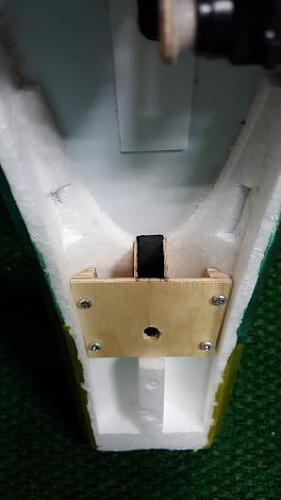

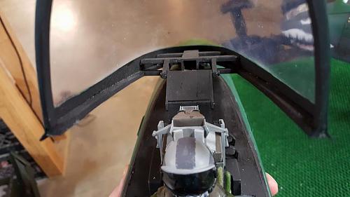

    Ok Brad, I will do my best to hopefully answer your questions. Concerning picture #2 here is another shot from a different angle. It allows for the main beam to pivot up and down
    Click image for larger version  Name:	20170610_204559.jpg Views:	1 Size:	16.3 KB ID:	80655

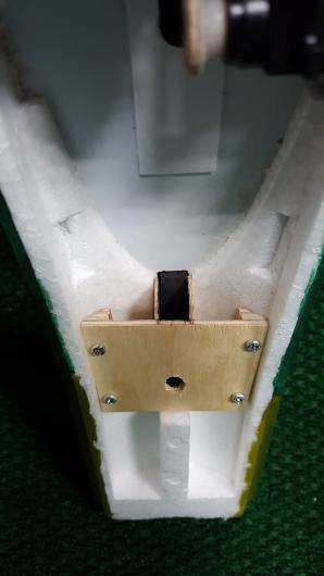

    The triangle shaped brackets are glued to the hatch and the 3/32 ply pieces are glued to the plate. They not only hold the brass hinge pin for the main beam but help keep it lined up straight as it moves up and down. The styrene sheet on the rear deck keeps the beam from falling through. In picture #4, yes the frame base that the canopy attaches to is secured to the sluding square box. Here are a couple shots of that.
    Click image for larger version  Name:	20170610_204759.jpg Views:	1 Size:	44.1 KB ID:	80656
    Click image for larger version  Name:	20170610_204811.jpg Views:	1 Size:	45.9 KB ID:	80657
    It ends up making for a very rigid structure.
    Here is a side shot of the small plate behind the canopy. I wish I had a better shot but the bracket is glued in the center of the plate and you can make out the angle of the wire retainer. It only needs to lift the plate a little bit as the canopy moves back to open.
    Click image for larger version  Name:	20170610_210430.jpg Views:	1 Size:	42.5 KB ID:	80658
    Again, are there better ways to do it? Yes. A small hinge might work much better than the Foam Tac. The plate is cut to fit the panel lines for it just behind the canopy. Sorry I did not get a shot of where I drilled the holes for the wire retainer but the side shot above may help.

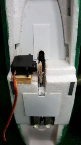

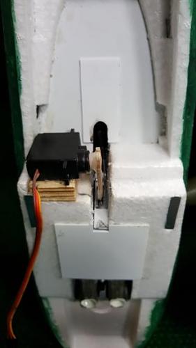

    I will post a link to the video of the canopy movement here as soon as I can get it uploaded. Here is how I have secured the canopy servo which is just glued in place with Foam Tac.
    I had to extend the servo arm to get enough travel.
