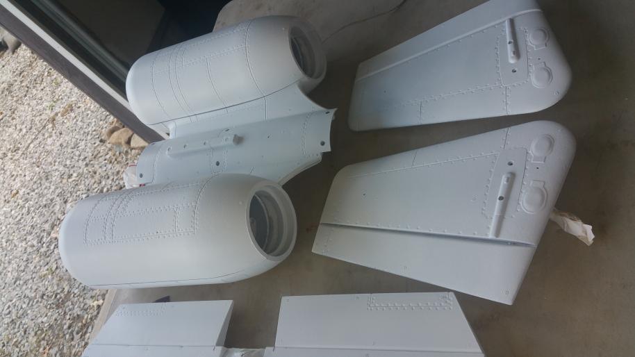

    This is all I have so far. Its worth pulling the Nacells apart before spraying. M.O. is just wiping surface with gas station paper towels and denatured. No lint from those kind. I soak the cans in very warm water for ten min in a bowl. Two coats does it and stuck with a solid not metallic for ease of touch up.
    Both black and purple really pop with the yellow.
    Tiger meet scheme is also doable.
