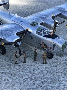

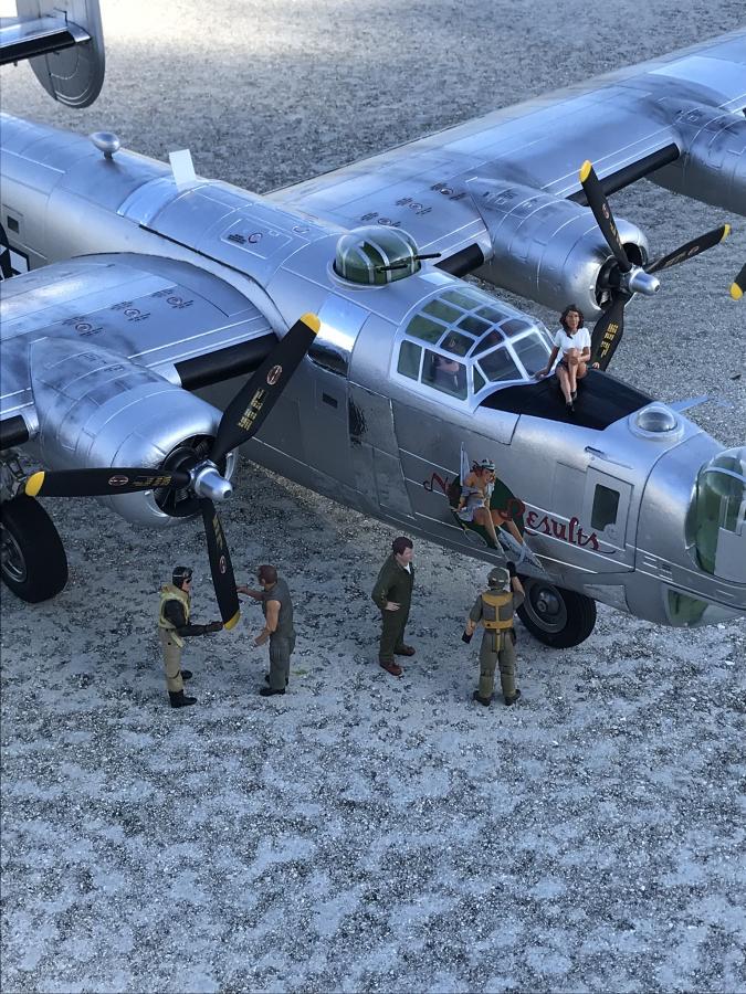

ID:	198576 “Net Results” and her crew prepare for a mission.
          Remember the sacrifices made to keep us free - 6-6-1944...

            Yes, Never Forget! Omaha, Utah, Sword, Juno, Gold.
            Where did you get those pilot and crew figures?

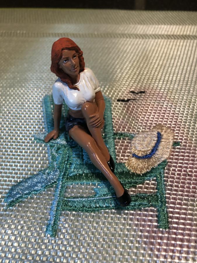

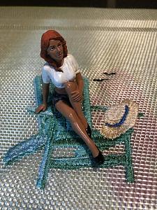

            • Alpha,
              The two pilot figures and the sleeveless ground crew member are 21st-century ultimate soldier products. The other two mechanics I found on eBay under 1/18 action figures - search for mechanic & lady mechanic.
              Lady Mechanic on break...

                TOA, Your Liberator is gorgeous, Sir. The "Net Results" Nose Art is amazing. The figures are cool, too. Best, LB

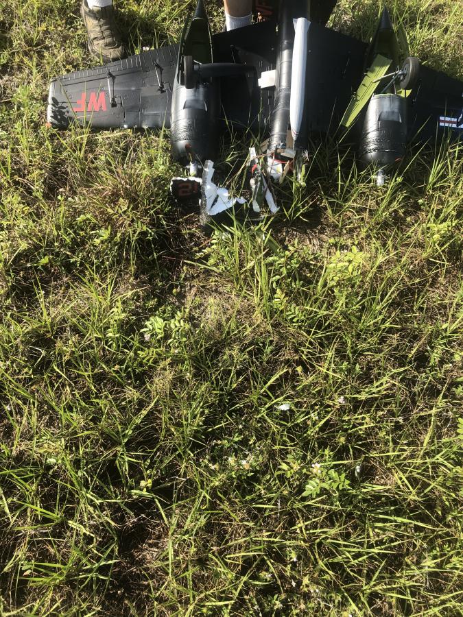

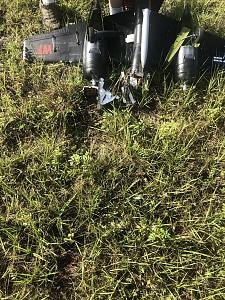

                  I am currently in morning. My F7F Tigercat bit the dust due to “electrical problems.” So before I fly the B-24 again, I am going to test for functionality, tighten all the connections, and then silicone the connections so they don’t work loose - like I suspect was the cause for the demise of this Cat. I’ve had three crashes with the two F7Fs that I’ve owned - all due to electrical connections working loose. :Angry: :Angry:
                  so the moral to that sad story is CHECK YOUR CONNECTIONS and silicone them in place. These bigger aircraft are complex and need thorough preflights.
                  • So sorry to see that happen! Big Bro hugs! Wow. :Straight-Face: Jerry
