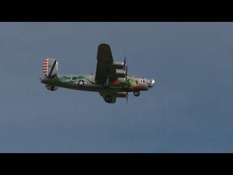

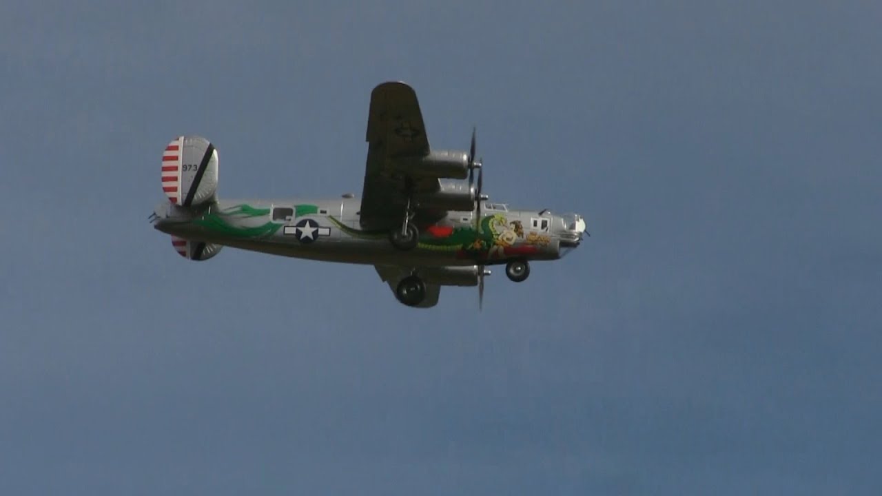

Got some more flight time on the Dragon. Speaking of flight time.. 12 to 15 minutes? Easy enough to get the hours for your rating ;)The Dragon And His Tail, 2000mm RC B-24 with rotating turrets and on board camera. Recorded at FLY-A-WAYS Club air field, Oregon. Pilot: Dennis Wright music ...There are hundreds of RC aviation videos viewable here; WBRC
