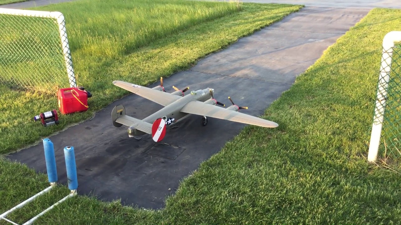

                  • I totally forgot to post the maiden video from two days ago.
                    The wind was out of the East which means it was blowing at me, this becomes important in a moment.
                    I was waiting for the wind to die down a bit but finally decided what the heck and went for it. This entire flight was at half throttle. I used a pair of Admiral 4S 3600 mAh batteries. Based on my two flights I should be able to get 6 minutes easy.
                    The landing got away from me, the plane was blowing toward me and I did not compensate with enough rudder. No damage was done. I flew it one more time with two landings that were booth really good.
                    This plane is a really docile in the air, I cannot wait to get more flights on it.
                    Today I flew put five more flights on it, eight flights total. Timer is at 6 minutes and I thought I might be able ti get 7 minutes. I fly at 1/2 throttle (I take off that was as well) and she flies plenty fast.
                    I lOVE THIS PLANE!!!!!!!
