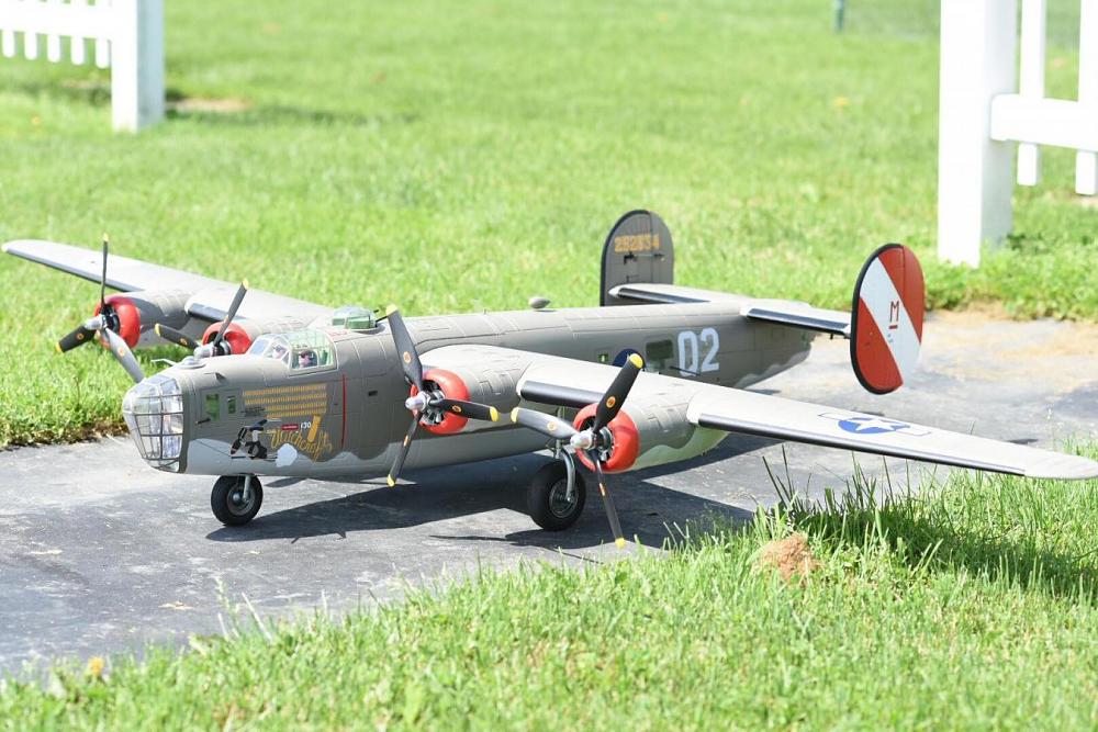

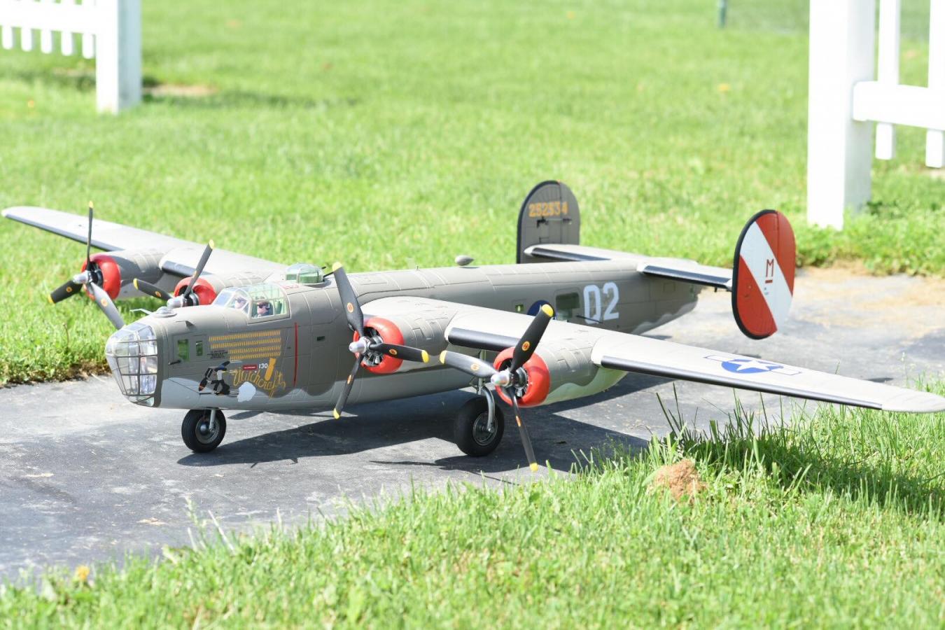

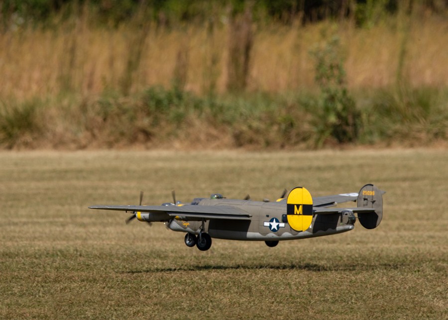

      A visitor stopped by our filed a while back and took photos of some of the planes and put them up on his Flicker account. While looking through them I was surprised to see my Barney's Buzz Wagon in flight!
      (I don't know why it's showing that pic all pixelated but I can seem to change it)

        I really like your choice of markings, NoDirt! I remember building a Revell kit years ago and ended up modeling the exact same bird!

          Cool! I thought I may be the only one that ever saw the Buzz Wagon. I like the yellow and wanted something different.

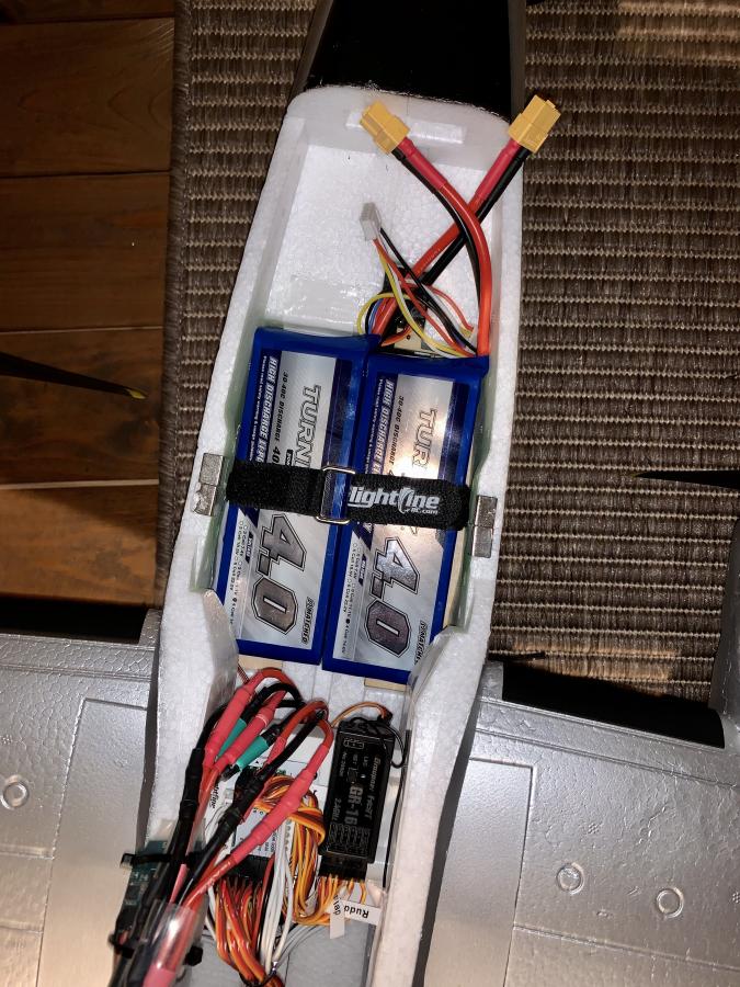

                    Hi Folks ,
                    hope u r doing well.
                    Just received a Freewing B-24 and already assembled.
                    i will use some 4S 4000mAh Batterys , but i am not really
                    sure about the cg. The manual shows 76mm, but with the
                    installed batterys its really tail-heavy at 76mm.
                    I ve got only 7mm to move the batteries forward or backward.
                    Iam not sure if i need to add some plum ?

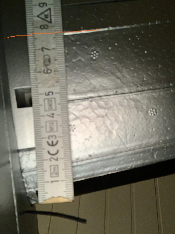

                        Hi Alpha, thx for ur fast reply.
                        i measured 76mm of the front-wing.
                        I mixed up the languages , J.
                        “plum“ is the latin word for „lead“.
                        ( i am from Germany)
                        pictures attached

                          Hey there Superbfan1980, welcome to the group. The manual specifies that the CG should be 76mm back from the LE of the wing.
                          Exactly as in your picture.
                          With this model, there is not a big difference with the landing gear up or down, but most of us feel that you should balance with the landing gear UP (since that is the flying position). With the gear down, the CG will move slightly backwards but only a very small amount and its not enough to make any difference with this model.
                          So at 76mm... with this model you will find that if you set it here, it is actually nose-heavy. You will have an easier time pulling the nose up for landing if you balance it a little further back, say 78 or 79mm. Motion tends to recommend a nose-heavy starting point on most of their planes, which is an excellent way to start. Nose-heavy planes fly very well. But you can move it back a little.
                          Where does your model balance with the batteries positioned as shown in your picture?
                          If you need to move the batteries forward, try using a bigger battery instead of lead (plum).
                          Many of us have found that this model flies very well using 3-cell packs. With the 4-cell pack that Motion recommends, this model flies at about 600mph (scale speed) and will go straight up vertical and accelerate. With a 3-cell pack it is still overpowered. With 3-cell packs the plane is lighter and flies for a long time.
                          One piece of advice from me to you..... be very careful during takeoff, avoid letting the outboard propeller hit the ground. That is the only thing you need to worry about - this plane is a really nice flying model, very easy to handle, it is stable and responsive and easy to land. (My advice is worth at least 2 cents!)

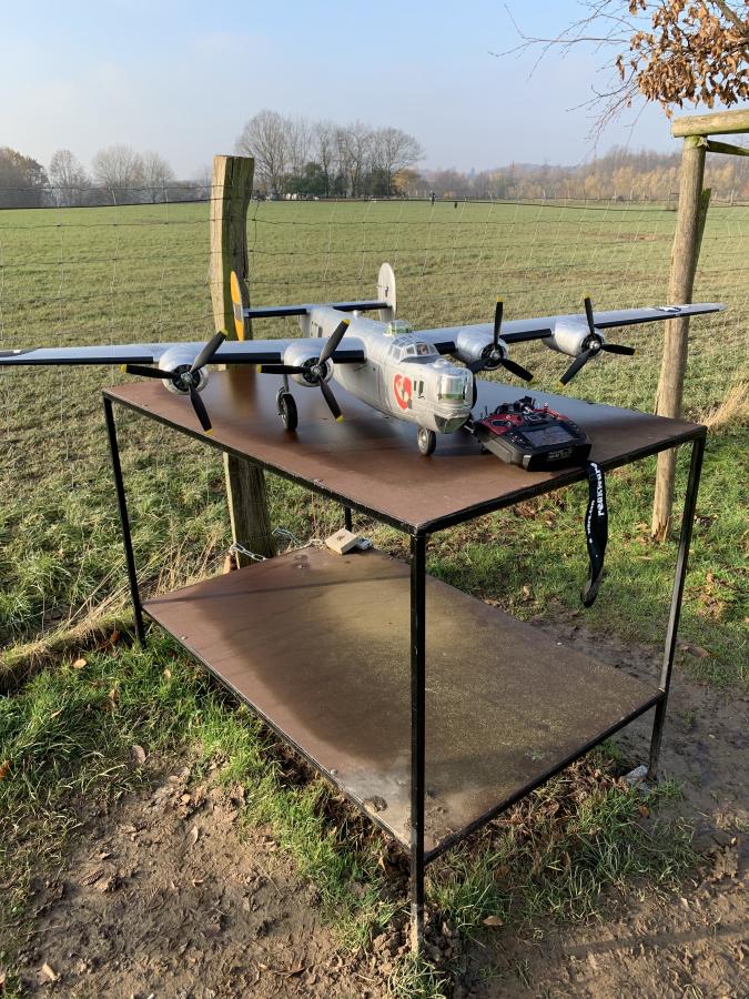

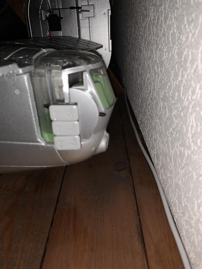

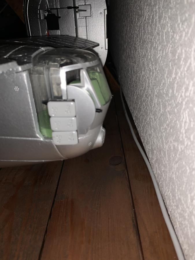

                            themudduck thx for your tips.
                            All my rc-planes are equipped with 4s batterys , so i will stay on 4s with the liberator to keep it simple for me :-)
                            Right now i added 30g lead( 15g each side) on the back-console at it seems perfectly balanced with the 2 x 4S 4000mAh. ( just a little „touch“ of nose-heavy)
                            ( unfortunately i had to insert the machineguns to fit the b-24 fully into my car)
                            Just waiting for better weather conditions to peform the next flight. Germany => always rain :-(
                            Click image for larger version  Name:	7D7F85D8-EA31-4027-A28B-1F8054023899.jpeg Views:	0 Size:	65.9 KB ID:	219139

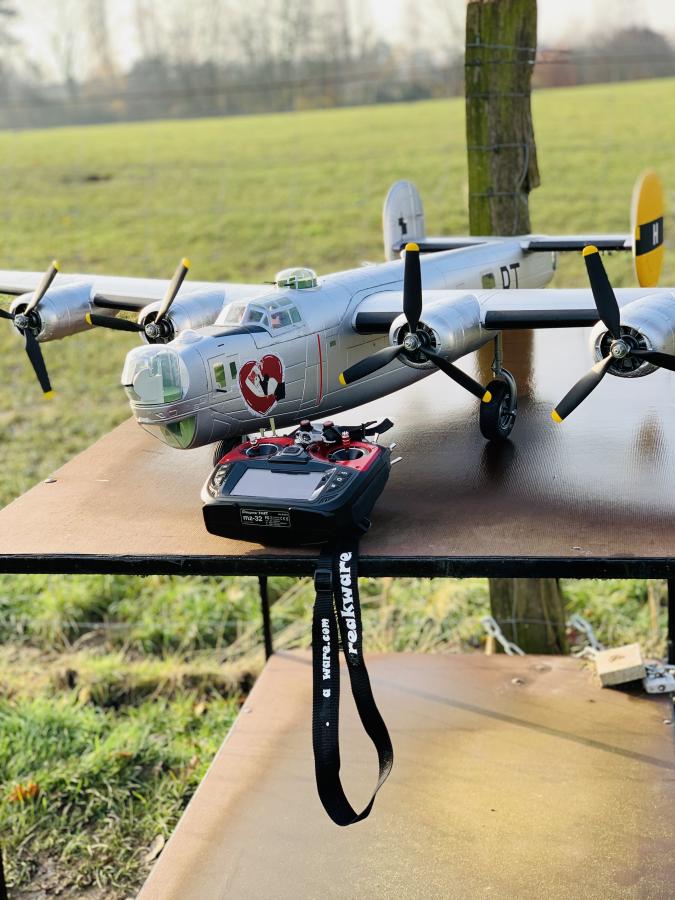

                                  hey ho,
                                  we had perfect weather conditions yesterday and i performed 3 perfect flights. Nice plane but i need to keep in mind to
                                  release the retracts before landing :-)
                                  thx 4 ur help guys
