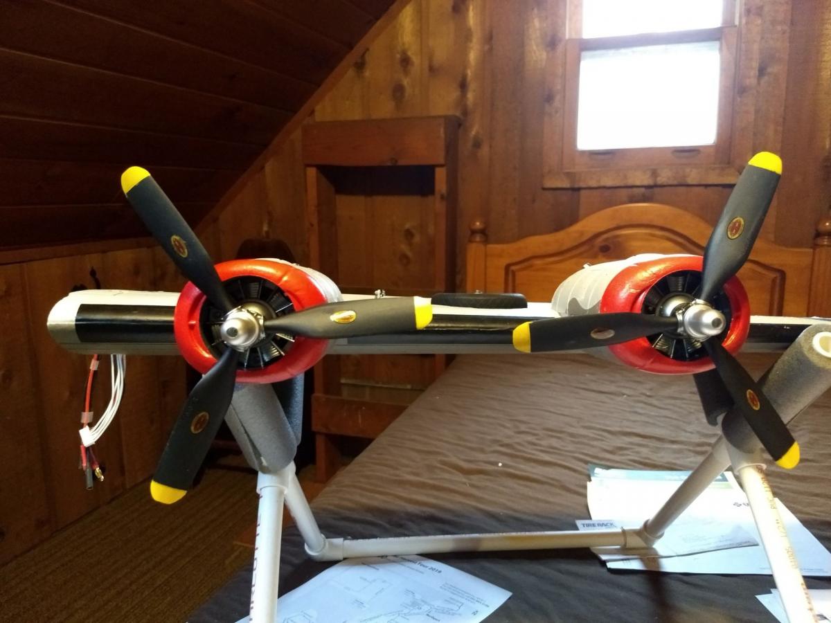

                                        I used an idea from a Youtube video to cut down 4 3-bladed props on my B-24. In the video they made a 3d printed fixture. I just used two blocks of wood, one to mount a motor to and the other with a hole drilled to fit the business end of my Dremel. Then I clamped them to the edge of my work table with another wood piece between to get the proper height/spacing. It worked great to get an accurate cut on each blade. Then I just used a file to round the tips to their original shape and painted the tips. two of them were perfectly balanced and the other two were close. It was actually pretty easy other than there were 4 blades! Cut down was from the original 9.5" to 8.3".
                                        Video link: https://youtu.be/MxHMUbuMAYs
                                          • 4868
                                          #1700
                                          JDill , Well Done. Looks great and balanced properly...super mod. Best, LB
