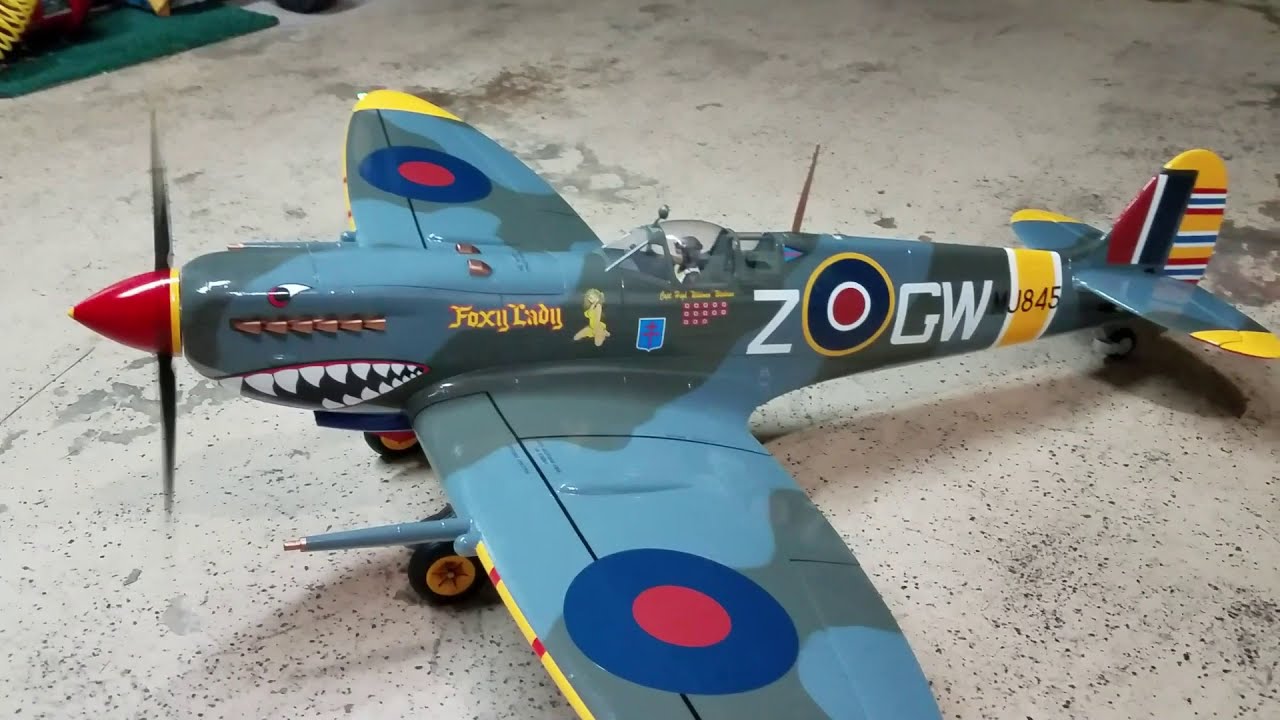

Very nice! Is it possible to have the engine sounds stop when the electric motors stop?
Yes, unfortunately I did that video at the beginning and had not yet "programmed" the start and stop of the props with the sound. But to do that, you have to be somewhat "creative". It took me a while to figure it out and I had many conversations with Andrew (owner of Mr RC Sound) and one of his associates who lived in London. I came up with a method that they had not thought of, but seemed to work, at least for me. The main problem I found was that the sound started when you advanced the throttle (which was OK) and shut off when you dropped it to 0 (also OK) but if you did that while taxiing to the runway or even at times while you were flying-especially landing, the sound shut off and then recycled back on, defeating the overall purpose. So this is what I came up with so the sound comes on just as the prop spins, and only shuts off when you are done flying and taxiing and the props stop rotating and never at any other time.Originally posted by TedP View PostVery nice! Is it possible to have the engine sounds stop when the electric motors stop?
In essence I'm using my throttle cut switch to enable the sound to come on and shut off when I want it to. To do this, you essentially have to "trick" the board in the following way (these following settings work on the B-24, but each plane and ESC are a bit different and require unique settings but the concept is the same and I have these boards in all my prop warbirds and a few other prop Bi-Planes):
1) Program the ESC as you do with all planes for throttle travel, ie, turn on TX and advance throttle to full position, then plug in RX (should remove props for this so a disaster can't occur), after getting single beeps, drop throttle to 0, then the ESC arms and you have the throttle calibrated.
2) Determine the point with throttle trim switch that the props just start to turn slowly, in the case of my B-24, that's at +52 in throttle trim.
3) Disconnect RX and reduce trim back to 0, then plug the RX back in so everything is calibrated correctly. Do not power up the Sound board yet.
4) Now drop the throttle trim to about -34. Now connect the sound system power.
5) Engage the throttle cut switch, and I happen to use Switch H for that and have the position at -110%. At this point, the servo position that you would see in the screen showing travel that the throttle position is virtually same when the throttle is on and -34 trim as it is with the throttle cut on.
6) Now with the throttle still cut, advance the throttle trim to that +52 position. Since the throttle cut switch is still on, the props don't move and the board thinks it starting point is still at the -110 when you plugged it in. The sound should also still be off.
7) Now you're ready to fire up the engines and begin taxiing. Release the throttle cut switch-turn the throttle on- and the props should just start spinning slowly and the sound system should begin it's start up sequence. The sound will stay on now, no matter what you do with the throttle stick. If you don't like the props spinning when you drop the throttle to 0, you can always reduce the trim down a few notches but that little amount of trim is not enough to shut the sound system off. Go and fly, bring it back to the pit, then turn the throttle cut switch and the sound and props stop at the same time.
As I said, each plane and ESC is a bit different and you may have to tweek the trim amounts and values of the throttle cut position to get it to work perfectly all the time. I found that the throttle cut position should be close, but not lower than the bottom trim position you plug your sound system in at (in this case -34). I also found that a trim range from low (point you plug the sound in) to high (point the props spin) is usually somewhere around 50 to 80 points, again depending on the ESC and plane.
One thing to absolutely remember, after flying and everything is shut off and disconnected, return the throttle trim to 0 for the next flight because you do not want to turn the TX on and power the RX with the throttle at that upper trim amount (+52 in my case) as it will throw the throttle calibration out of whack.
The following 3 videos show the sound system and props turning sequenced better in my Spitfire, Corsair (following posts) and P-51.
Any questions, please ask or even PM me and I'd be glad to help.Hugh "Wildman" Wiedman

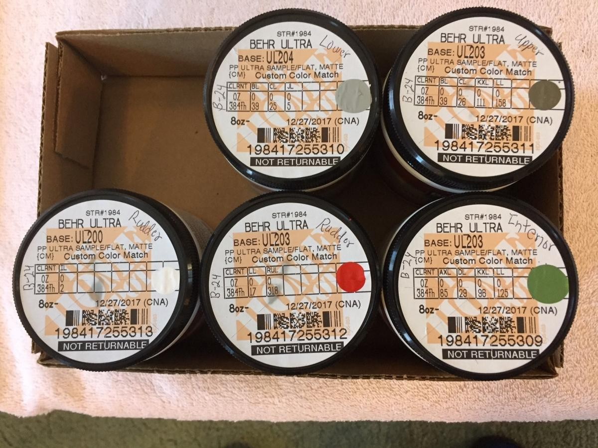

Post #46 on this thread has a Home Depot matching to all the colors. You can take the numbers to a Home Depot and they can make you a copy of any of these. If you download the photo and zoom in the color numbers are readable. In fact, if I recall they can just type the 12 digit serial number. It is unique, and can pull up the color numbers. Anyway, the Home Depot paint guy should know what to do.Originally posted by Scornette View PostDoes anyone know where I can get the olive green paintDoes anyone know where I can get the olive green color for touch up
Having said that, it is also a bit of time and money. I often just pull out my acrylic paints, pick the closest two, and try to mix to match. Sometimes I hit, sometimes I miss. But usually it's good enough to call the job done.

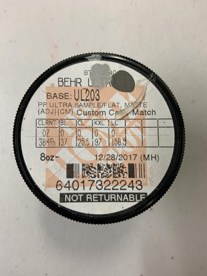

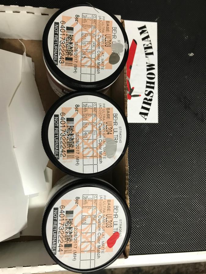

EDIT: OK, it is only #46 if you filter by "photos only". Sorry for that. Anyway, attached is the photo so you don't have to hunt for it. It is the photo with 5 paints in it. And then when posting this photo, I noticed two other paint photos in my B-24 directory. I don't think I would have put them in that directory unless they came from a post where somebody else matched the B-24. So I think these represent several independent attempts.
EDIT2: I notice the numbers on the second two match precisely, so there were only two independent attempts at optical matching. I guess you could average the color numbers.
Let me try to clear this up. Those lower pics in Gringotuerto's post were mine. The ones that are 3 in a box. They are all very good matches - nearly perfect as I had them scan parts. The one with two colors is the OD green. The HD employee just put the wrong color on. I should have removed the grey color before posting the pics.Originally posted by Gringotuerto View Post
Bob
As I said in the edit - it is only #46 if you first enable the filer "Photos Only". Apparently it is the 46th post that contains a photo. I didn't know how to link to it more easily, so I just downloaded and re-uploaded the photo above.Originally posted by Scornette View PostI don’t see anything about paint on #46
Bob, thanks, apparently I got that from one of your old posts.Originally posted by borntoolate View Post
Bob
Anyway, the photos above are two independent optical scans, and of course optical scan doesn't come out the same every time. So for someone making a new batch, one reasonable thing would be to average the color numbers. They both contain pigments BL, CL, KXL, LL. One is 39, 26, 111, 158, the other is 37, 25.5, 97, 158.5. So the average is 38, 25.75, 104, 158.25. But I think HD doesn’t support 0.25 increments, so for any average ending in 0.25 you have to round one way or the other.
Or if this is too complicated, just pick one or the other and use it.
Agreed!Originally posted by Gringotuerto View Post
