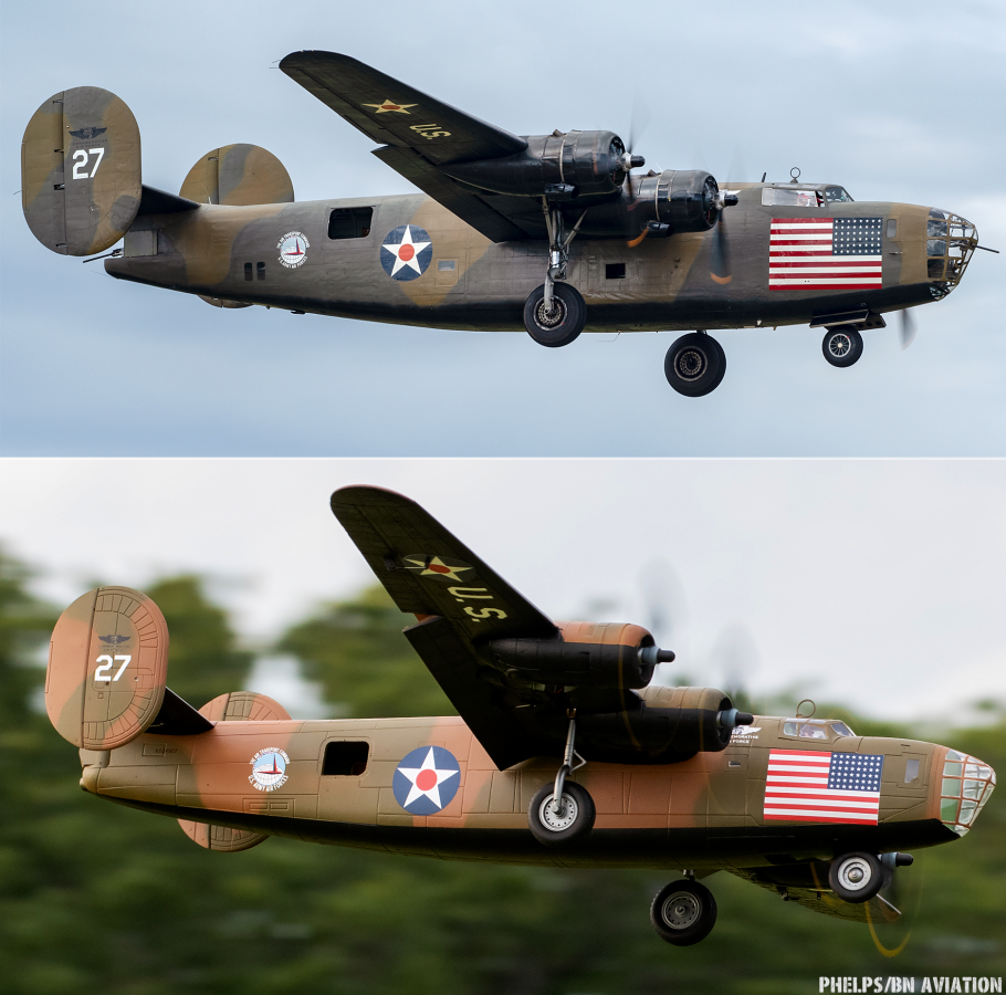

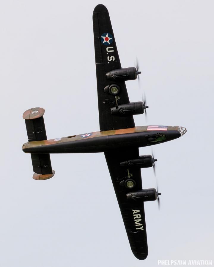

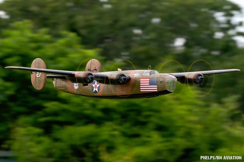

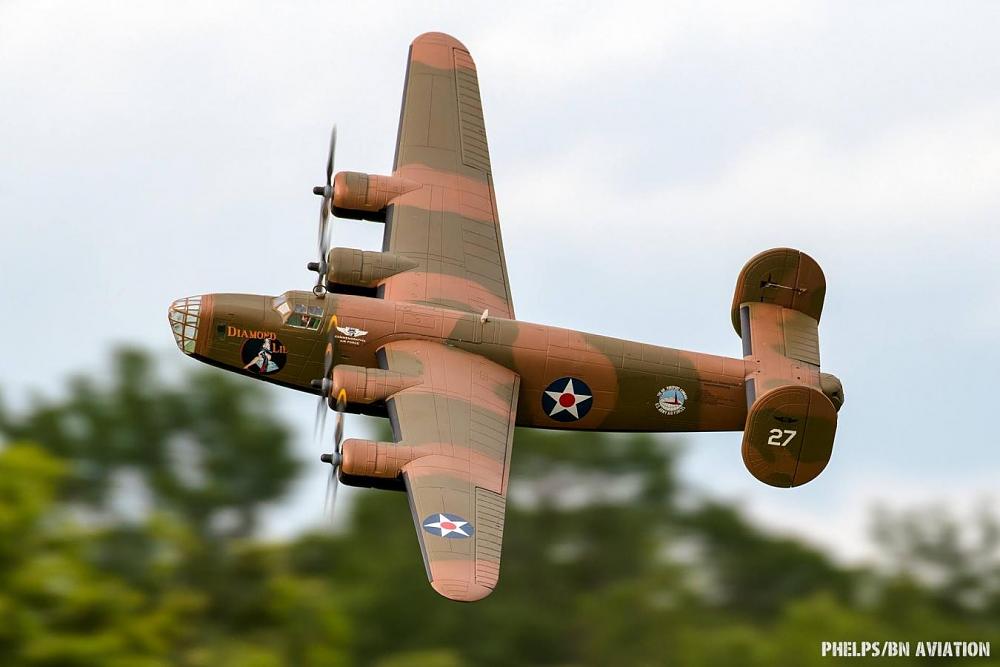

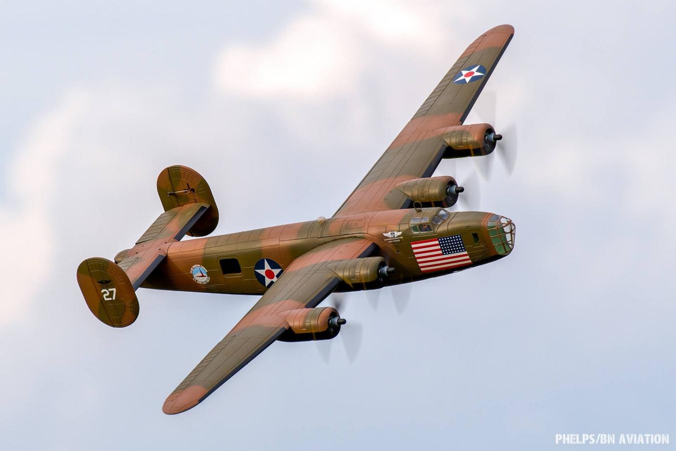

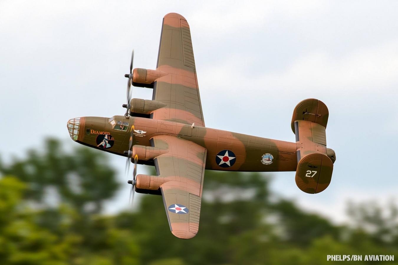

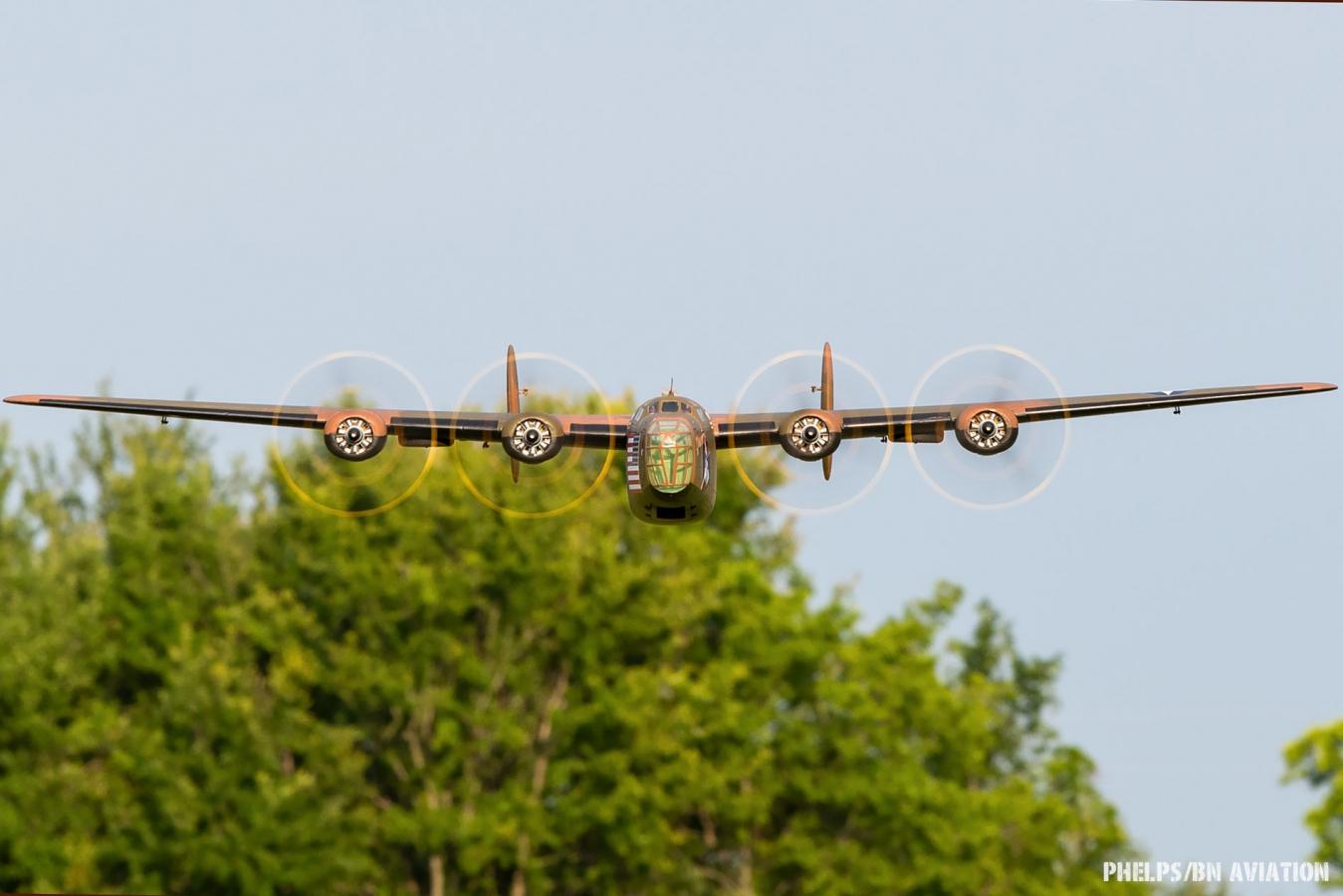

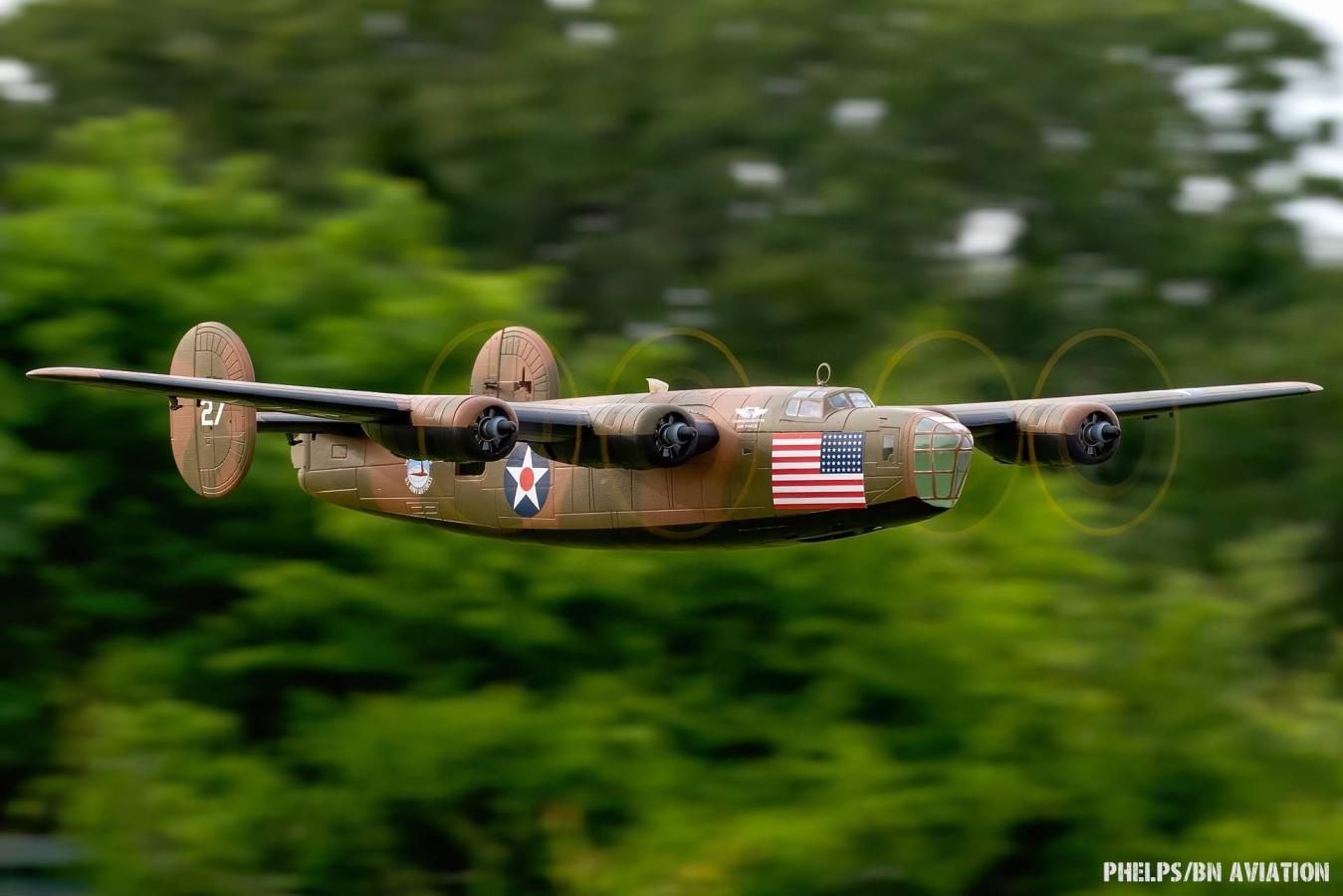

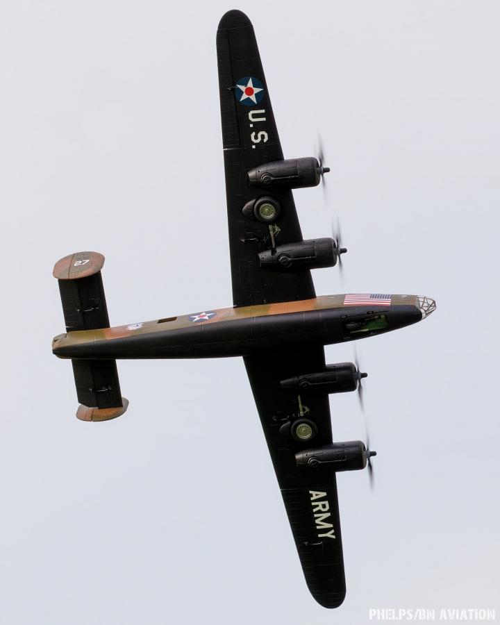

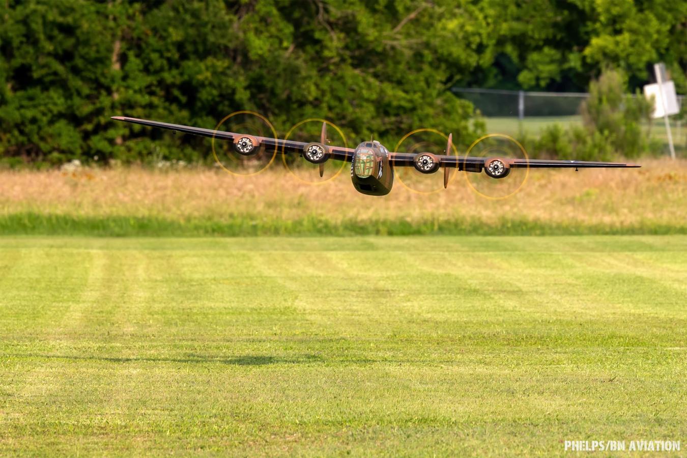

            I finally got my second B-24 flying, complete with a photoshoot from my friend Dylan Phelps.

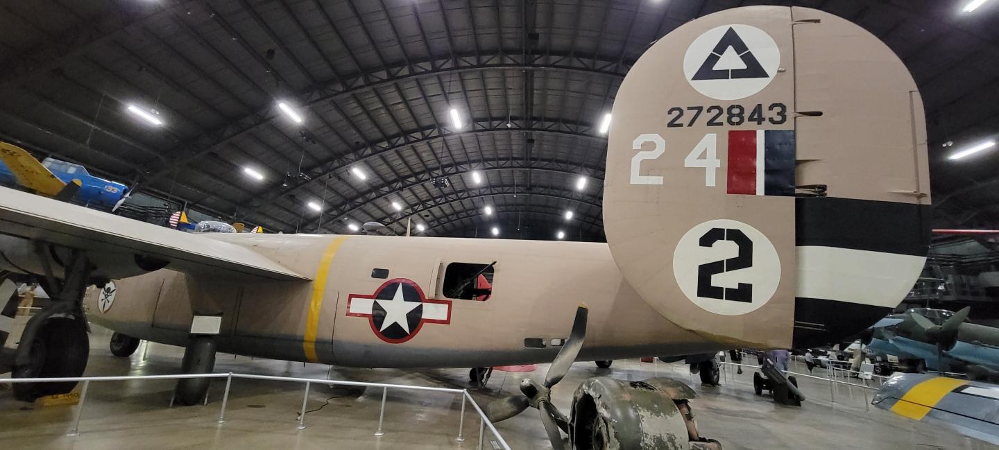

              Beautiful! Hope to get my first one maidened this month.

                  TLewis95 incredible photos and a terrific looking B-24. Congratulations, you did a spectacular job!

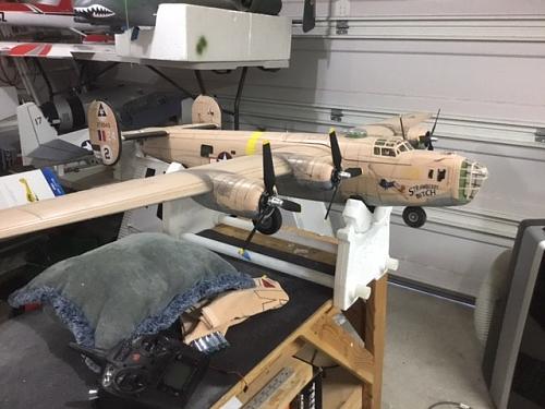

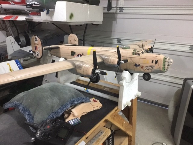

                    Here's mine. Great scheme.

                      Looks good. Lot of work on those panel lines and oil spray.

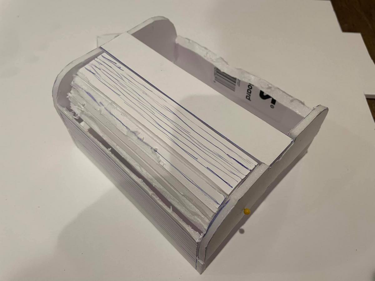

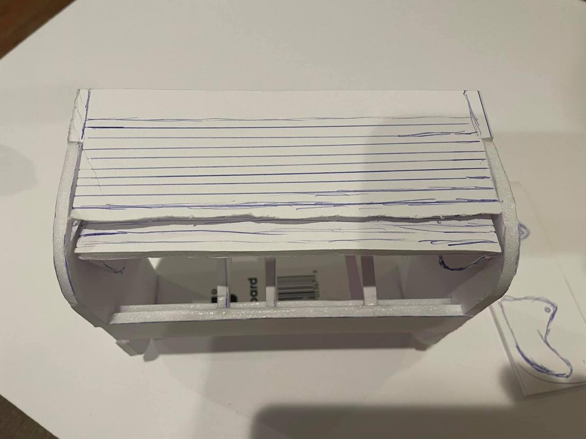

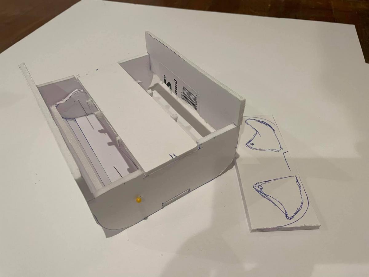

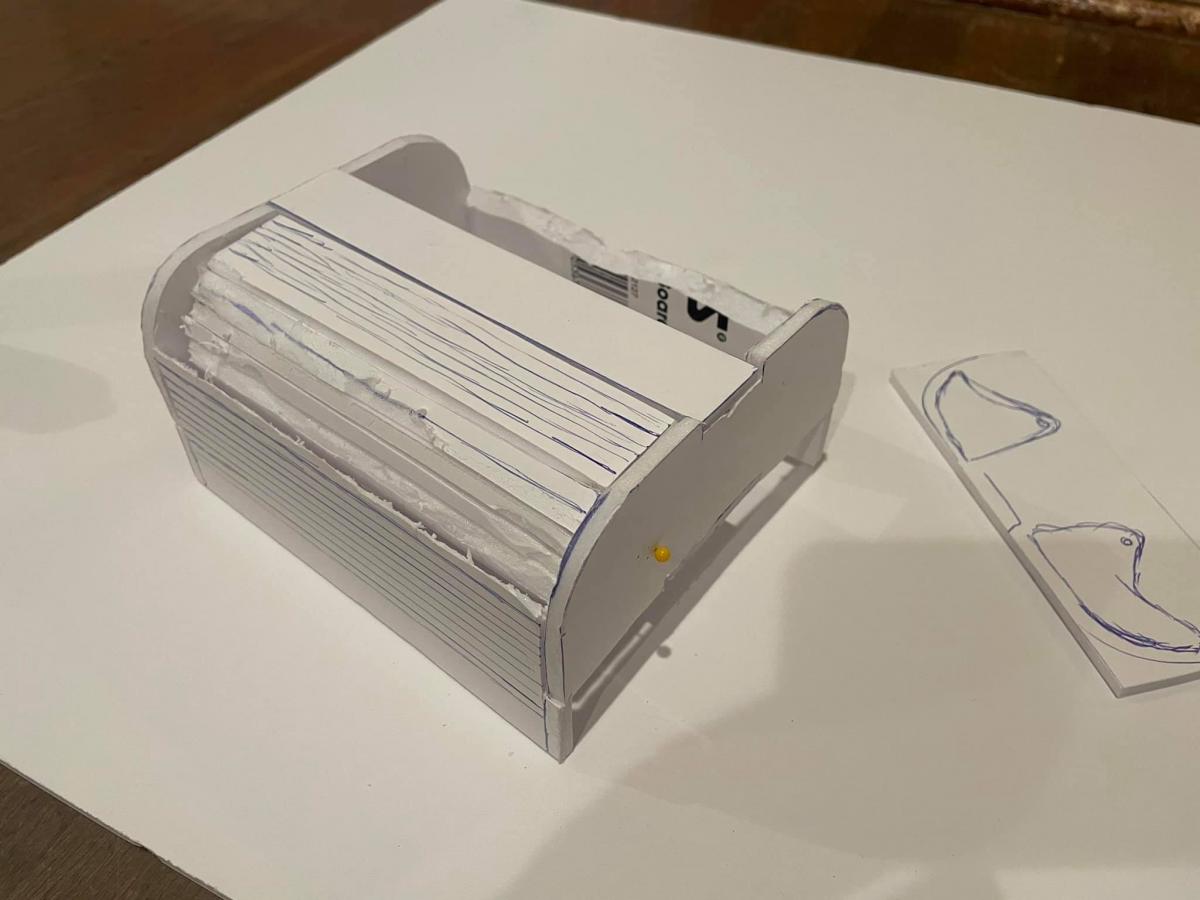

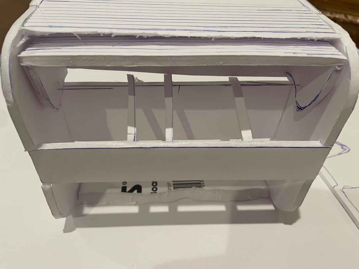

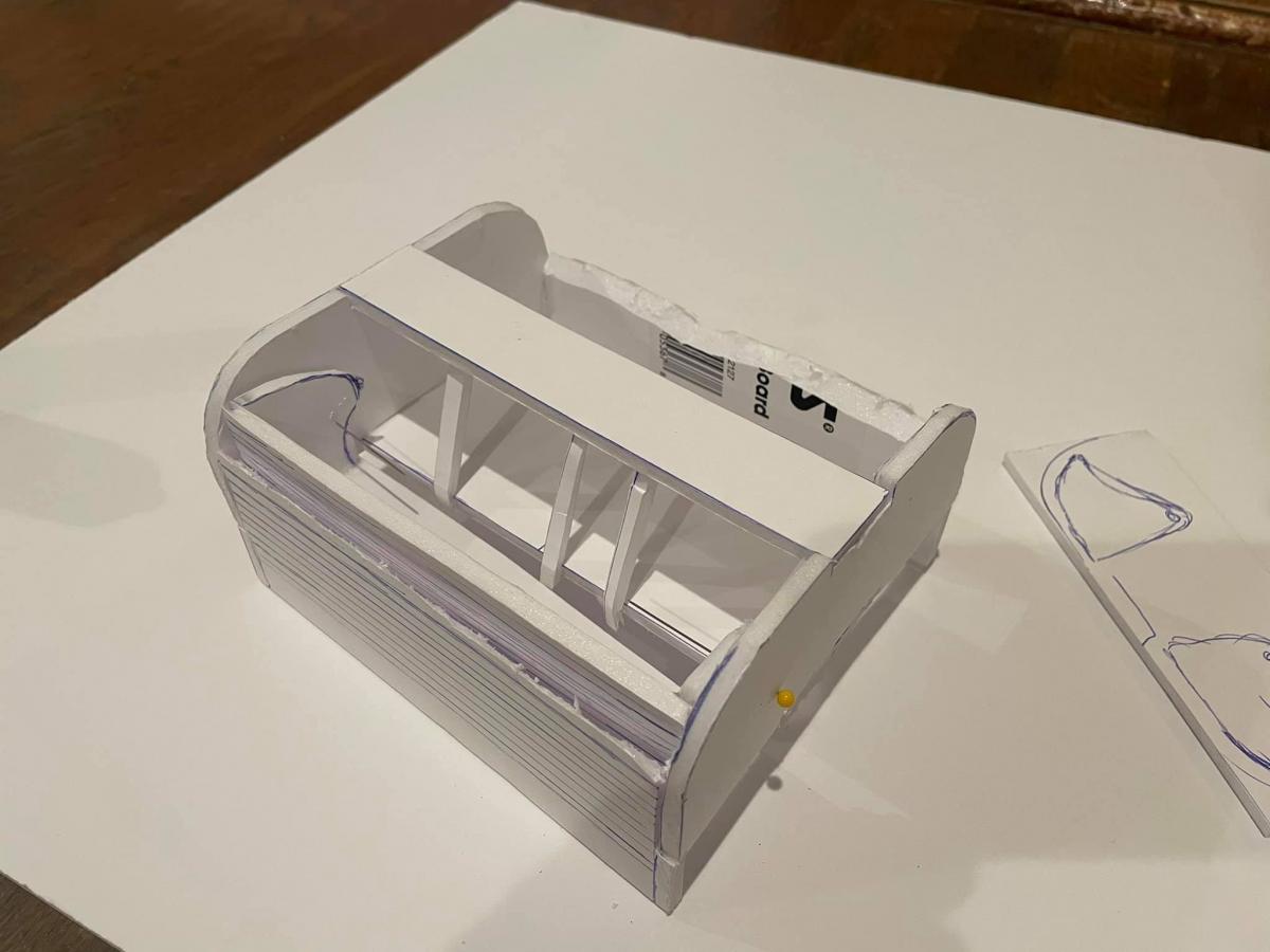

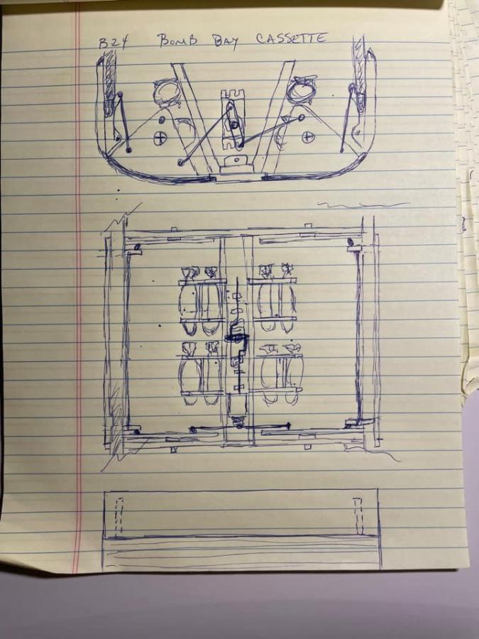

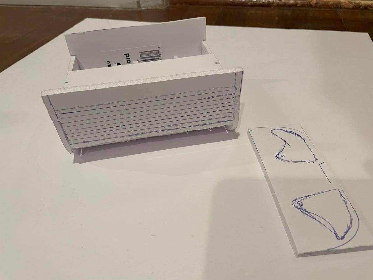

                              Alpha how about another ALPHA MAKES session and lets knock out a BombBay Cassette
                              combination of flat panel slide and clam shell doors for a faux articulated garage door setup.
                              One servo to open/close doors, and one servo (or eflite bomb release) to activate the bomb drop
                              My thoughts are a faux garage door. 2 Vertical Doors to simulate the doors rolling up the outside. use a connecting point like on integrated hinges on landing gear doors to slide within a channel up the side, then 2 clam shell doors to simulate the rolling open on the bottom. Probably need an off-set hinge point on the clams so the arc is more internal than outside the fuselage side. Connection to the side door by pushrod would slide it open and provide relief for clam shell to stow upward. Then lower into closed position when servo closes bay.
                              One servo operates the doors. A second servo (or eflite bomb release) would be used to release the bombs. basically use a rubber band attached to the cassette roof, holding bombs to bomb rails, connected to the release mechanism.
                              glue a piece of light plywood on the fuselage ceiling, then you could screw in the cassette and it would be easily removable for servo/mechanism maintenance if required. With Cassette attached, structural integrity should be unaffected. may be fore/aft attachment point on vertical walls as well.
                              Now if i only had skill and experience to draw in Fusion or other CAD and test movement of the operation
                                  This is already on Thingverse.
                                  Download files and build them with your 3D printer, laser cutter, or CNC. Thingiverse is a universe of things.

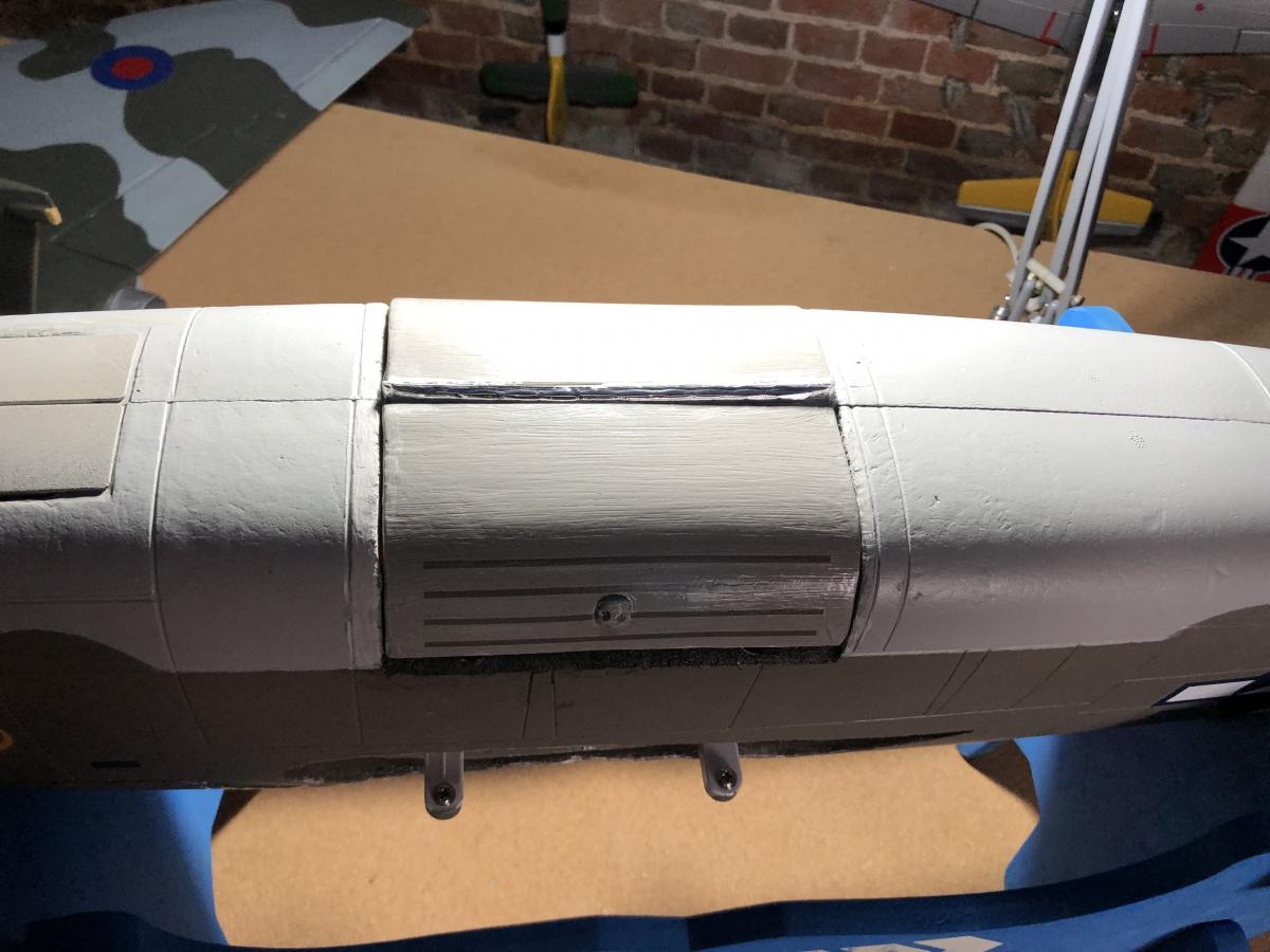

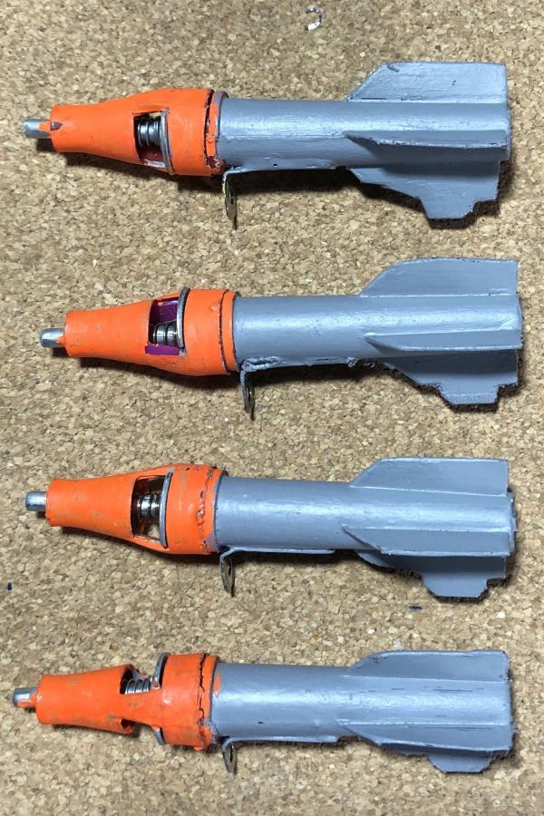

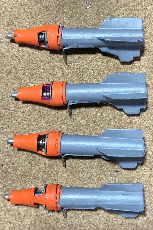

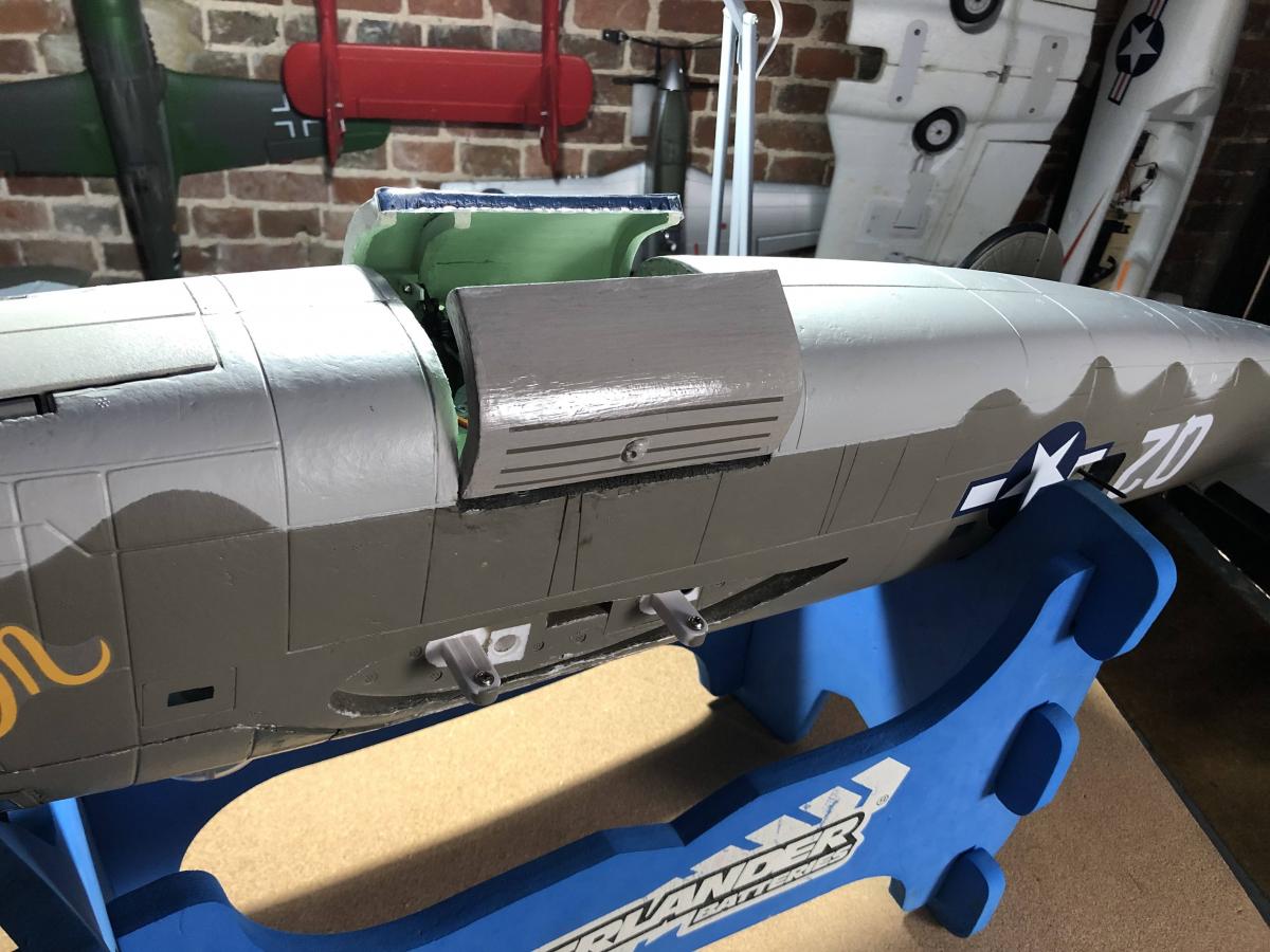

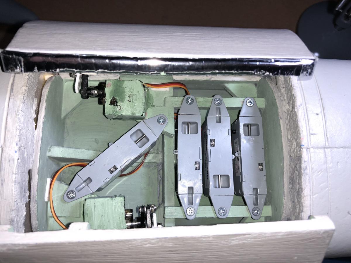

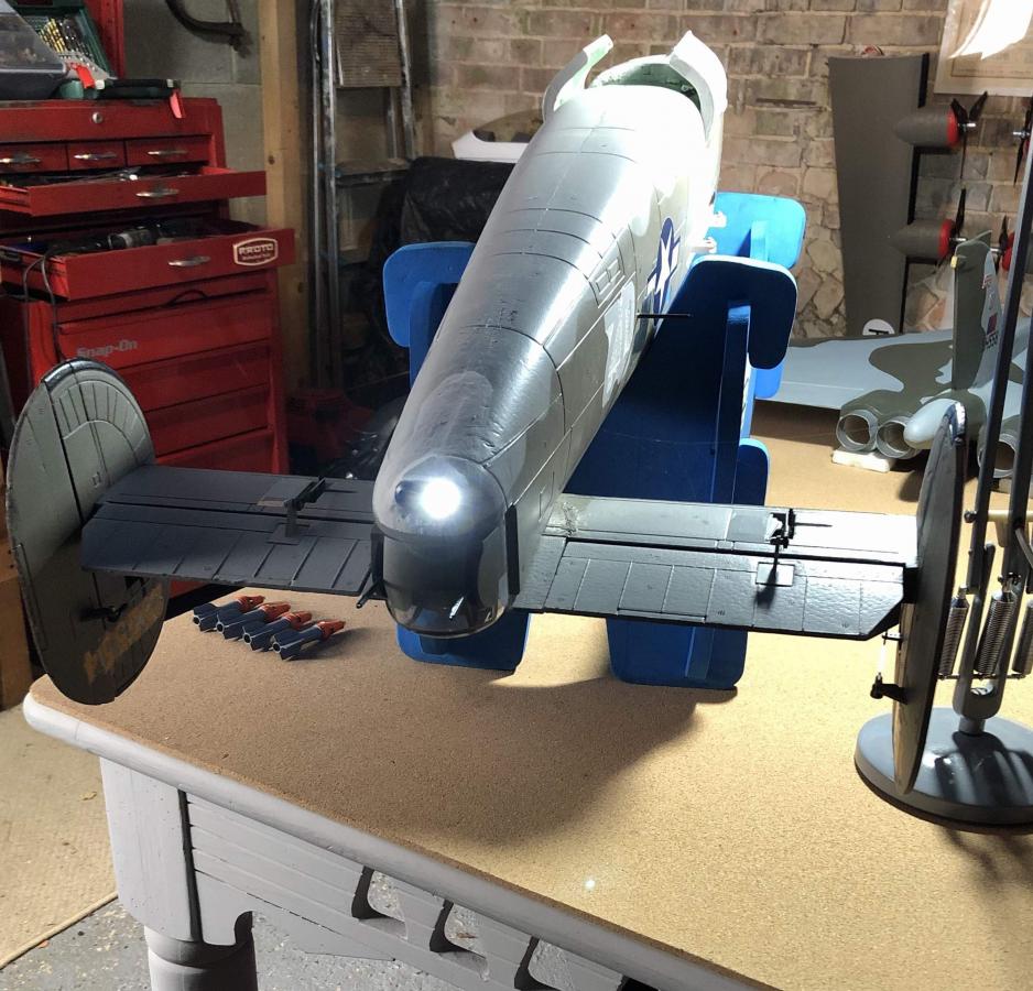

                                    Here's my take on the way forward with the bomb bay:
                                    First off buy some retro cap bombs off eBay and modify slightly:
                                    Click image for larger version  Name:	Cap bombs.jpg Views:	0 Size:	117.1 KB ID:	326004
                                    Cut open the "first bomb compartment" on the B-24 and make up some balsa doors to add:
                                    Click image for larger version  Name:	Bomb doors.jpg Views:	0 Size:	101.5 KB ID:	326002

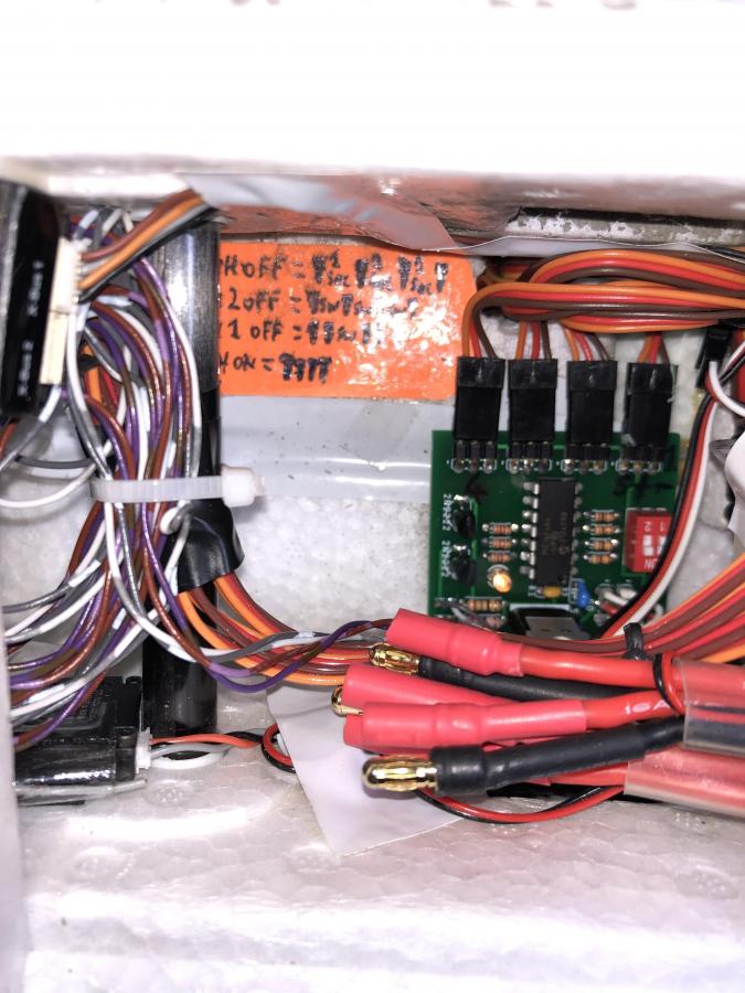

                                    Add a control circuit (from Daves R C Electronics - operates doors and drops bombs from a single channel using a 3-way switch on your TX):
                                    Click image for larger version  Name:	Bomb controller.jpg Views:	0 Size:	86.3 KB ID:	326003

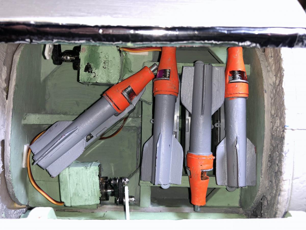

                                    Make up a balsa structure to fit inside the cut open bay to strengthen the fuselage and mount E-Flite Payload Release Mechanisms and door servos:
                                    Click image for larger version  Name:	Bomb doors open.jpg Views:	0 Size:	126.2 KB ID:	326005
                                    Click image for larger version  Name:	Bay release units.jpg Views:	0 Size:	130.3 KB ID:	326006
                                    Clip in the bombs:
                                    Click image for larger version  Name:	Bombs loaded.jpg Views:	0 Size:	135.1 KB ID:	326007
                                    Test it all works (4 bombs can be released singly, all together, all together with a one second delay between each or in pairs):
                                    Add tail lights for good measure (white light illuminates when bomb doors are open - the second light is red and operates when bombs are dropping but didn't stay on long enough for me to get a photo' !):
                                    Click image for larger version  Name:	Doors open light.jpg Views:	0 Size:	129.3 KB ID:	326008
                                    It all sits close to the C/G and the 'plane balances OK (with a small video camera in the nose turret). It's not scale but it's fun :D

                                      Mikdys I LIKE IT! Well done!

                                        Tried out the bomb bay mods at the field today - all went well part from my bombing accuracy! Here's some video from the front turret:
