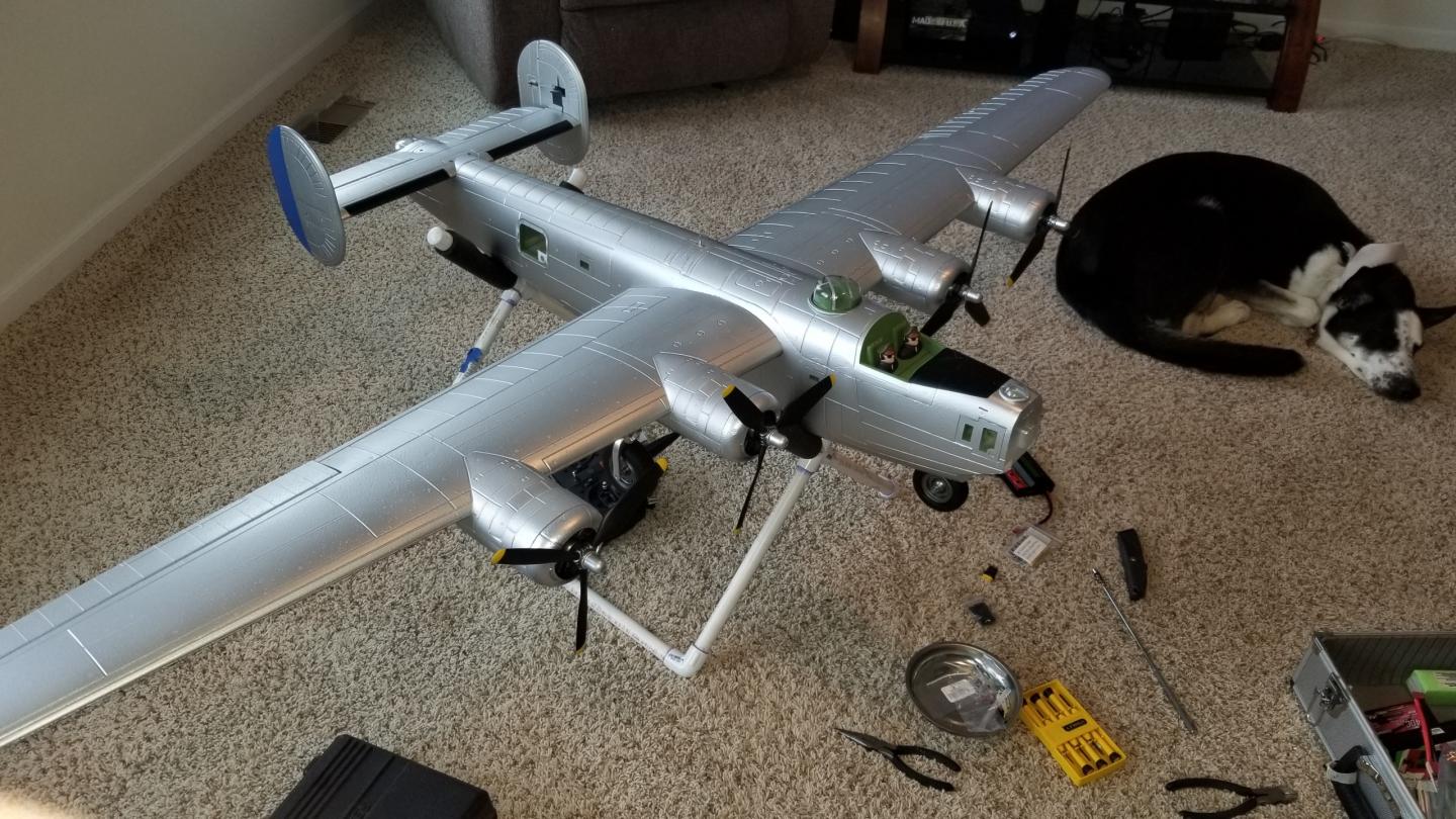

                  I finished the preliminary assembly of the silver Liberator, my faithful assistant Freya was also pictured taking her hour long mandated nap.

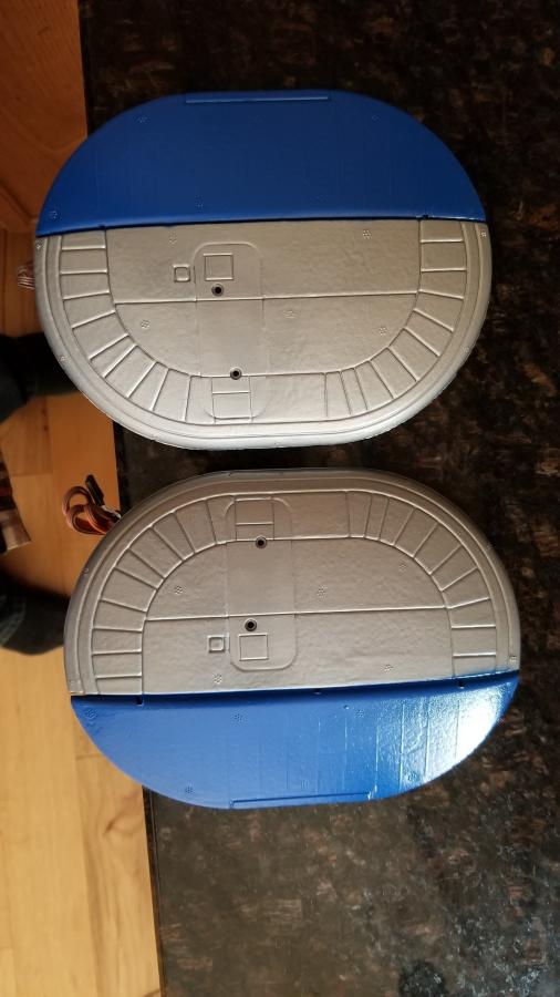

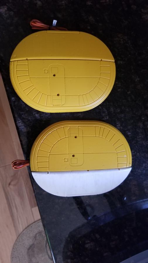

                  The Lib had the yellow rudders so I primed them with white and black latex before a coat of Krylon rattle can aluminum and blue.

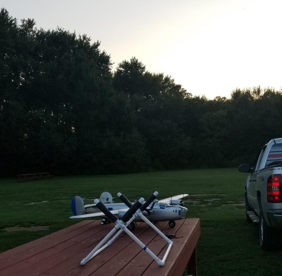

                  Got a picture of the plane after the maiden, sorry it's dark as it was dusk and the sun had ducked behind the trees and light was going pretty quick.
                  I CGed her with two 3S 5000s but found her to be a bit tail heavy so I put in some 4S 3300 which moved the CG forward a bit, but she was still a skoch, a scientific term(?), tail heavy. I flew her with the 4S 3300s and found she was pretty fast and leapt off the runway after a very short run. She was very tame on the flight, 3 minutes, and it was without incident and landed finding the batteries were down with 78% still remaining.
                  Second flight with fresh batteries was also uneventful with 6 minutes dialed into the timer and landed with mixed throttle at 67% remaining in each battery.
                  She settles in really well on final to touchdown, I really like this plane. With the 4S she took off in shorter distance than my F-86, and I'm pretty sure she will outrun her escorts...
