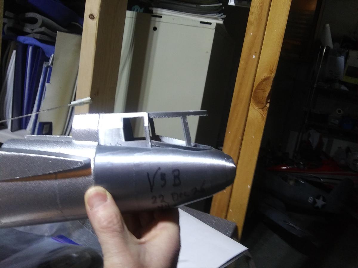

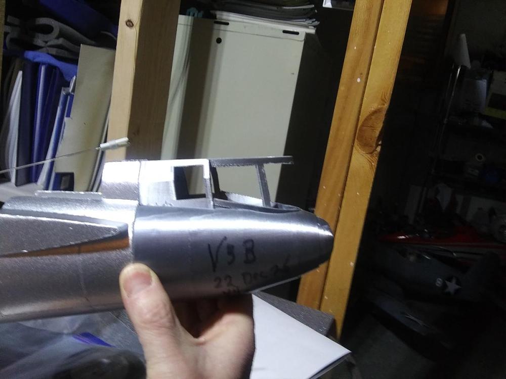

                          Hey guys, busy in the Grossman 56 Hangar!
                          I think we finally have a working version of the Cheyenne Turret after many iterations.
                          Click image for larger version  Name:	20251228_122132.jpg Views:	0 Size:	108.7 KB ID:	441740the only thing left is to design a piece to eliminate the 'block on the fuse and create something that blends the two together a bit better.
                          Click image for larger version  Name:	20251228_121853.jpg Views:	0 Size:	80.9 KB ID:	441741 Click image for larger version  Name:	20251228_121936.jpg Views:	0 Size:	85.0 KB ID:	441742
                          I'm liking it
                          As regards the separate tailwheel channel that DD suggests, sounds like a good idea as I notice that the stock tail wheel is attached to a very unscale like long arm aka the FMS Pitts. So, I under stand assigning a new channel to the rudder stick and keeping the throws to 125%. So a rudder/tail wheel mix ?? I remember watching an interview with the pilot of a real B17 and he was saying that the very seldom if ever use the rudder because she just doesn't need it. Dave's B17 has the FMS retract system where the pin on the retract fits into a 'sturrup" like plastic piece with a separate servo to steer when the gear is down, aka the FMS P51 and P40. So by doing this mix and cranking the throws for the tail wheel, we should be good??
                          Dangerous Dan)

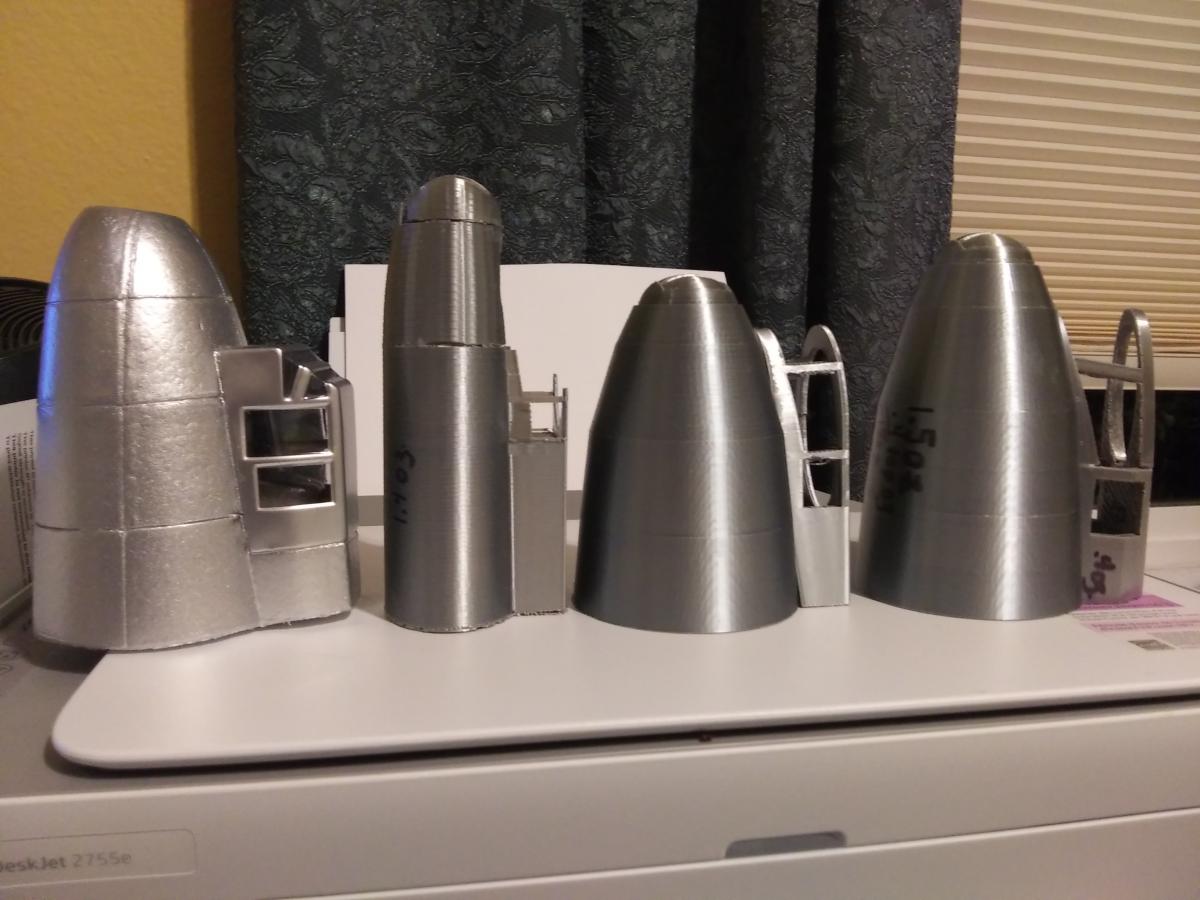

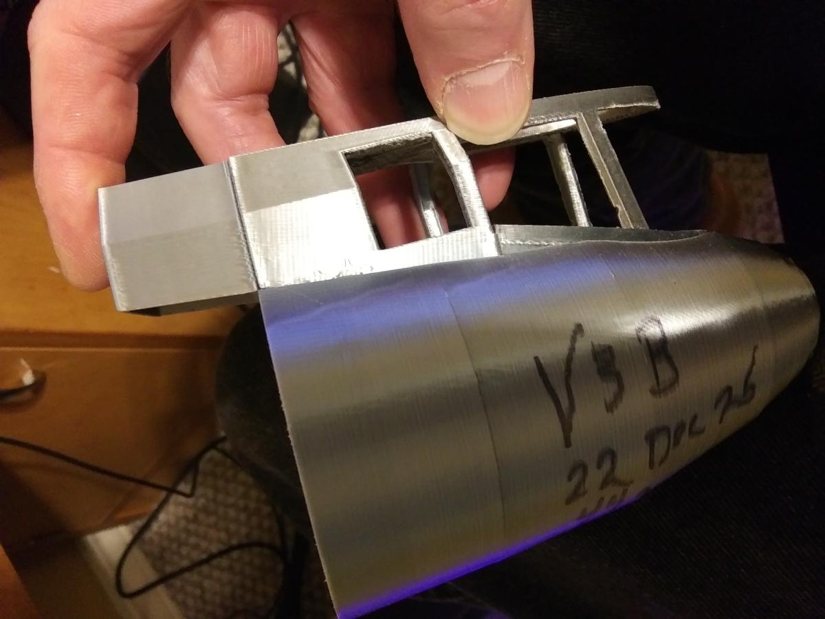

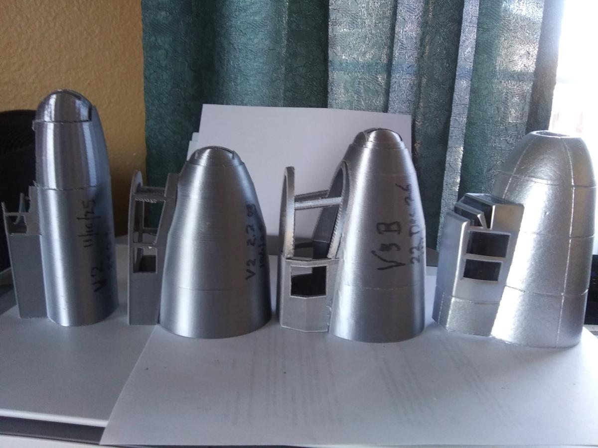

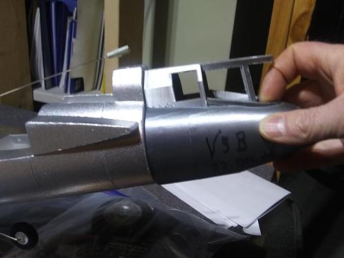

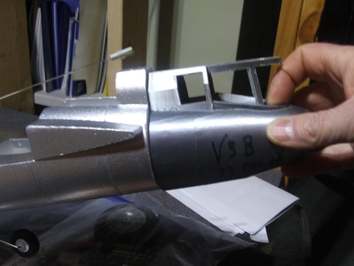

                                  So many projects....
                                  All of us who have tried to design something using Tinker Cad or like programs, know how many wacks at the cat it takes to get it right. Right?
ID:	441859Number one is the original tail turret, called a steeplechase turret for some strange reason and 2, 3 and 4 are the progressions, four being the final. Dave dropped off the transition piece today and it fits perfectly.
                                  I'll have to do some trimming on the spare fuse and fit it in.
                                  Lots of hours of work on the PC:flushed: enough to drive you as you the ways of achieving what you envision until suddenly:astonished: THERE IT IS
                                  (Dangerous Dan)

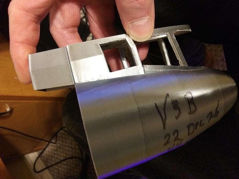

                                          I'm liking it
                                          Dangerous Dan)
