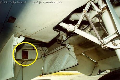

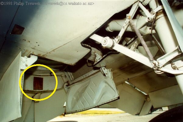

                  I C somewhere the Corsair had an amount of grease in the wheel well. to help those grippy tyres(not b so grippy) :
                  ...and a greased piece of plywood in the rear of the wheel wells to stop the wheels from spinning after retraction.
                  Maintainers and maintenance chiefs seem to be quite the innovative group.
                  Best, LB
                      Best, LB
                      Click image for larger version  Name:	ANNF4U6-205092123.jpg Views:	8 Size:	58.6 KB ID:	441097
                      I did not know that about the Corsair. Cool info, Elbee! In the airlines, they are called "nose wheel snubbers." They are something similar that slow down and stop the rotation of the nose wheels when they are brought up into the nose wheel well after rotation. So, on some of these airplanes, the nose wheels are spinning at 200mph as the gear is retracted and they hit the snubbers. In the cockpit, you can Definitely hear them and feel the vibration and loud noise as the nose wheels go from that speed to stopped in just a few seconds. When you look at them inside the landing gear wheel well on the ground, they are covered with rubber dust and dirt from repeated stopping of these fast-moving tires. I'll never forget that noise and racket they make when they come up just below your feet in the wheel wells.

                          Our DC 3 had the same thing in its retract bay. I would think that once airborne, hitting the brakes would do the same thing, but this takes one thing off the pilot and copilot's list so that's probably why.

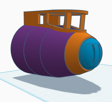

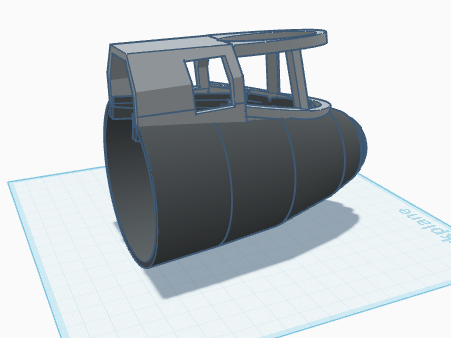

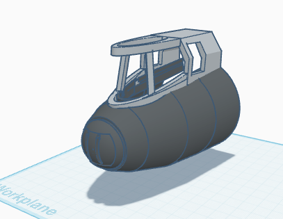

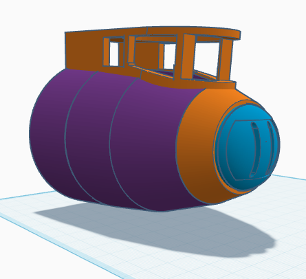

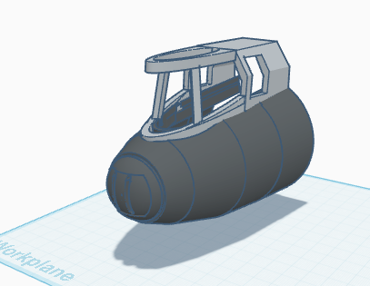

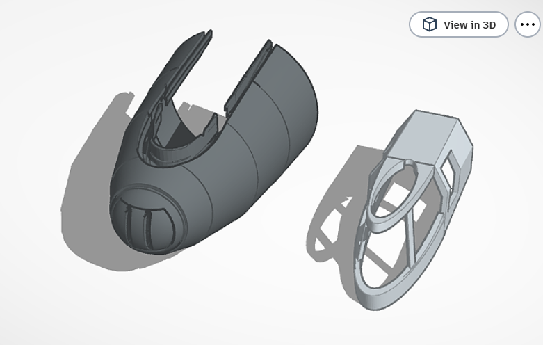

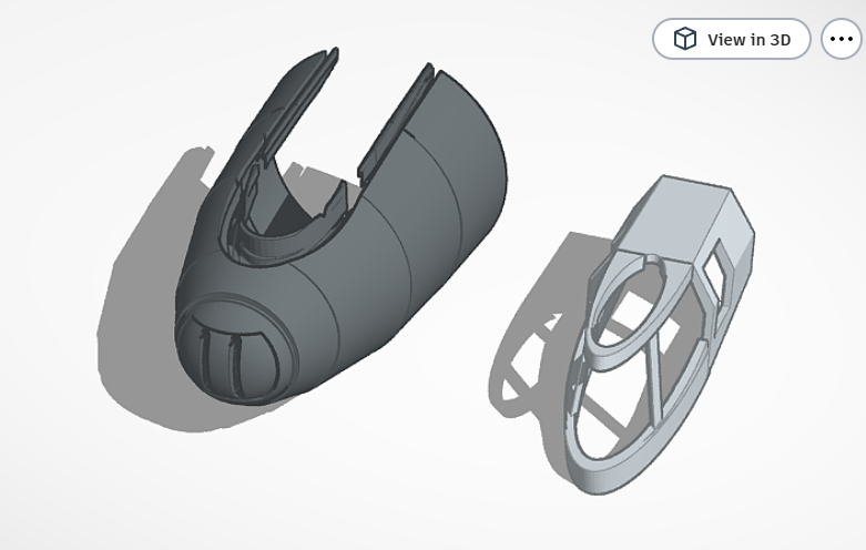

                            The Cheyenne turret is coming along, better and better with each version. Dave printed V2 and it's pretty cool,
                            The top piece detaches from the bottom and I made some indents so the pieces fit nicely.
                            When we started to critique it, there were some changes that had to be made to the top portion. I purposely made the bars thick in an effort to get the danged thing to print. The one thing I didn't do that definitely had to be there was to shave off the sides to make it hexagonal rather than square. So try try again. Good news was that the bottom portion looked great
                            So V3 Was inevitable...
Name:	Screenshot 2025-12-14 141505.png
                            I sent Dave the file for V3 and of course, got the 'did I' curse of every designer, so I'll open the file and check off everything, so far, so good though.
                            (Dangerous Dan)

                                #235
                                Grossman56,
                                Good lookin' design, Dan.:white_check_mark:
                                The devil is in the details, as "they" say.
                                Remember that CA adhesives weigh nothing, so printing in several parts to get better quality is many times a plus with some designs.
                                Just a thought.
                                Best, LB
                                  • 7419

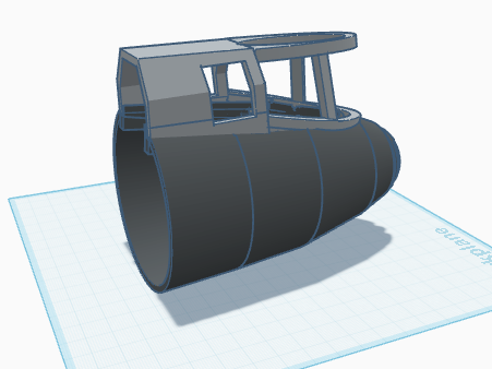

                                  #236
                                  I agree and so much easier to play around with two focused pars, then join them to correct the overall dimensions.
                                  I think we may have a winner with V3B, we'll soon find out.
                                  Click image for larger version  Name:	Screenshot 2025-12-22 103939.png Views:	0 Size:	62.1 KB ID:	441445 Click image for larger version  Name:	Screenshot 2025-12-22 104009.png Views:	0 Size:	85.6 KB ID:	441446

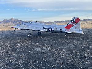

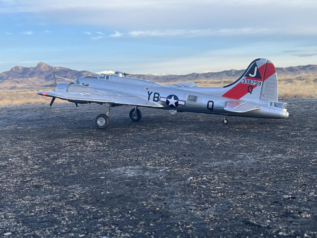

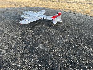

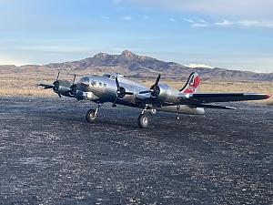

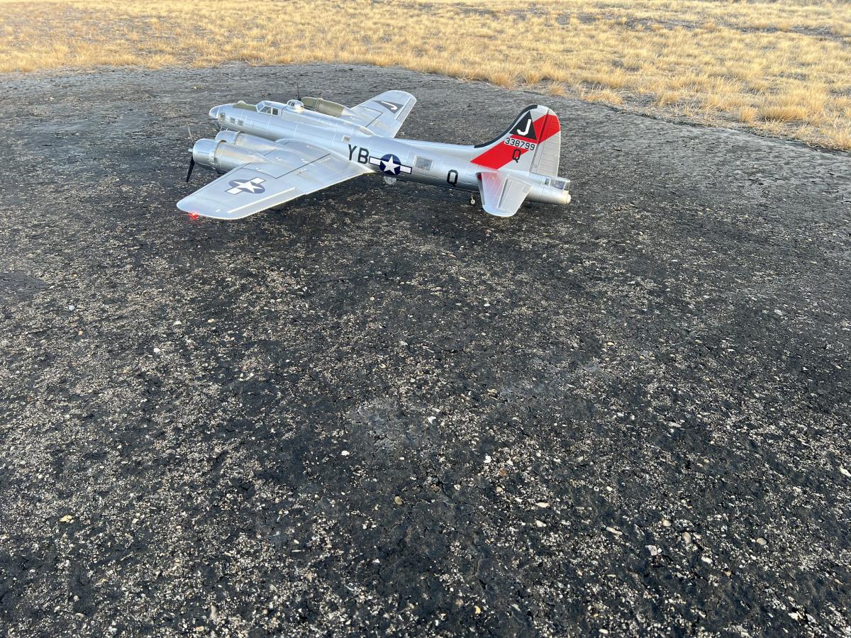

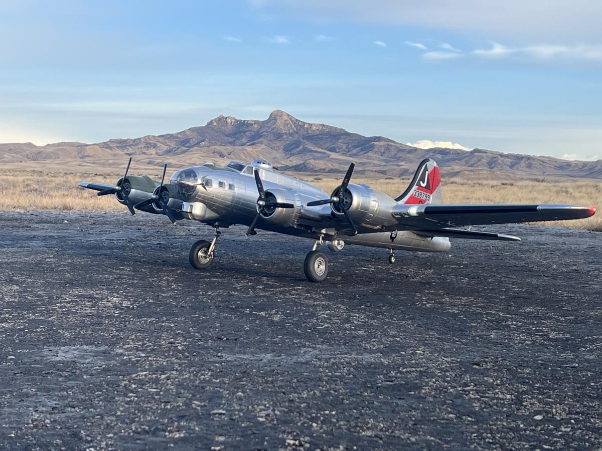

                                    I took my Heaven Can Wait to the field for a series of runup, taxiing, and just familiarization tests at the field. What I found was dsturbing (for me.) Our field has a paved E-W runway and a shorter N-S runway, adequate for most of the flying we do there. There is often times some winds, usually crosswinds that have to be dealt with. What I found this morning with even a very light and changing crosswind for taxiing, is that this huge 1875mm wing weathercocks to the point that I don't really have control of it. Plus, the steering of my retractable tail wheel is pretty sloppy to quickly compensate like most tail draggers need to do for directional control for takeoffs and landings. My FMS P-47s for instance, which use the same tail wheel mechanism, don't exhibit tthe issues I found this morning with the B-17.
                                    I did get some high speed taxiing in, but the airplane was barely controllable, departed the runway several times and nosed over. On one occasion the #2 prop struck the ground slightly, but it is still not operating and I"ll have to figure what is going on there.
                                    In summary, it is a very nice looking plane, a fitting tribute to my late father in law Fred and his crew, but I'm pretty sure if I had tried to fly it today, it probably would have crashed.
                                    So, I'm going to rethink flying it. It might be better to find a home with the 351st Bomb Group Association and hang it somewhere there for many others can appreciate it.
                                    I took a few pics this morning during the test runs.
                                    Cheers
                                    Davegee

                                        Thanks, Rex. Since this is a "tribute aircraft" the idea of experimenting with a highly erratic aircraft and crashing it after the first or second flight trying to get it figured out would be very undesirable. I'm disappointed that it wasn't up to par for a flight this morning, but I think it's good to explore whether a collector or a museum might be interested in it to hang it on display.
                                        This aircraft (the real one) was flown on two consecutive missions in two days by my father-in-law and his crew in late 1944. The first mission was to Kaiserslautern on the German/French border (now home of Ramstein Air Base) and a subsequent bombing mission the next day to Munich, Germany. I was taken by the coincidence that almost exactly 70 years later, I flew a fully loaded military troop charter on a 747-400 from Baltimore to Kaiserslautern, but after holding overhead for an hour for them to try to clear the runways of ice so we could land, we diverted to Munich. In our case, we fueled up and landed in absolutely horrible weather and icy conditions at Hahn Air Base, near Frankfurt.
                                        I'll post the future of this airplane as things pan out, hopefully.
