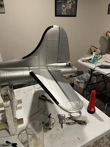

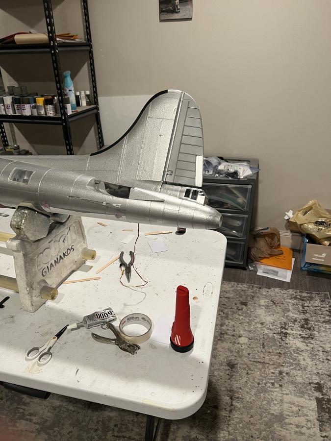

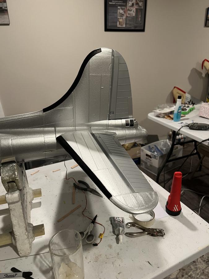

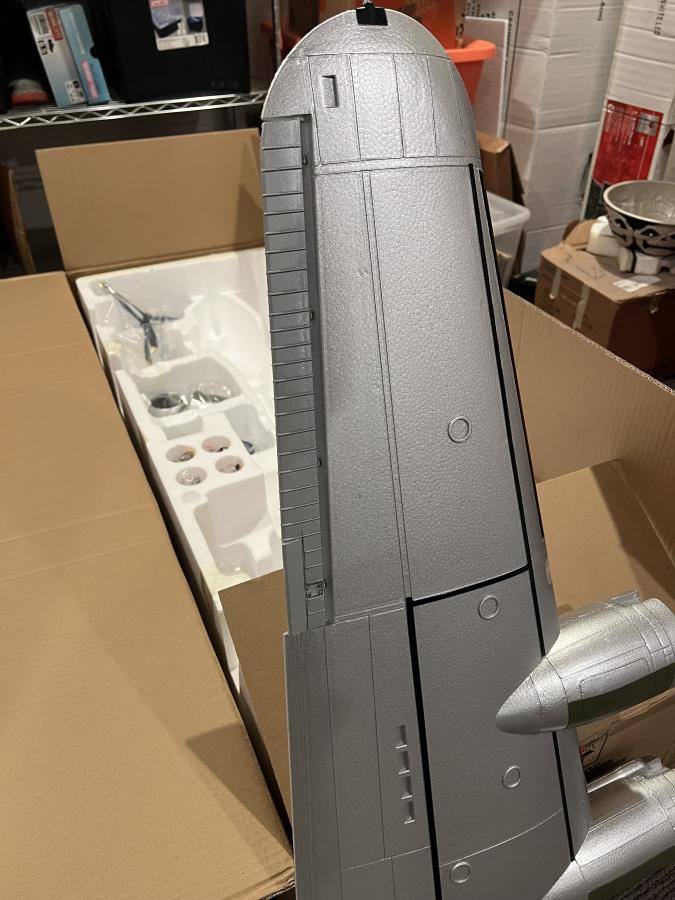

                I'm attaching a couple of pics of some enhancements I'm making to the control surfaces of this airplane. Some, or many scale afficionados of WWII airplanes already know that some of them had fabric flight control surfaces back then. To get that look, I sprayed the surfaces with Tamiya grey primer/surfacer, masking around the trim tabs that were metal and I wanted to remain shiny. I then painted over with aluminum paint, and then a flat clear.
                Back then, on almost all American built planes, the aileron trim tab was limited to the left aileron only, for both fighters and bombers. I made the trim tabs to look a bit articulated from neutral, mainly for the visual effect. I used a razor saw and exacto and gently pried them up to the desired position.
                With a retractable tailwheel installed, I found that it was in the way of the molded block of foam on the horizontal elavators and had to carve that out a bit to give the tailwheel enough room to fit when the gear was retracted. Not a big deal.
                The "tail feathers" aren't screwed on, but you have to glue them in place. I don't really like that, but will use as little glue as possible to keep them in place, yet allow them to be removed for replacement should that ever become necessary.

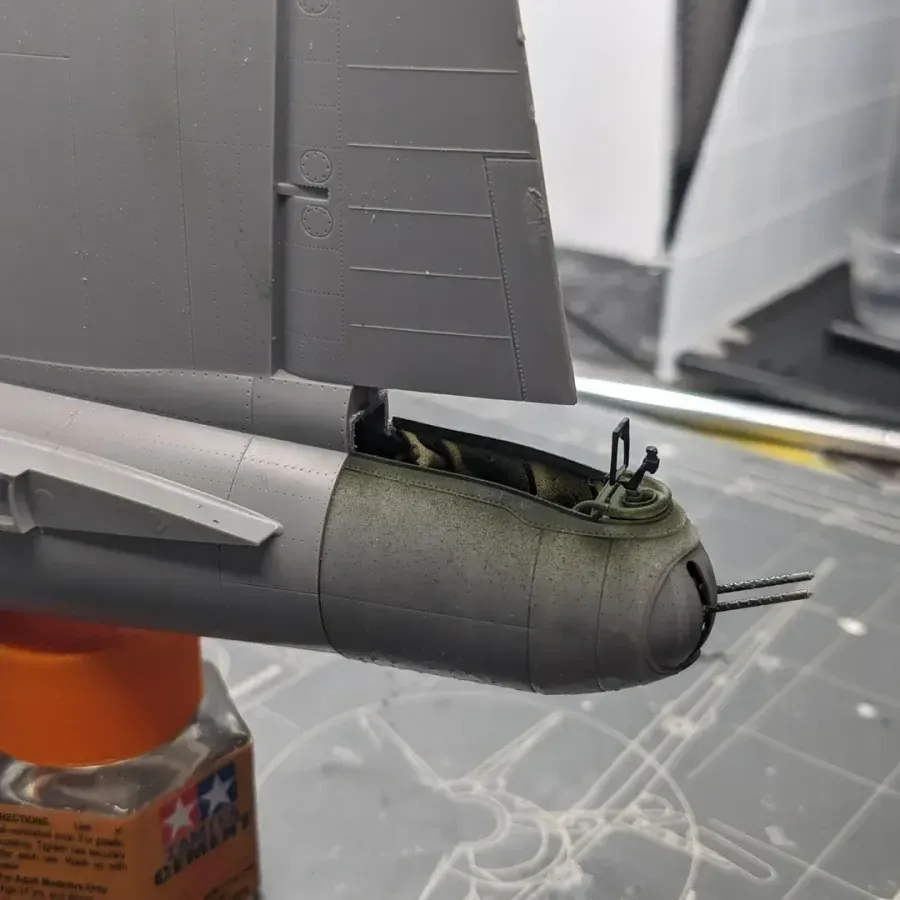

                • #68
                  I started in on making a scratchbuilt Cheyenne turret for my Heaven Can Wait B-17G. At this point it is pretty much flying by the seat of my pants, so to speak, using whatever drawings and photos I can find to make a reasonable facsimile. It's drying up for the night, and tomorow I'll get back to sanding priming, and painting the structure. I'm hoping to have it (the Cheyenne turret) all done next week sometime. Then, on to the cheek window mods in the nose.

                    Looking good! There's some references on this page for another builder that did a Cheyenne turret, as well as a bit of his build process on the previous pages: https://www.rcgroups.com/forums/show...7#post47493417.
                    • #70

                      Thanks, F106DD! He did a fantastic job on that! I have the framework set up for now, it's pretty solid. I'm going to make a semi-scale K3 gunsight that the later models had. I installed some armored glass that the real ones had. I have several 21st Century P-51 pilot figures that I used in my dear departed Freewing B-24 years ago. They've been collecting dust in a toolbox but a few of them will be called back to duty for this model.
                      I glued in the gunner yesterday, and this week will be putting the plastic panels to look as close to possible as I can to the real thing. I do like that he made a vacxuformed plastic piece of the whole glazing. That was well played.

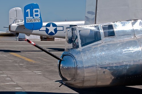

                      • #71
                        Don't know if these will help, but here they are. Click image for larger version

                        • #72

                          Yes they do, Dan. Thanks!
                          Question: do you think you could come up with an STL just for the domelike gun cover and the two slots that the guns go up and down to stick on the end of the tail? I think if I give you just a couple of dimensions, I can play with the STL to make it work. Let me know if this is doable, on your end.

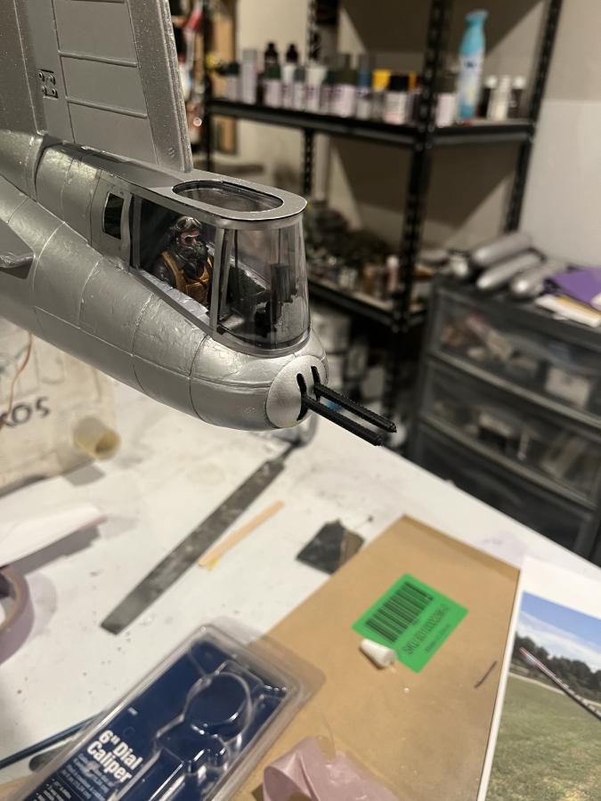

                              Thanks, Rex. I got all the window panels in for the Cheyenne Turret, but goobered up a bit with CA on two of the windows. I am going to replace them with some new ones and then things should be better.

                                Got some more work done on the Cheyenne turret yesterday. All the plexi panels are glued in now with canopy glue, still have some trimming and adding metal tape to seal in all the edges of that glass work. After that, I need to make a dome that fits in the tail that the two .50s will stick out of and then move on to the next stage of the model. One pic in "bandages" after I glued in the panels last night, and this morning when I removed them. A 3D print of this or vacuform of the glass would be the preferred way to go, but I think this will work for this model.
