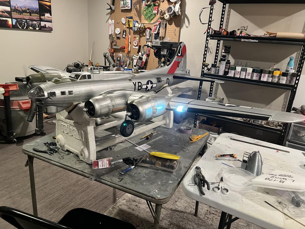

While I have your attention, I haven't given up on finding some Flightline B-17 main landing gear, but I have to brace myself that that will not happen. Instead, although I HATE to use the round springy gear, I might have to do something along those lines.
I could just leave everything stock on this, and live with the fact that the airplane's stance is way too high. Another idea I have is possibly modifying the landing gear steel strut by opening up the servo and cutting about 1/4 inch off the strut so that I can lower it in the retract a bit. I'd rather get rid of the strut completely, but that might not be possible. I would still have the functioinal circular spring, but it would be closer to the retract and make the model's stance a bit lower.
I looked online for HK and wanted to order a replacement main gear retract where I could test this theory out, without endangering working gear that are installed. I mean, if they don't sell retracts, I can't take the chance of screwing up the ones that work if I can't get replacements. Maybe I missed the part on their online parts finder where you can order replacement gear for this airplane.
Do you have any thoughts on this, or some other way I can go with a different strut from a different model that I could put in this retract as a more scale replacement?
Thanks for any thoughts on this.

For the landing gear, I still think your best bet is to buy those FMS FW-190 74 deg retracts that I linked earlier and try those with the stock struts to get the stance right. It should significantly lower the stance, assuming everything will fit. The Freewing B-17 retracts would still be most scale option, but its a shot in the dark to find them.
As for struts, that's going to trial and error. You'll still need that bend from the retract, but maybe you could retrofit on a strut on the end after the coil spring. You would need a really short strut though. Maybe the mains from the eflite 64mm A-10 or the new Xfly F-22 main struts. Those are the shortest ones I can think of.

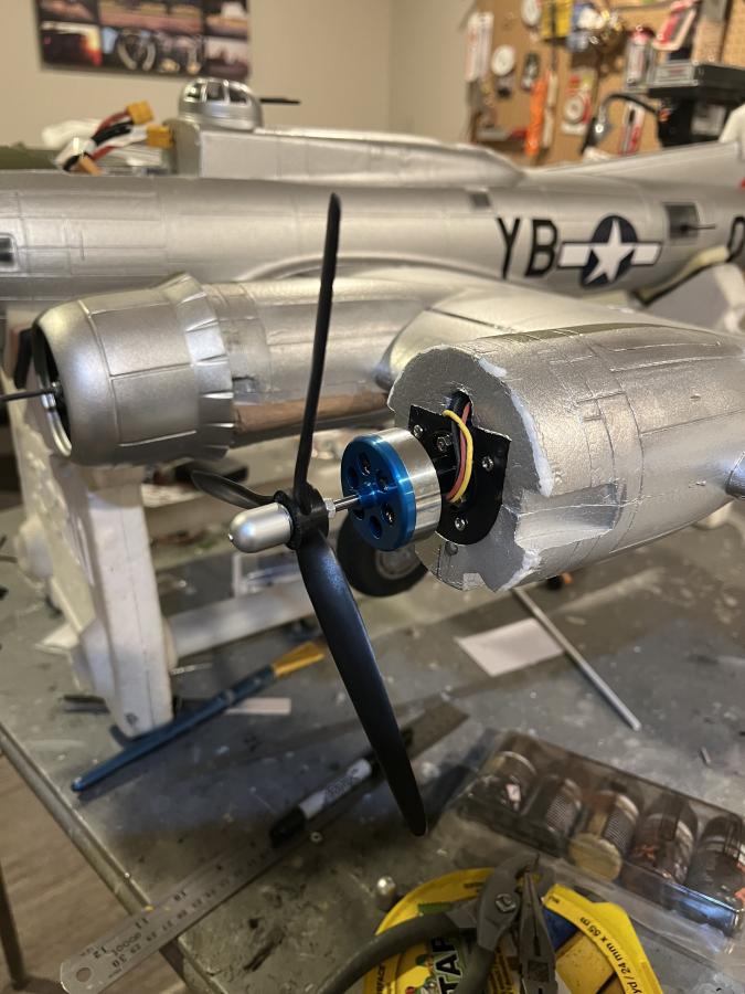

I took the HK B-17 out for some taxi tests, range tests, and some full power checks to be sure everything was running ok. Everything worked out fine except for the runups using the stock propellers. The first static runup went fine running it near full power for about 15 seconds when one of the propeller blades on the #4 motor departed the airplane and damaged the thin plastic cowl behind it. I did some more static tests indoors after replacing that propeller with some static runups of about 10-15 seconds. This time, when I powered down to a stop, one of the blades made a grinding noise. I discovered that the cheap plastic hub of the prop can come apart even though the propeller stayed on the motor. But that would have been a problem had I been doing a flight on it.
So, it looks to me like there are a couple of things at play: First, the quality of these props seems to be "garbage" to me, and are not trustworthy to put this plane in the air. I'm very disappointed in Hobby King for the difficult to follow website in finding replacement parts when needed. For instance, should I have to replace a common main gear retract servo and/or steel strut for the same, I did not find anywhere where important parts like those could be found to buy online.

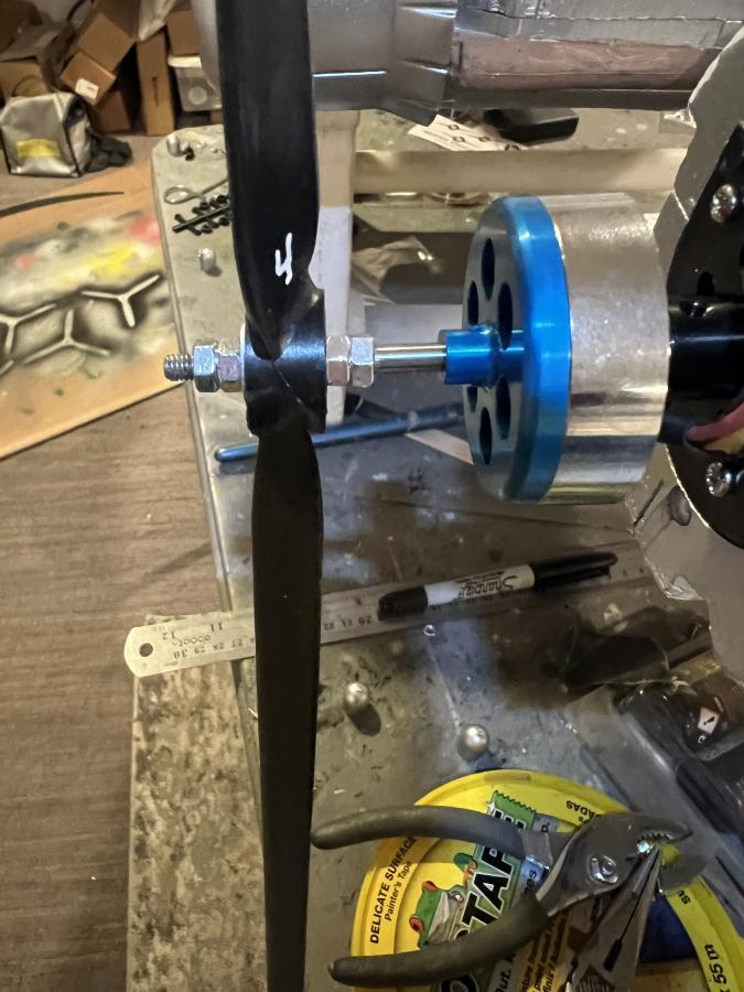

Second, I did buy several Master Airscrew 3-bladed 8x6 inch propellers that I could use in place of the stock props from HK. But I don't understand how to attach them to this airplane. They do have some plastic molded bearings that come with each prop, but I don't see how they would attach to these stock propeller shafts of the HK model.
Any ideas or comments would be much appreciated. Other than this problem, the rest of the airplane went together well, and taxiis well on the street and has good turning radius with the new retractable tail wheel that I installed.

More prop mounting pics from the RCG thread: https://www.rcgroups.com/forums/show...&postcount=334
- Likes 1
Thanks so much, F106DD. I was thinking that I would need to go to the hardware store and get some nuts and washers to make it work. I'll look into that. I'll start working on balancing the MAS prop, rounding the tips as you have, and making sure they are BALANCED!Originally posted by F106DeltaDart View PostDave, I had to check how my Master Airscrew props are mounted. I just used 2 nuts on either side (torqued against each other to prevent slipping) and some washers in addition to the stock adapters for the smallest diameter. Has worked fine for 10 years now.

I am working on the MAS propellers. Did round the prop blades and now have them in paint for the tips and I also repainted the props matte black after sanding on them a bit and removing the MAS decals painted on each blade. I painted the blade tips white, and then will paint them yellow to get a better look.Originally posted by davegee View Post
Thanks, Aros. I think I'll just remove the thought of those very flimsy, oversized props from HK, and finish up balancing and finishing rounding the tips to look more scale. They being much smaller than the stock props, they look stouter, too. I will probably ccontinue with static runups with the MAS props next week.
davegee
Did a runup with one of the blades on the number 1 engine. Difference with the MAS versus HK was like night and day! They are very strong amd I ran it up to full power a few times momentarily indoors and they were solid as a rock. I will still balance them tomorrow just to be sure, but I think these MAS props, besides being much more scale and a ton stronger, should do the trick.
I'll attach a couple pics of the test engine (#1) without the cowling that was damaged in the runup the other day when the HK prop came apart during a test runup.
- Likes 4
I got all the MAS blades painted, balanced, and installed on my plane today. They seem to run much better than the stock blades and I will stay with the MAS blades. They're also more scale so that is a good thing, too.
