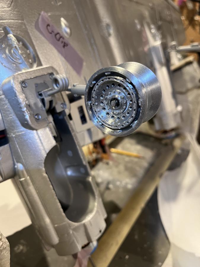

              I've been working on the main landing gear wheels today. F106DD gave me a link to get some free prints for landing gear wheels for this model. So, I downloaded those and have two sets of detailed 3D printed wheels for this B-17 model. I had to do some sanding to get them to fit on the axle properly. But I do have one completed for today, including the C Clip to keep it fastened. I'll get the other one done tomorrow.
              So, to complete the main wheels I have ordered a pair of Robart 3 1/4" diameter scale tires with the diamond tread today. They'll probably show up next week sometime.
              I also used a 3/16" OD aluminum tube that I cut to proper length to act as a bushing for a tight fit and smooth rotation of the wheels. The stock wheels (mounting hole) were a bit too large in diameter to fit on the axle tightly and they wobbled and moved a bit. So, I think this will be a better solution than stock, especially scale-wise over the OEM offering.
              Cheers

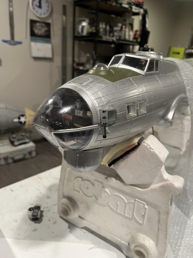

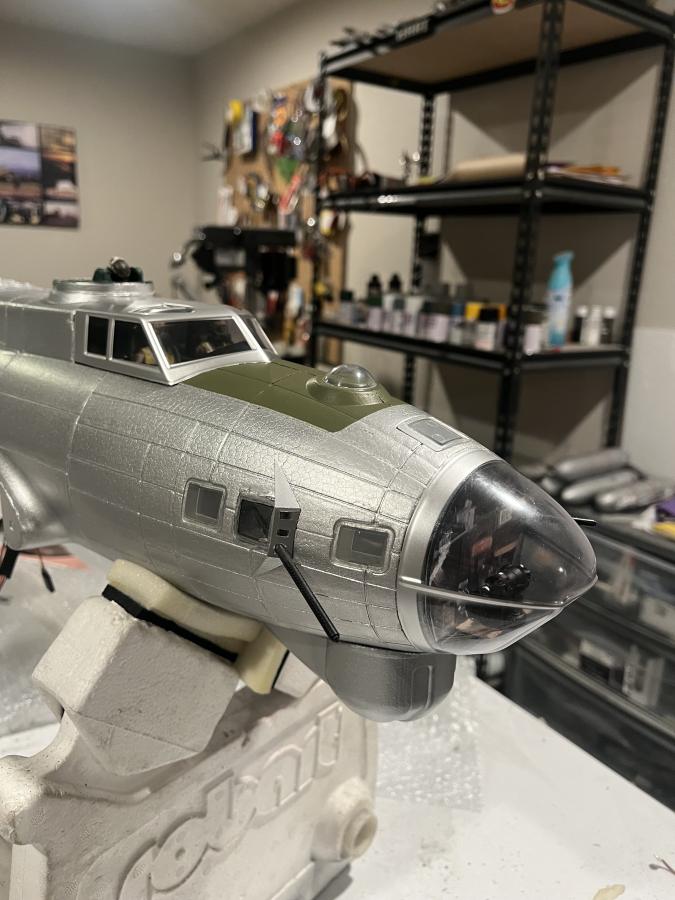

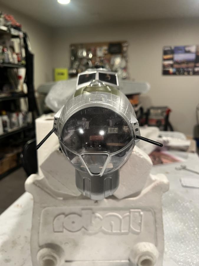

                                          I got some progress on the B-17 yesterday. Got both sides of the cheek windows/guns mods that were done on most airplanes, especially late F and all G models during WWII. It was part of the kit for the Cheyenne turret mod where they brought in airplanes to have the original "steeple chase" tail turrets replaced by a roomier and more effective gun in the tail.
                                          I have to thank F106DD for giving me ideas on how to put in the cheek gun/window mods. I played around with the stock windows that this would cover on each side, rotated them out some from flush a little bit, filled in any gaps with canopy glue, and then attached a fairing that I made in for the raised windows. I think they came out ok, especially for a foamie. Otherwise, work continues relatively smoothly.
                                          Click image for larger version  Name:	IMG_3289.jpg Views:	4 Size:	77.0 KB ID:	439829 Click image for larger version  Name:	IMG_3288.jpg Views:	5 Size:	54.9 KB ID:	439830 Click image for larger version  Name:	IMG_3287.jpg Views:	4 Size:	62.6 KB ID:	439831
