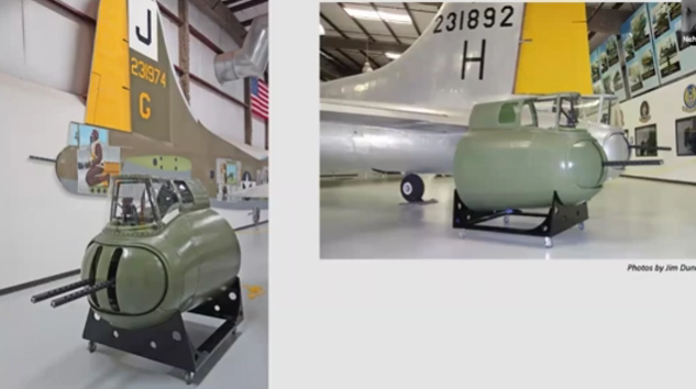

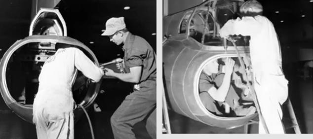

    Where I found a lot of info
      • 7359
      #82

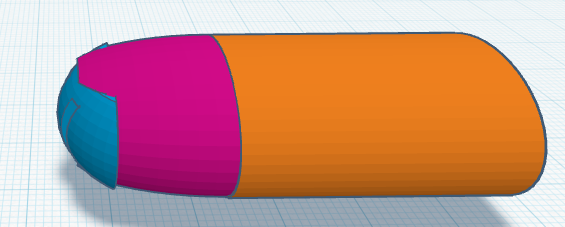

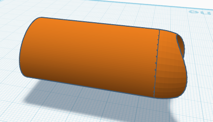

      based on what I can see, maybe something like this?

        • Nov 2013
        • 2736
        • Cody, WY
        #83

          yeah, that looks similar to when you look at the contour of the fuselage tail area.

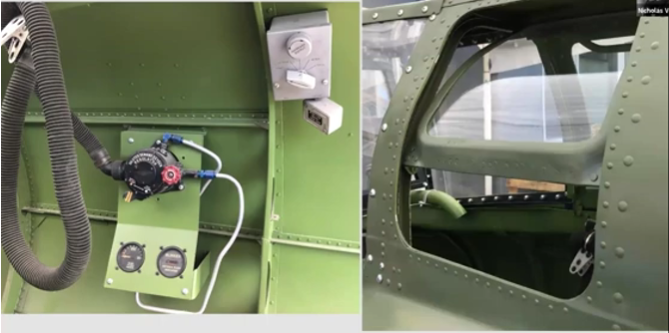

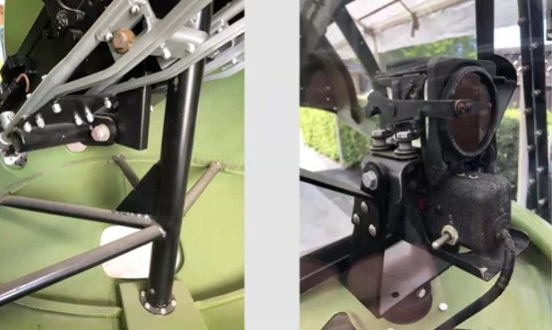

                  • 7359
                  #88

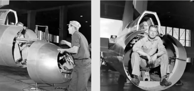

                  did you check out that video on a guy restoring a Cheyenne tail turret?
                  There is some info on the waist windows as well, pretty interesting vid.
                  (Dangerous Dan)

                    #89
                    (Dangerous Dan)
                    Hi Dan: I didn't see the video but if you could point me to it that would be great. Just to be clear, you mentioned "waist windows" and I want to be sure we are talking about the same thing. The "waist windows" as I see them are in the middle of the fuselage where the waist gunners were located. This model really has the waist windows in that area done pretty well as a later model G. I don't really have to do anything to them other than stick a machine gun barrel out both windows. and add a waist gunner (at that point of the war waist gunners were reduced to one versus two gunners so I'll put one gunner figure in that area.)
                    The "cheek guns" that I am referring to just to be sure we're both on the same page are the ones in the nose, just behind the clear plastic nose cone. These were additions to improve fire power by adding a convenient .50 cal machine gun into each of these windows so that the bombardier and navigator could use them when their normal duties would permit them to do so. I'm hoping to get some general dimensions of these panels that were added onto all later models of B-17s. I can sorta figure it out, too, if I have nothing better to go from, using pictures of real airplanes.
                    Cheers
                    Davegee

                      Was playing around with the tail some more tonight, I like the challenge.
                      Click image for larger version  Name:	Screenshot 2025-11-05 184155.png Views:	0 Size:	93.3 KB ID:	439299
                      Obviously needs some tweaking, but it's way out of scale as well. Picture that being maybe 3 inches long and a lot of the imperfections disappear.

                        Hi Dan: when I started putting a trial Cheyenne turret change to this model, following the slope of the fuse to put the window glazing on, it comes out a bit too tall. I’m thinking to get it more accurate, I really need to remove that area and replace it with a printed more cylindrical tail as you have drawn. Can you hollow out a groove in the top where the crewman would go?
                        I f you come up with a prototype we can use for a first whack at this, we might be able to come up with a better and more scale looking turret. Once we have an STL, I can print it and see where we need to make changes from there.
                        What are your thoughts?

                                What's interesting is that they take a stock 'steeplechase' tail and go through the steps of converting it into the Cheyenne version in the video as well as the fellow gathering and restoring a Cheyenne tail turret. The video is really worth watching. Consider the conversion just a full scale model.
                                Check it out

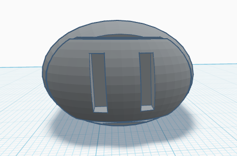

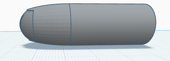

Name:	Screenshot 2025-11-06 145600.png
ID:	439334 Tweaking...

                                    Sounds good, Dan. The shape just makes sense to me when you're trying to do a Cheyenne turret. It had a lot of benefits for the gunner, not the least was a little more comfort!
                                    What do you think about cutting out a channel for the gunner? I would definitely like to use this mod if we can get all the dimensions to fit ok. Let me know any dimensions you need. I wold like to get together sometime soon with the fuselage and the V1 prototype I cobbled together and go from there to see what your thoughts are going forward.

                                      Danger, Dial up the resolution of the spheres: located in the 'drop down' for the part. You're getting there. Best, LB
                                    • 7359
                                    #98
                                    Yeah, silly me Elbee, I should have done that in the first place, but as I haven't used Tinker Cad in a while. It looks as though there have been some upgrades as well. This is a preliminary whack at the cat. Interesting when you see just how the conversion on the real thing was done, it's not as though they chopped the whole tail off, for instance the small window under the tail is still the stock window, they cut the original section off just aft of that. Click image for larger version

                                        Good-lookin' design as well.
                                        The 1/2 sphere is clunky, i.e., it can't be sharpened up easily.
                                        You can bring in several of the the 1/2 spheres and rotate each on top of the other to add more sections and then combine all those into one.
                                        This adds a lot of complexity to the design and high pixel count, however.
                                        Or you can use the Hi-Res Sphere and slice it in half if you need a smoother 1/2 sphere.
