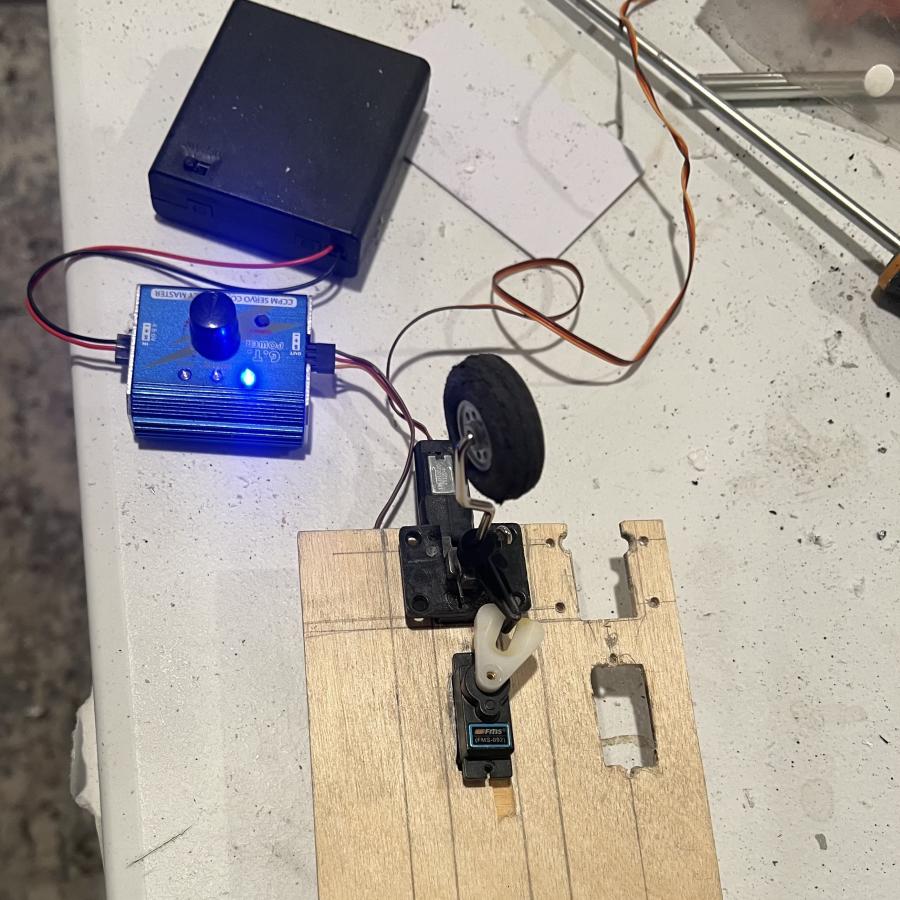

                                        I've been busy working in a retractable, steerable tail wheel assembly for my HK B-17G. It is now installed in the aircraft, and works fine with my servo tester. I think I'll attach the retract lead to the main gear retracts so that they all operate together up and down, and the steering servo I'll attach to a separate channel that I can use my rotary knob on my Spektrum DX18 transmitter to center the tailwheel or use it for some steering, too, if I want to. There is a sizable hole I had to cut out of the bottom of the fuse to get this installed, so I'll make a thin plastic cover with a scale looking cutout for the tail wheel to go up and down. It will be removable in case I need to service the tailwheel down the line.
                                        Attached is a pic of the tailwheel assembly in testing before cutting out from the plywood sheet and mounting it in the airplane. Other major plans are to install a scratcbuilt "Cheyenne" tail turret and updated "cheek" windows in the nose that were installed to give more firepower to the navigator and bombardier when duties permitted. Still not sure how I'll do those, but I have some ideas...
                                        Cheers
                                        davegee
