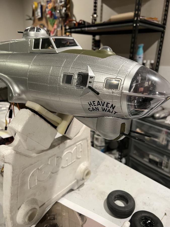

      I got some progress on the B-17 yesterday. Got both sides of the cheek windows/guns mods that were done on most airplanes, especially late F and all G models during WWII. It was part of the kit for the Cheyenne turret mod where they brought in airplanes to have the original "steeple chase" tail turrets replaced by a roomier and more effective gun in the tail.
      I have to thank F106DD for giving me ideas on how to put in the cheek gun/window mods. I played around with the stock windows that this would cover on each side, rotated them out some from flush a little bit, filled in any gaps with canopy glue, and then attached a fairing that I made in for the raised windows. I think they came out ok, especially for a foamie. Otherwise, work continues relatively smoothly.
      Looks good Dave. On mine, to make the bigger cheek windows, I used clear pieces of plastic from packaging and bent it by hand to the shapes I needed and glued them in place. You can sort of see that in the photos of my setup. Still took my share of cutting and filling, but it might be a reasonable option.

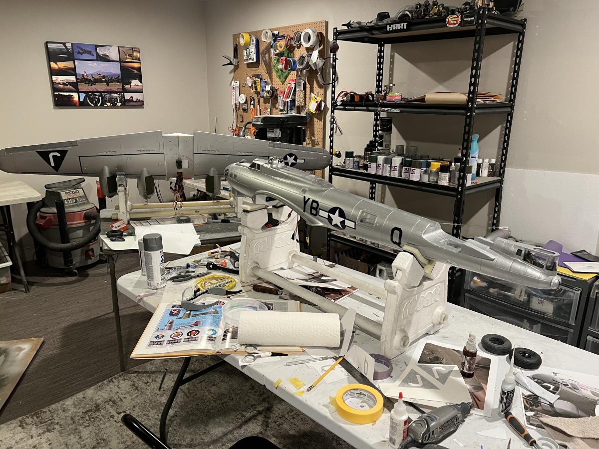

            • Work continues on my Heaven Can Wait B-17G. I got the graphics from Callie a few days ago, and am applying them today. Right now I am painting the diagonal red stripe across the vertical fin and rudder. I hope to get that finished painting later today.
              Danger Dan and I are working on an experiment to see if it is possible to fly a detailed but very light replacement for the molded kit fuselage tail cone. I found another fuselage on HK that was on sale, so I got it the other day and carefully removed the tail cone. My biggest concern right now is the weight, at the end of the moment arm of this long airplane. I have no idea if we'll be successful with this or not, but if it ends up too heavy, I do have the scratchbuilt one that is sufficient, for now. Should this idea work and we get the look and weight where we can work with it, I'll probably remove the tail cone of my present airplane and glue our printed Cheyenne turret onto that model.
              I think it is worth the try, a lot of good experience can be gained for both Dan and me as we proceed.
              I'll attach a pic of the fuse and the wing currently in-work in my rather messy shop!
              Cheers
              davegee

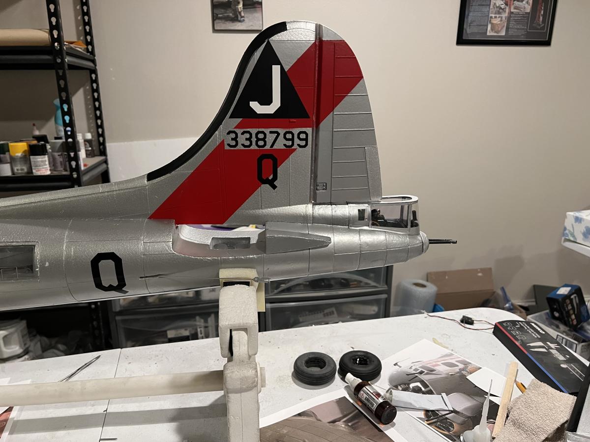

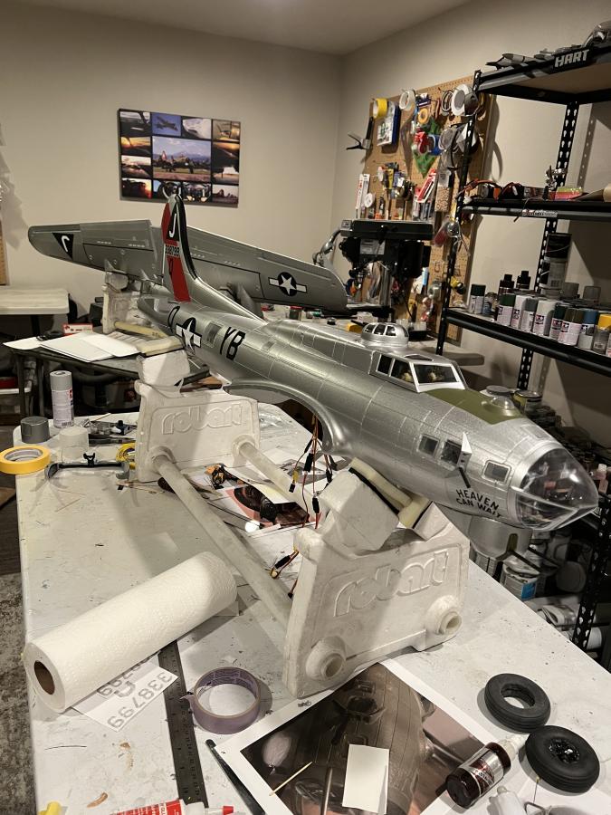

                    • Contiuning on with the build/asembly of Heaven Can Wait, I got the vertical fin/rudder painted just now, and added Callie's decals which she did her usual superlative job.
                      I won't glue in the horizontal stabilizer and vertical tail until we are sure that our plan for a lightweight Cheyenne turret is a certainty. If it doesn't work out, I'll just use what I have already made for a turret and fly it that way.
                      I'm waiting for a new spindle sander to sand down the inner hubs of the rubber tires that I have ordered. I'm hoping the Robart 3.5" diamond tread tires will work, and I will probably have to sand the printed wheel halves so they don't stick out too far on the sides of the tires. I'm hoping I'll get them completed this weekend or early next week.
                      Here's some pics of the latest updates.

                      • Your work is very impressive. If your wheels are wider after you thin the tires you might just sand the inside flanges on a flat table and not affect the scale outside, if it comes apart like the Robarts do.
                        Best Regards, Rex
                        • Thanks, Rex. I believe this will work. I have been sanding a lot on the inside edges of printed wheels. I have ordered a pair of Robart 3.5 inch diamond tread tires and I’m hoping they will be a little “fatter” than what I’ve tried so far. I should be able to work these parts to fit on the axles of the stock gear of the B-17.
                          I’ll report my results after the Robart tires when they arrive in the next few days.
                          cheers
                          Dave
                          • The red on the tail really makes it pop. As always ur doing an awesome job Dave. Times have changed.. nevertheless,, lest we forget.the past men and women
                            You yourself do an incredible job of that. Kudos to U.
                            • Thanks, Craig. I grew up with the Greatest Generation as parents, friends, and mentors. My father in law who passed away last March at 102, lived a quiet life of honor, dignity, and service to our Country (USA). Going through what he and all the rest endured was absolutely terrifying yet they gave it all they had, and 26,000 in the 8th Air Force alone gave the last full measure of devotion, as they say.
                              I’m honored to carry on their stories through even rc planes like what my father in law and dad flew in combat over 80 years ago.
                              For some reason, I never built an r/c model of a B-17 before, but I’m glad to be doing this now.
                              I agree, after I painted that iconic red stripe on the tail today, it really made it “pop.”
                              Cheers
                              Dave

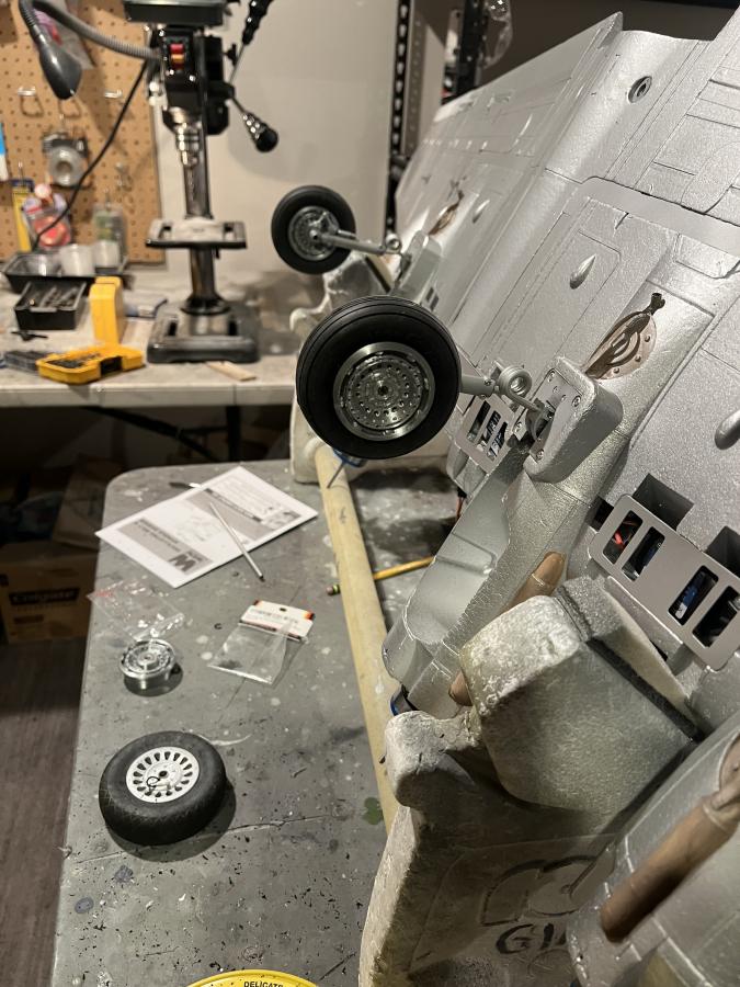

                                  • I spent several hours today printing scale wheels for the main gear of the B-17, and then attaching them to the tires. I used two different sizes of tires in this experiment: two main wheels that fit the Robart 3.25" tire, and two main wheels that fit the 3.5" diameter Robart diamond pattern tires. I'll probably use the larger pair as my primary wheels, but will have the 3.25 inch wheels ready as a standby. The 3.5" wheels are very slightly oversized, but they seem to fit the plane's gear better. Both sizes easily clear the wheel wells up and down.
                                    I will let everything dry overnight with clamps holding everything in place until they are solidly dry. I might do some very preliminary taxi tests later after Thanksgiving Day festivities to see how they do. Still a long way off from thoughts of a maiden flight, but we'll see.
                                    Here's a pic of work being done putting the new wheels and tires on the mains. The wheel sitting on the table is one borrowed from my Flightline B-25J for testing. There are a few details to add onto my new wheels, namely a tire pressure fitting and hose like is shown on the B-25 wheel.
                                    Cheers
                                    Davegee
                                    Click image for larger version  Name:	IMG_3298.jpg Views:	0 Size:	104.9 KB ID:	440144

                                        Thanks, F106DD. I'm glad you enjoyed it. Just a total chance meeting 30 years or more ago, but glad I got to meet him. He just recently passed away in his mid '90s. A a life well lived!
                                        Also, thanks for the tip on the ADF antenna. I have already printed it up and will work on smoothing it out and painting it. Due to its being repositioned on the G models with the chin turret to just in front of the bomb bay doors, I'll have to attach it with a magnet after the wing is attached. No big deal to do that, but I can see it would be vulnerable getting the wings on and off if I didn't!.
                                        Cheers
                                        Dave

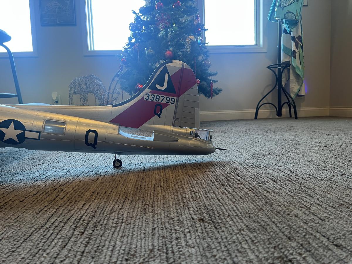

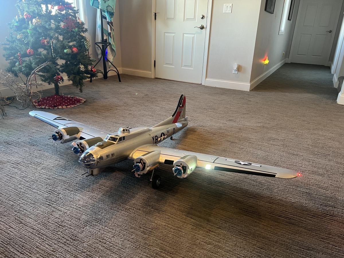

                                          Took a couple of pics with the plane on its gear for the first time. Did all the gear retraction and extension tests, control surfaces, motors, etc. The tail feathers are not attached yet due to ongoing work developing the Cheyenne turret. If that works out, I'll install it and then glue the tail dodads on. If it doesn't, I have at least a passable Cheyenne turret that should work for the time being. Tail/ground clearance should be fine with the tail gear I lowered the mounting in the fuselage for a bit more ground clearance. I don't expect to smash on the tailwheel on landings (hopefully!)
                                          Cheers
                                          Click image for larger version  Name:	IMG_3302 (1).jpg Views:	0 Size:	261.0 KB ID:	440181 Click image for larger version  Name:	IMG_3304 (1).jpg Views:	0 Size:	190.4 KB ID:	440182
